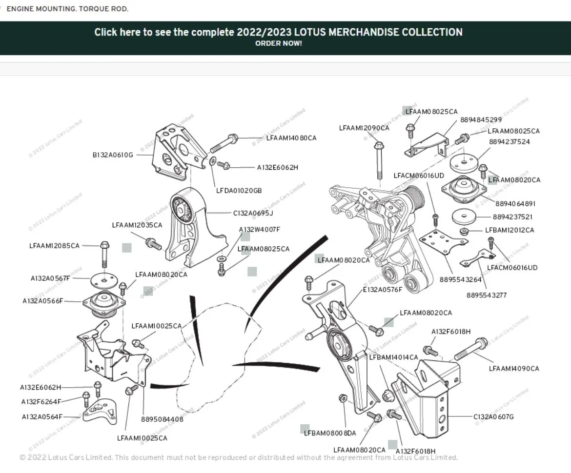

One area I would like to improve is firming up the engine/gearbox mounts to reduce the engine movement on braking, acceleration and cornering. It should also make the gearchange feel much more connected and direct,
I have in the past used Powerflex inserts on my Exige S2 and my GR Yaris, but they are not yet offering a solution for Emira. Has anyone any recommendations for either replacement mounts or inserts for the Emira?

Not sure if the OEM mounts are a Toyota part or a bespoke Lotus item. Also are they the same as Evora?

These are certainly cheap, but how easy are they to install? A little difficult to tell with the manual as anything related to this is tied to removing the transmission. Wondering what access is like from the bottom of the car.
Shouldn't be too bad. Same process as any other engine bay access. The hardest part will likely be supporting the engine/trans assembly while the mount is disconnected.
I found this article for the Evora. Make sure you read to the end as there is no need to remove transmission.
