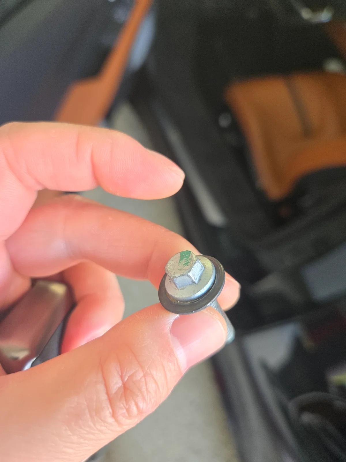

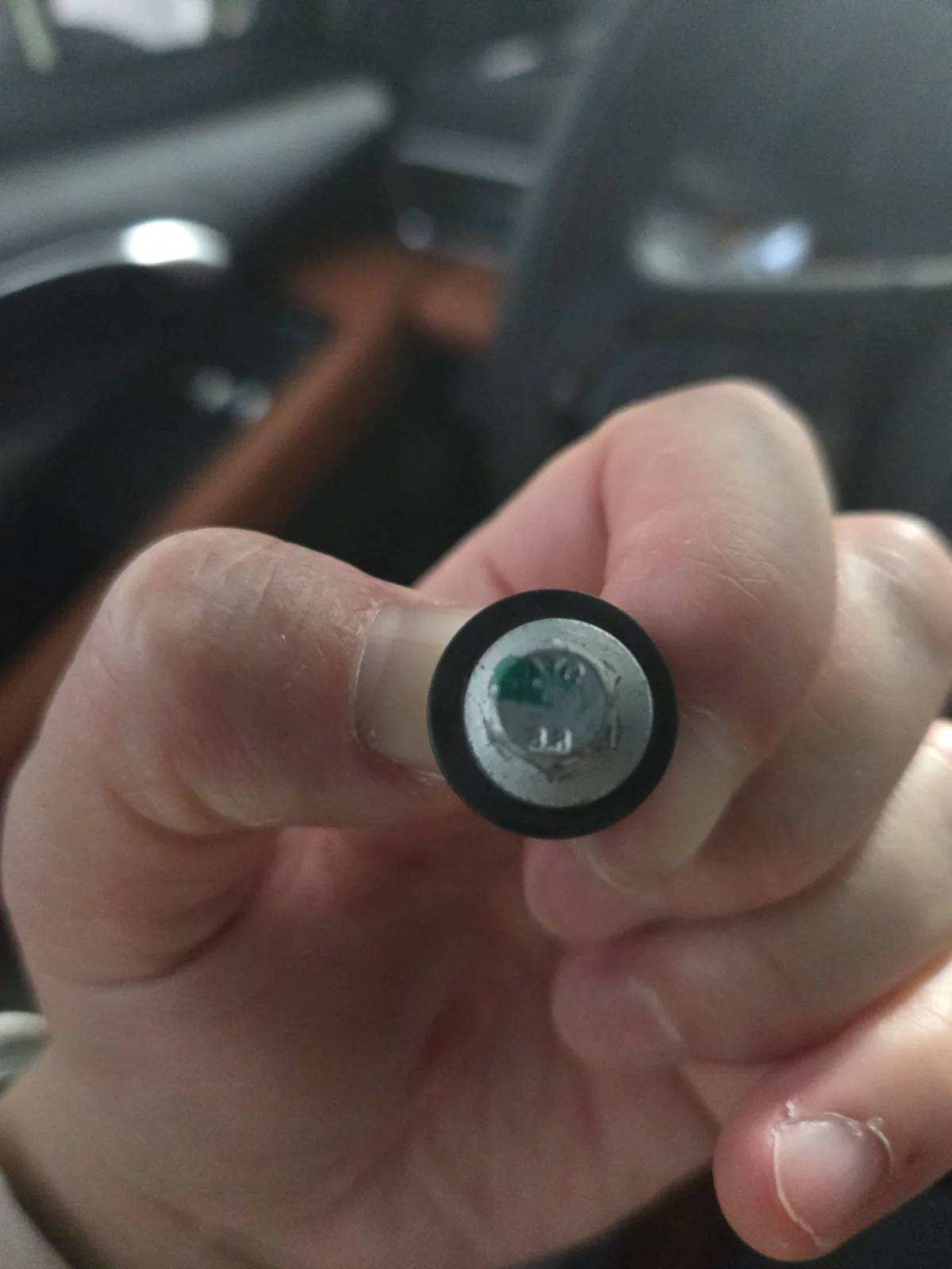

Just had oil change recently and also passenger side taillight assembly replaced under warranty at dealership. Being a few days and just found this (photos attached) hex screw that was left behind on passenger seat floor. It has the letters ATC (I think) and 8.8 (grade i think), and measured it to be either M5 or M6 (think its m5 but too close to tell exact) and 25mm long.
Anybody with service manual know where this belong too? Hoping it's not a critical screw for mechanical systems but panels/bumper. Certainly doesn't make me feel at ease knowing something wasn't put back....🤦‍♂️

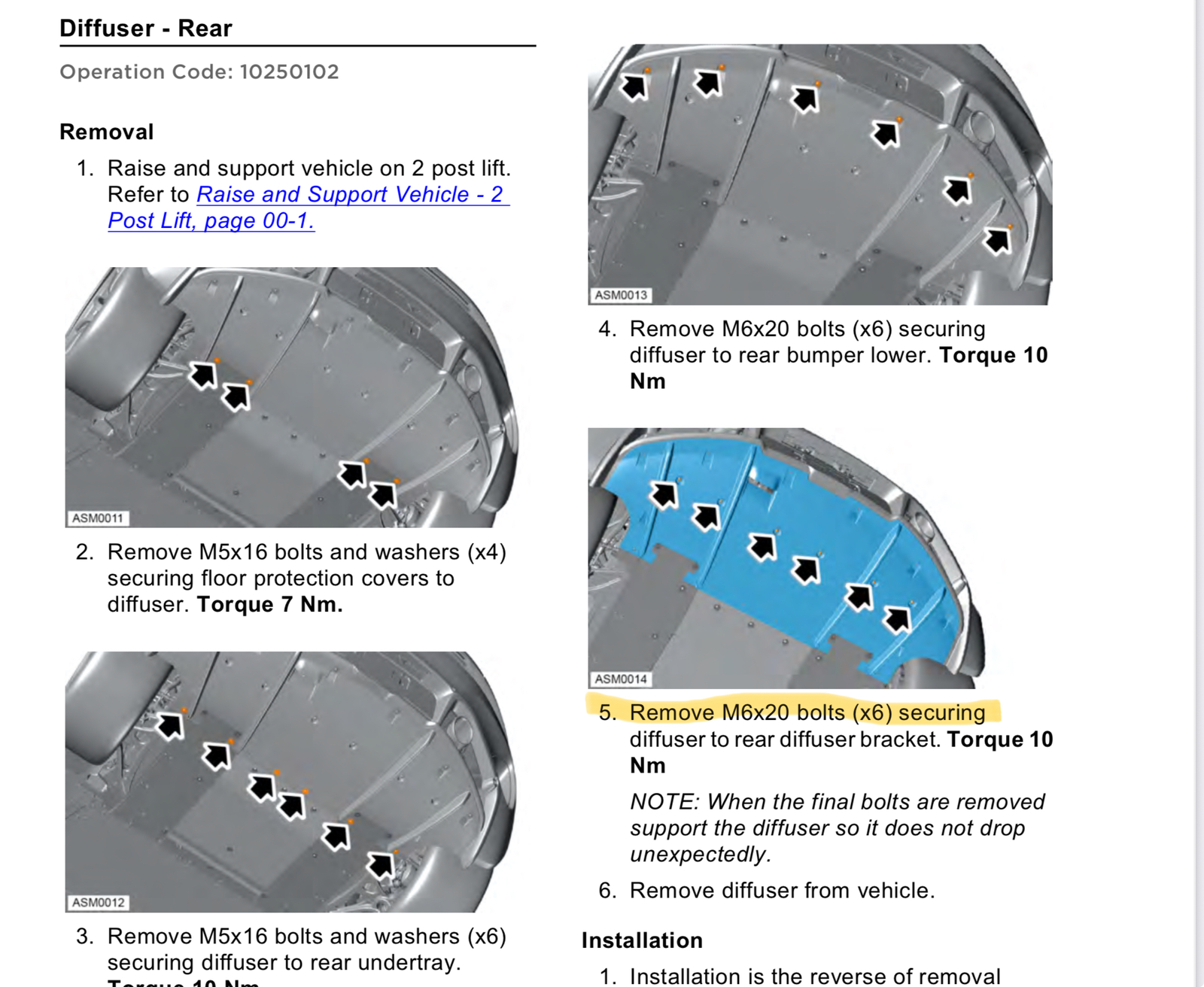

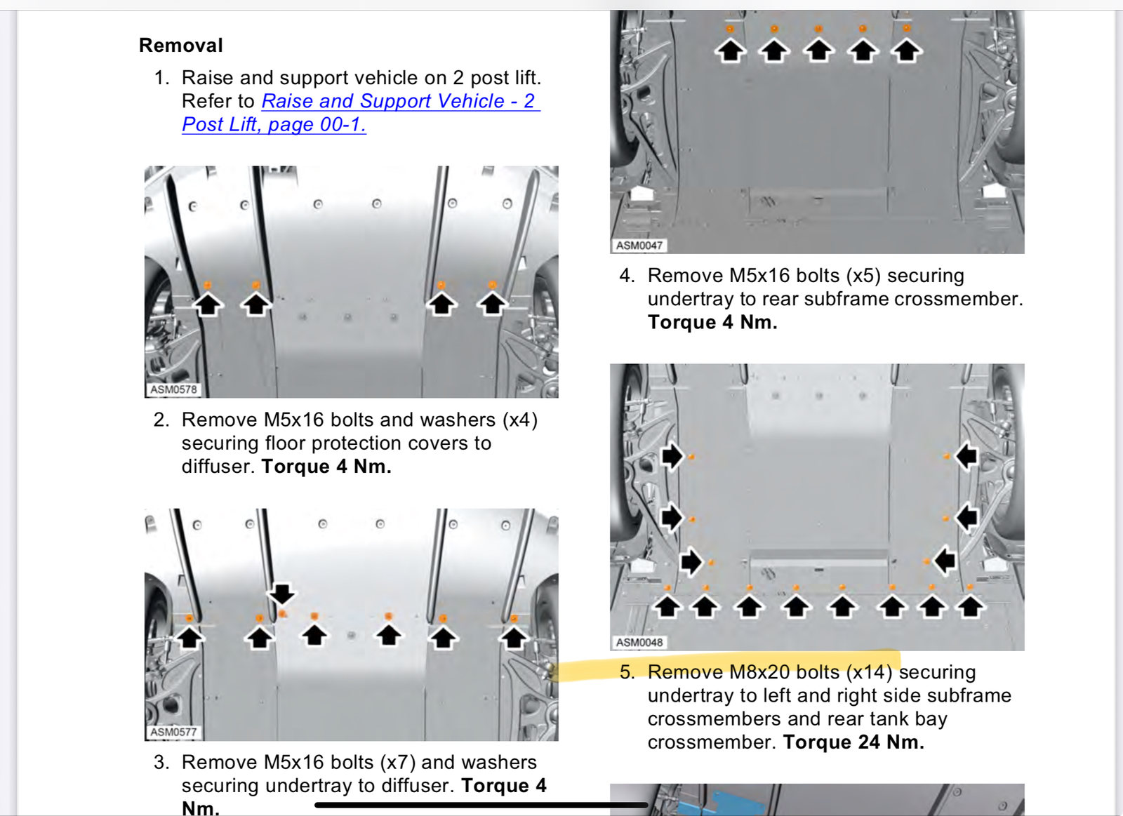

If it takes a 7mm hex socket it looks like a diffuser screw that is common to the underbelly pan (that remove for oil change). I believe those are m5x0.8x (25/20). Those are towards the back of the belly pan and front of the diffuser. You should be able to see if you're missing any of those. by just laying on the ground and maybe using a mirror.
Went in for another quick service and got this resolved as a “undertray liner” bolt they forgot to put back. Thanks all!
