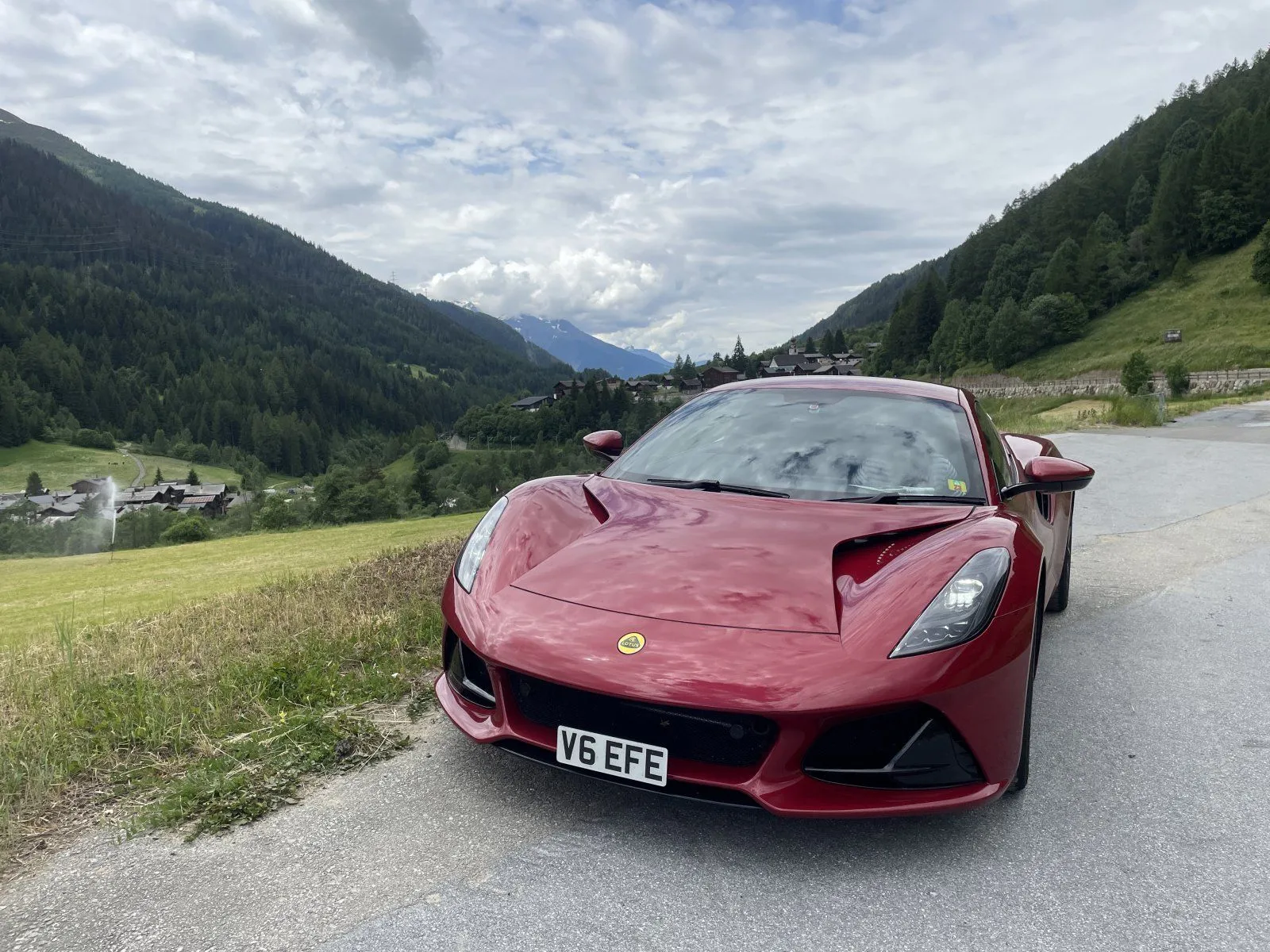

I have been using Phil at "create my plates"
His range of sizes is larger than most and a quick turn around.
The only issue I had was a small bur on the front edge of the plate left by the waterjet cutting. I removed it but I would have gladly paid a bit extra to have it hand finished prior to shipment.
Size ordered 400mm x 95mm

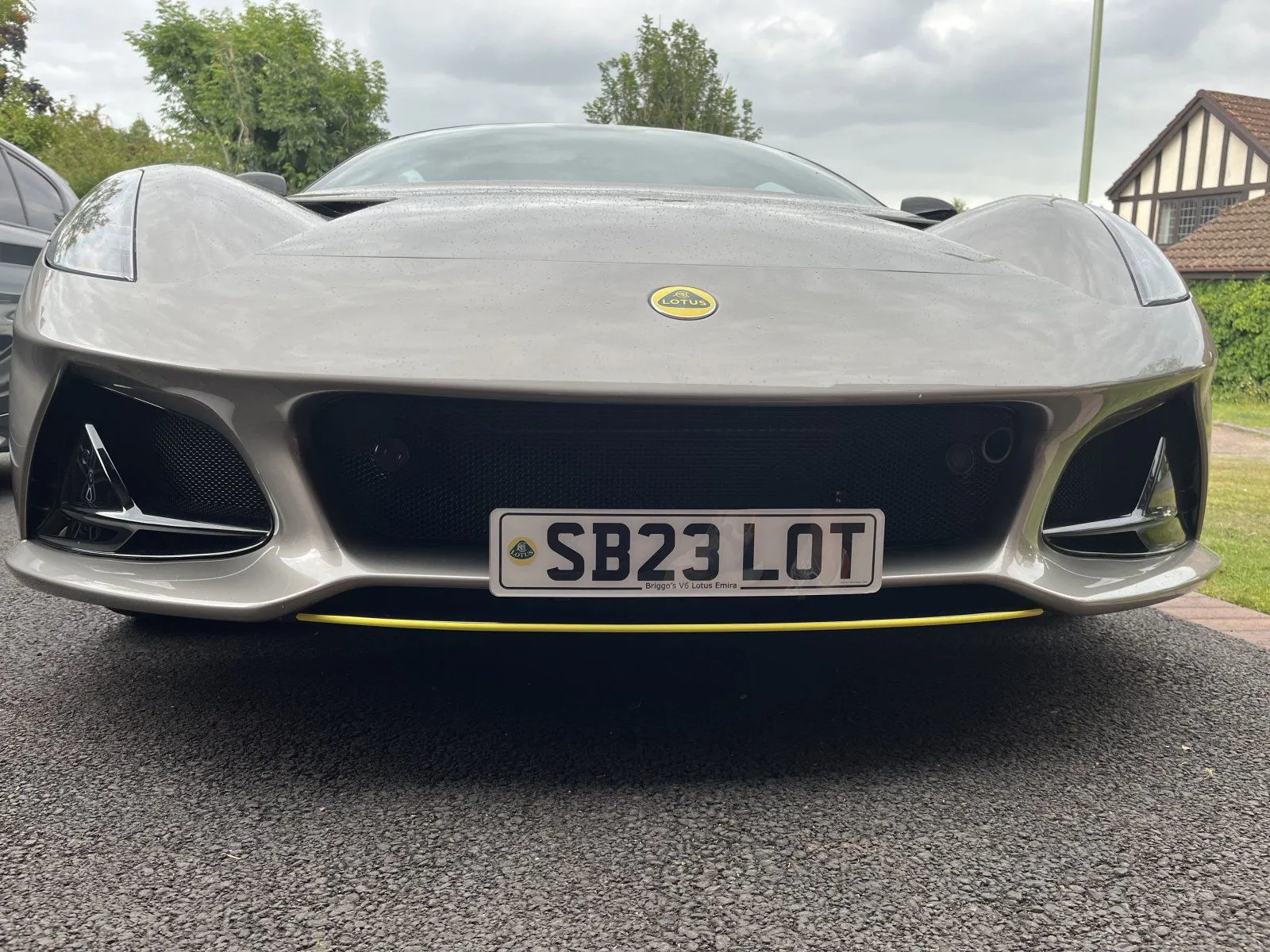

Hi believe it or not I got my set on Amazon, the company listing short plates was called official plates uk and they arrived super fast as normal. For reference, I got a genuine short front plate holder from B&C which I believe is used on cars that go to New Zealand. The short front plate looks very good 👍🏻

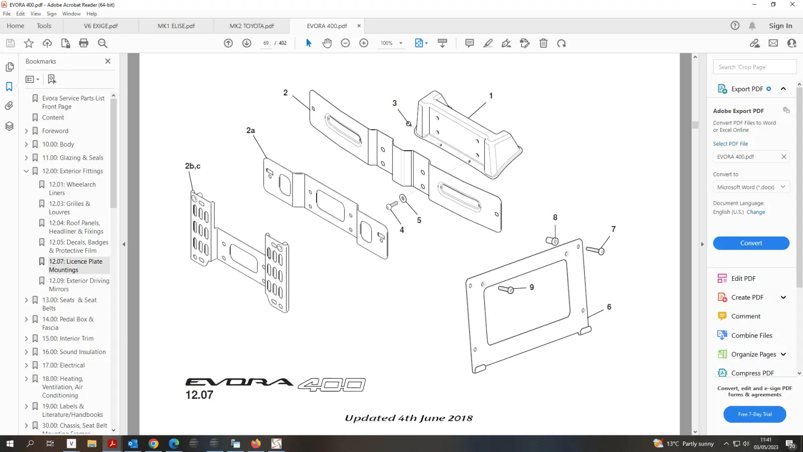

Would you mind disclosing the part number (if you have it) and how much it cost, I think I may need one
The front number plate support is the same as the Evora as per parts diagram above. I ordered the 2a option from Paul at Christopher Neil (Oakmere) it was a straight swap with the supplied part from Lotus.

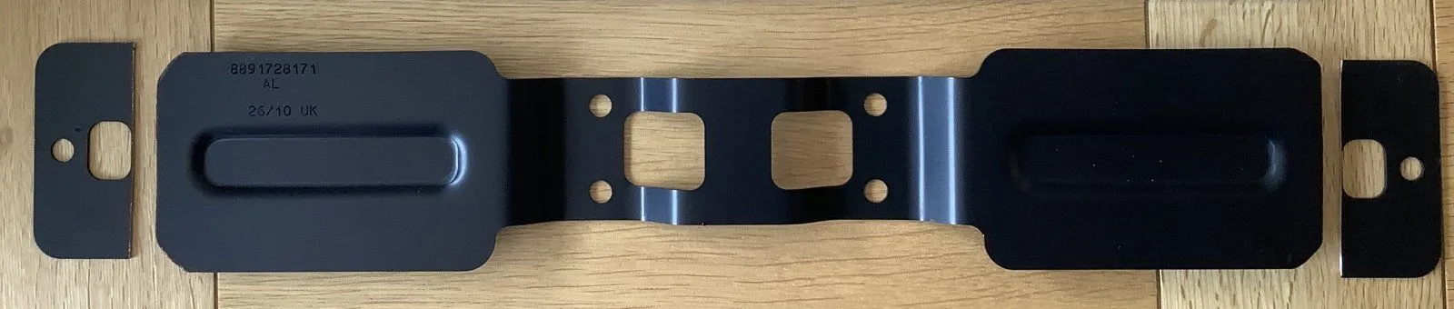

Here is the standard Emira UK front plate bracket reduced in length to take a shorter 4-Dot (6 character) plate. Couldn't get the Australian or NZ version via my UK dealer so ordered the standard UK version (£30) and Dremel/Draper'd it to the right size. It's aluminium so easy to cut and trim.

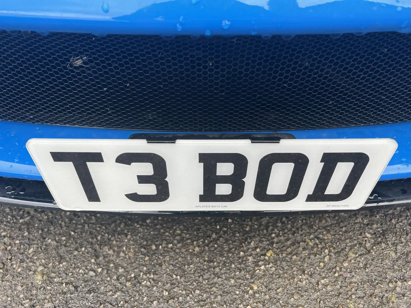

just fitted my short plate with some clips i found on Amazon , took the long plate off and fitted these straight onto the remaining fixing holes, just needed a spacer ( found a plastic washer about 5mm thick that worked) the number plate just clips into the two brackets.
PLEXICLICK® ORIGINAL Number Plate Holder for Cars - Frameless Invisible - Black - Universal License Plate Holder - For UK 3mm Frames https://amzn.eu/d/fytEIfl
was a bit worried as it only a rubbish review, but it seems to work really well.

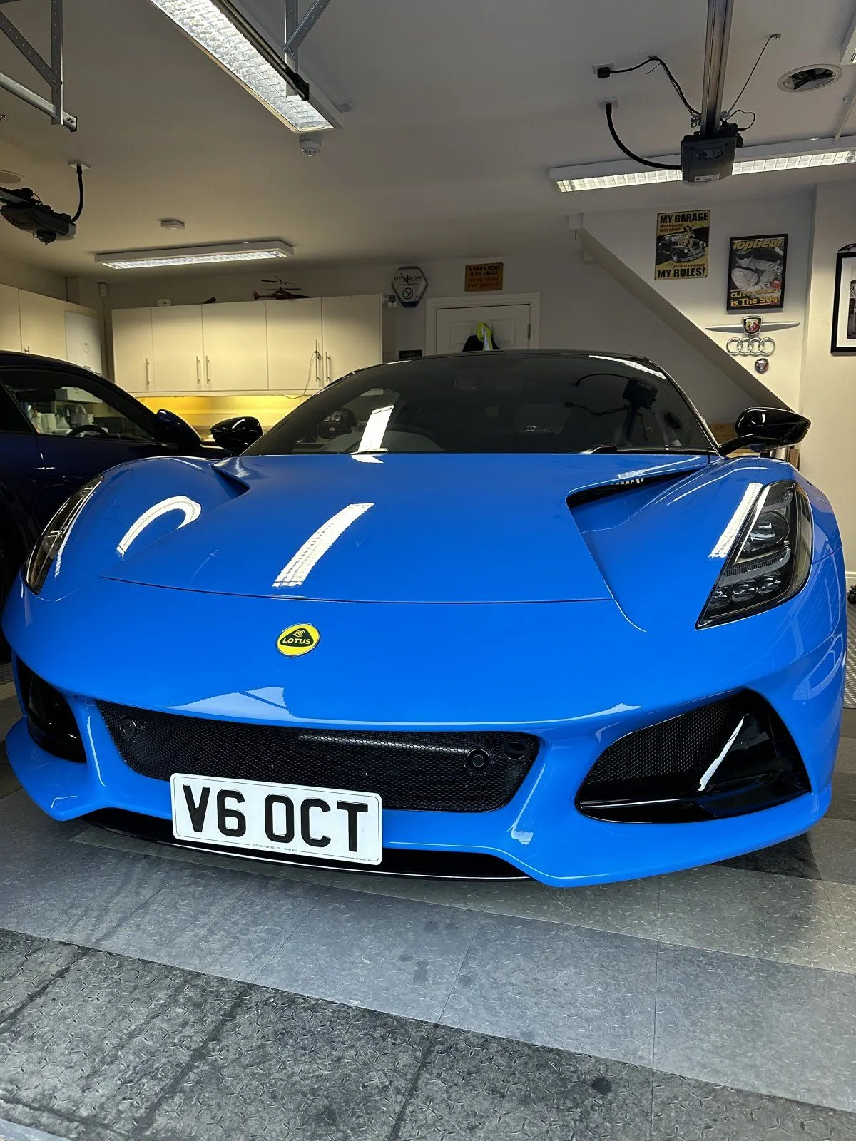

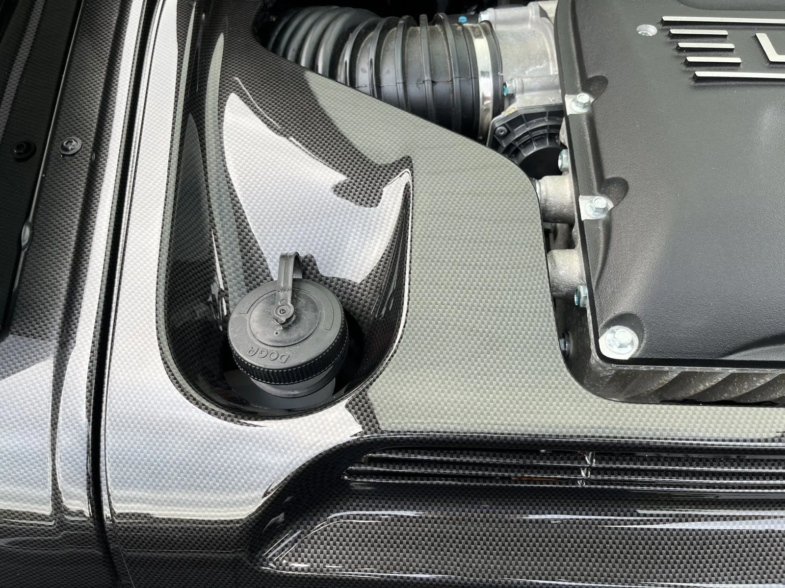

I have added a smaller front plate (16” x 3.5”) purchased from Plates For Cars (PFC). I trimmed the back plate to accommodate. Looks much better!

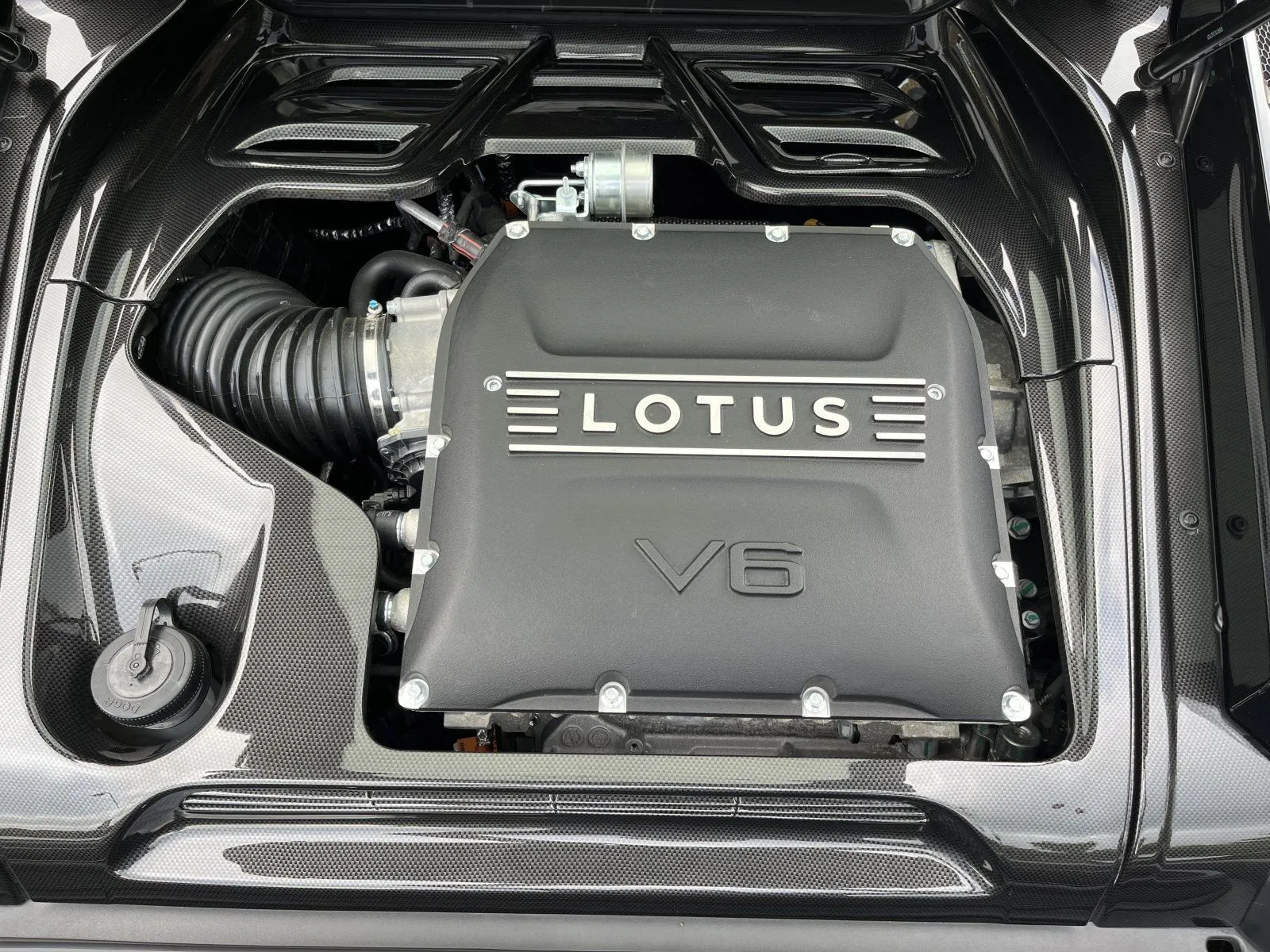

Also had the engine surround carbon dipped - very pleased with the result!
Also had the engine surround carbon dipped - very please with the result!
The engine surround looks awesome! Where did you get it done and how much if you don't mind me asking? I'm also based in Sussex and fancy getting the same done.
I had it done at Paul's Customs in Matfield, Kent TN19 7LQ. Paul Woolway launched Kent Custom Dipping in 2013 but has recently started up on his own. Recommended by Wombat at Matfield who did my PPF. Cost £360 and took 2 weeks. Quite a detailed process - plastic trim is sand blasted, 3 coats of primer, 3 coats of base colour, then hydrographic film applied in warm water tank, and finally clear coat applied and buffed to high shine and finished with polish and a protective wax coating.
