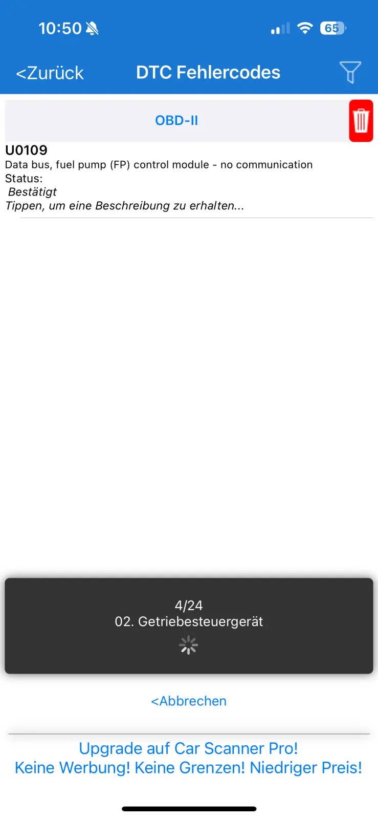

Anyone hit U0109 yet? Persistent over multiple starts.
Additionally I got a weird noise from the front I've yet to investigate. Reallly hope there isn’t a correlation..
Car runs fine without any fuel cuts or similar for now. Gonna go with the obligatory battery reset first.
