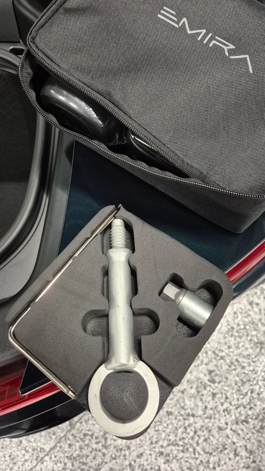

Picture of the torx tool in the kit.

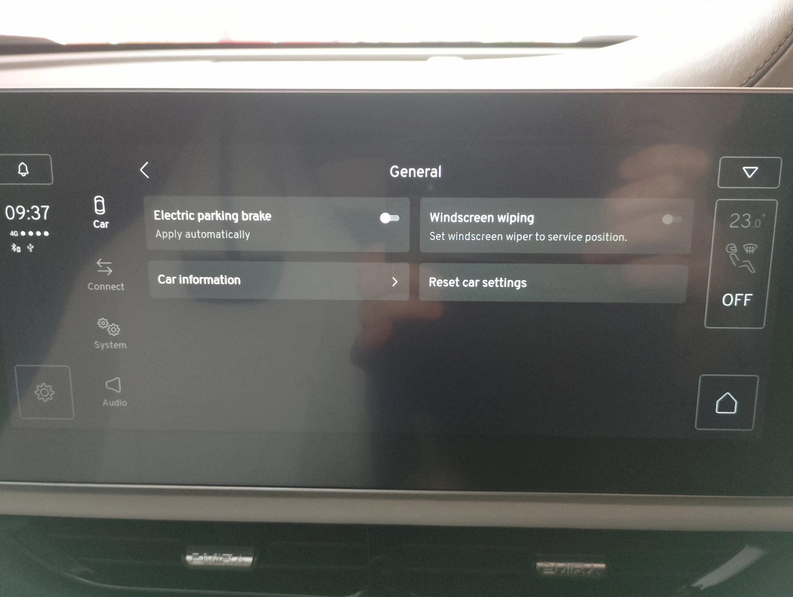

Tip: It's easier to undo the UK drivers side screw if you put the wipers in the Service Position. This puts the wipers vertical.
