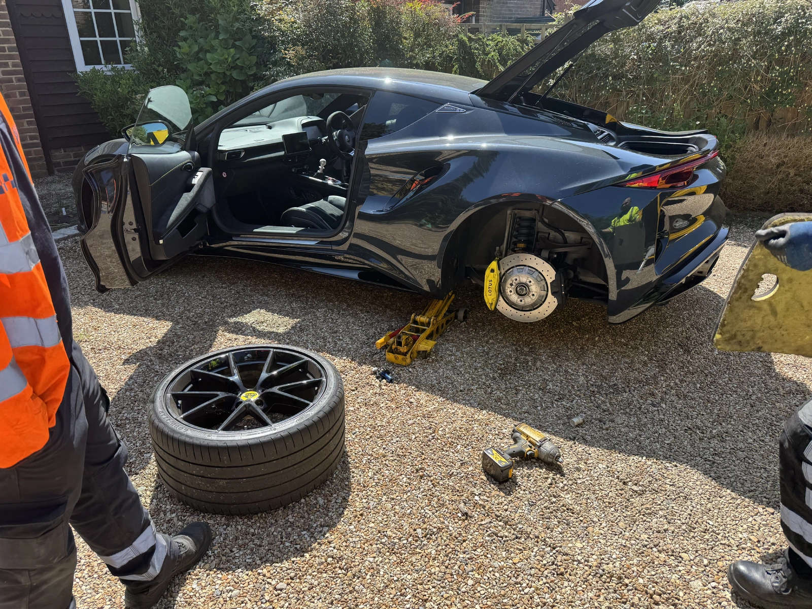

I’ve been trying for about 36 hours now. I must have tried every possible combination of sequences going with key, seatbelt, infotainment, you name it.. at least 100 different attempts now. Charging the battery over night as a final chance before getting towed tomorrow. I’m just “lucky” it’s on my drive

Not having a manual handbrake release is a real pain in the backside when you can’t start the car. Requires having the back wheels off and hot wiring the motors to release. If I ever see my car again I’ll be turning off the auto park brake.
