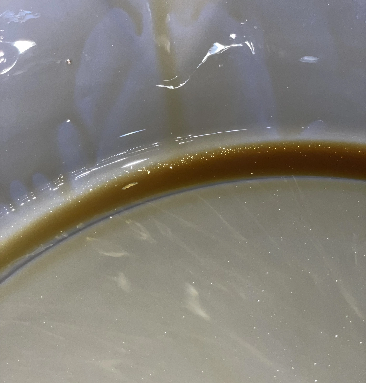

I did an oil change right after the 1,000 mile break-in, and this is what came out of the engine. This is the drain pan I drained the oil into. Those flecks of metal you see aren't gold.
Wow that's bad. What was the issue and did it get resolved?
Probably no issue. common for a bit of sparkle after the first oil change. That is why you do a change at 1500 miles. Little bits and honing left of from manufacture. Chunks are bad.
You will see very little after second oil change.
Remember to check the filter.

That's the particulate from the initial wear-in of a brand new engine. That was in the oil before I removed the filter, which also had particulate in it. This is why you change the oil after the first few hundred miles of a new engine, so that particulate isn't circulating in the engine. I also changed the transaxle oil for the same reason. A few hundred dollars spent now to change that wear-in oil early, will help protect things for the long run.
