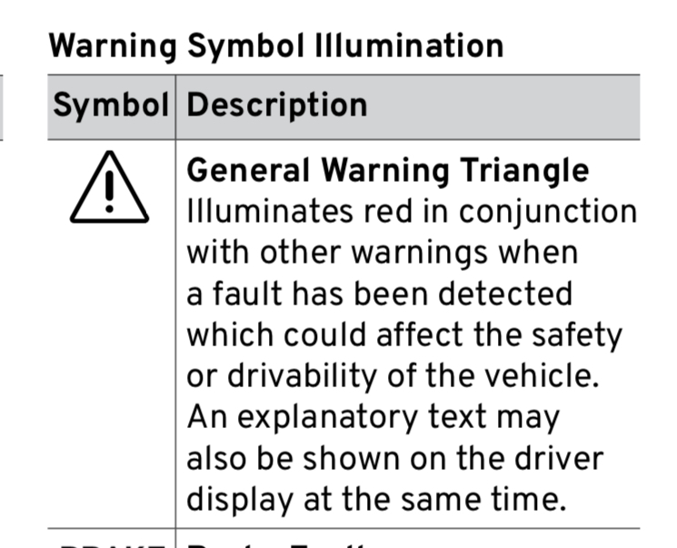

Thinking......the owner manual notes only a RED color for the general warning triangle and relates this warning to other faults which "could affect the safety or drivability..." of the car. Today added gas to my car when warning light for low fuel displayed, along with general warning triangle in AMBER-engine off when filling, triangle gone on restarting. Perhaps amber color because low fuel warning not a serious effect to safety of drivability?? And maybe shown in red in your experience because engine was running during fueling (Ryan, I recall your saying red warning gone on later restarts)?? Maybe ECU considers fueling with running engine a safety issue and popped up while engine still running?? I don't know, but should be easy to A and B on subsequent fueling from low fuel level; engine off then with engine on. Manual makes no note of this general warning showing amber for any condition, but clearly we both have seen it with the refuel icon......must be a reason?
The manual implies the entire triangle/exclamation point is red but you had only exclamation point........who knows what the heck is going on...................:rolleyes:

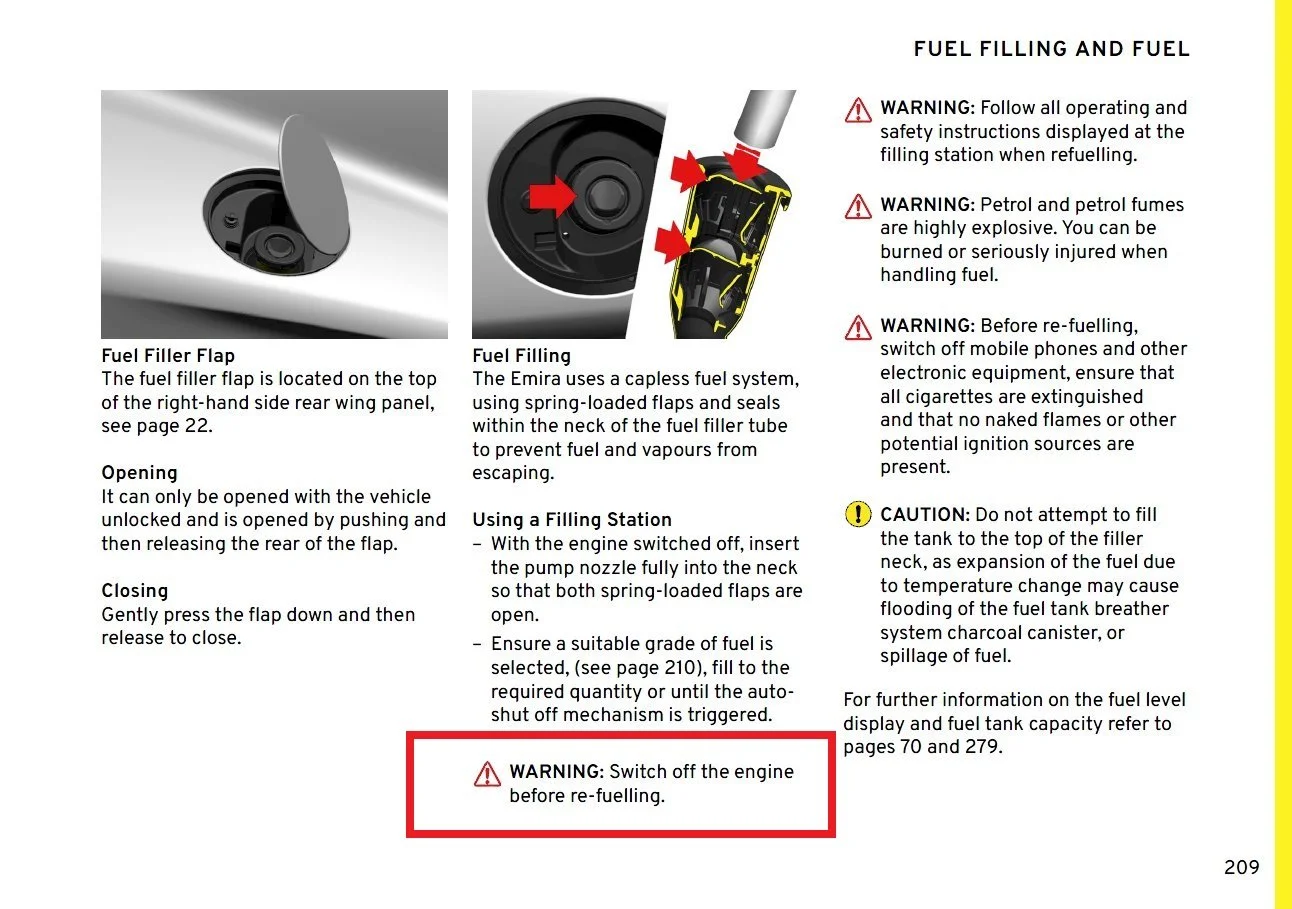

My first thought was, why would you EVER leave the car running whilst filling it up.
Even the notices on garage forecourts say not to.
I would not be surprised if this was the cause

It was the "General Warning Triangle" ....which is apparently 'red', according to the manual.
