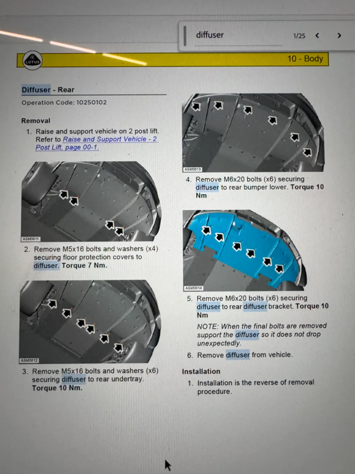

I also found some, albeit not that many, rusting bolts when I removed my under trays, so I undertook to replace ALL bolts (and only a couple clips) with Stainless Steel ones. I did this not only because of rust prevention, but also because I didn't care for the looks of OEM Frankenstein bolts. Another seemingly minor resulting benefit, is that these stainless steel bolts each weigh 2,3 or even 4 grams less that the OEM equivalent bolts. When you add the stainless steel bolts' collective weight reduction, considering the million or so bolts used on the underbelly of the Emira, it's actually is not that insignificant after all.

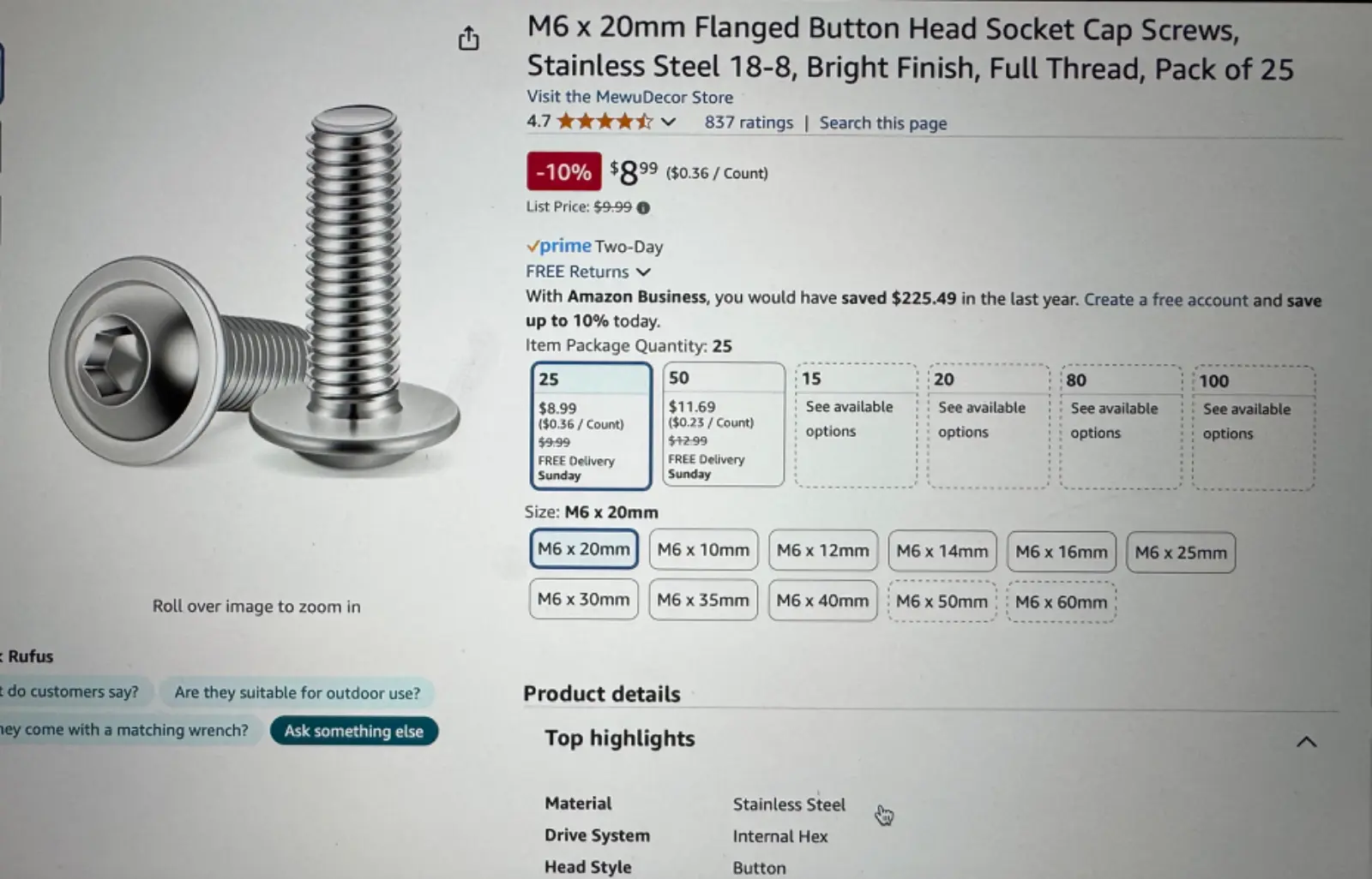

I ordered my bolts/clips on Amazon as per the pictures shown below. Some were M6x20s, but you need to order according to the numbers, sizes and lengths of the ones you're planning to change. I found all the sizes needed to exchange all the under body bolts on my car from this same vendor. Hope this is helpful.

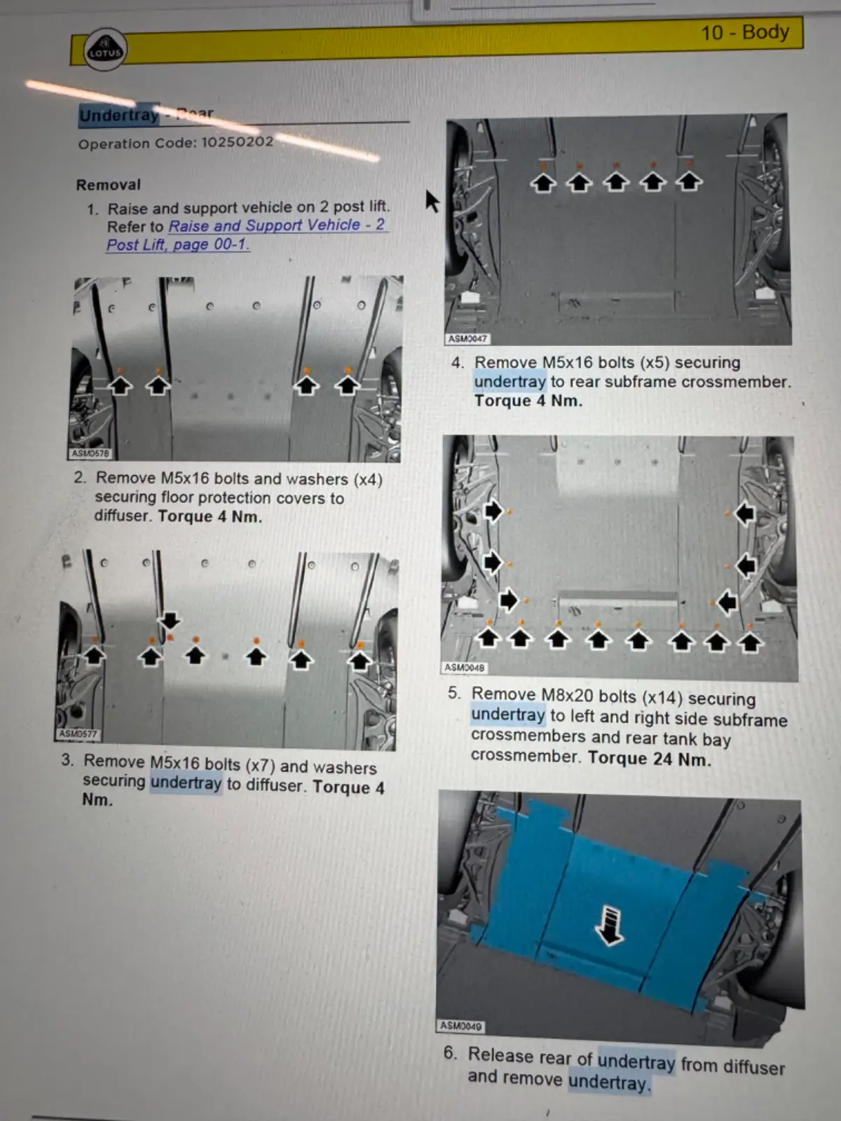

It all depends on which and how many bolts you intend to swap to the stainless steel ones. As I mentioned in my previous post, I changed them all and began by ordering the bolt sizes and quantities based on the specs shown in the service manual's diagrams of the diffuser and under trays (shown below).
As for the remaining bolts i.e. side skirts, wheel arch liners etc, I just removed one OEM bolt from each section, measured it, took a visual count and ordered those. The stainless steel bolts come in natural stainless steel or black for the plastic diffuser and the others for the raw aluminum sections), so if you'd like to match the color of the bolt to the specific panel section you can order accordingly. I decided to color match them to make them more discrete but also because it may help identify where each bolt belongs, should I need to remove two or more panels for a specific project. Finally, since these stainless steel bolts are fairly inexpensive, I'd recommend ordering in excess of the calculated amount and also order 3 sizes of stainless steel washers (some OEM bolts have them). I ended up using a good number of the left-overs on the door panels and other sections of the car during my other mods and sound deadening projects. I have saved all my OEM bolts, not because I'm planning to re-install them some day, but because weight reduction is an important part of my mod projects and I was curious about the weight of all the replaced OEM bolts/washers (a damn heavy large bag of them so far) vs the Stainless Steel ones and, believe it or not, the stainless steel ones weigh essentially half.

OK….if I am counting correctly that's:
At least 19M6X16 for securing the undertray to the front pumper panel
At least 26…M8X20 for securing the undertray to the lower crossmember
And….securing the undertray to the left and right subframe crossmember & rear tank bay
At least 15…M5X16 for securing undertray to rear subframe crossmember
And securing floor protection covers to defuser
And securing defuser to rear undertray
At least 12…M6X20 for securing defuser to rear bumper lower
And securing defuser to rear defuser bracket
72 washers for all the above
Hi @GregT,
I think you got the numbers of bolts for the specific sizes just about right, but as I had mentioned before, I'd recommend ordering a few more of each bolt spec anyway so you can have extras for other future replacements. Where I believe you've gone way overboard is in the washer count. The stainless steel bolts, similar to the OEMs, have a flanged head design, so essentially there's hardly a need to add washers to all the bolts. If you take a peak at the underbelly of the car, you'll see that very few OEM bolts actually have washers. You can take a visual count of those few and order accordingly.

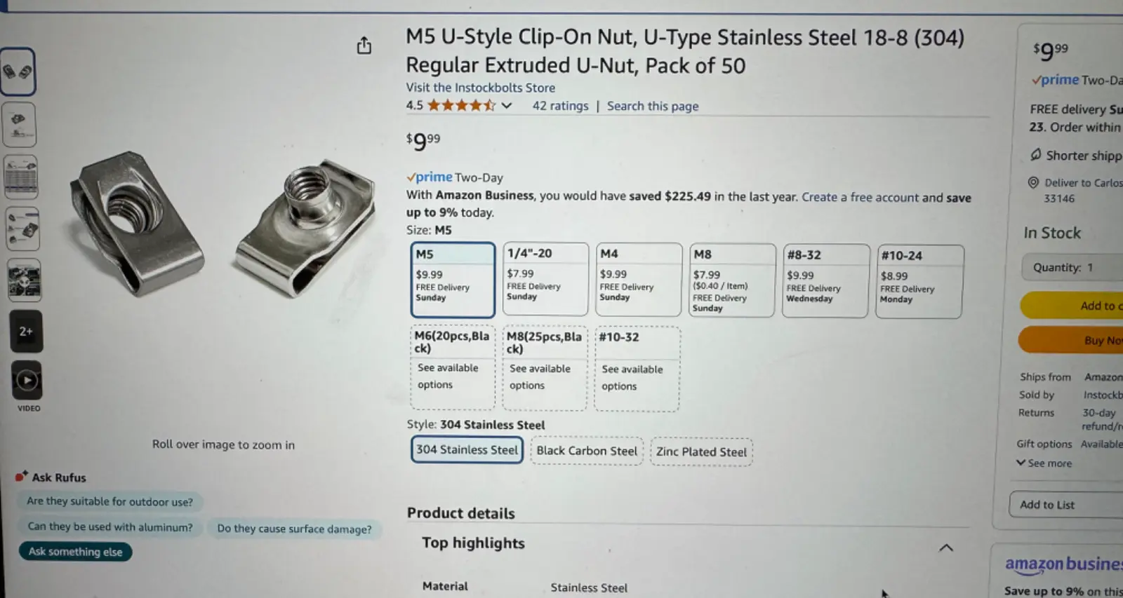

Excuse my ignorance but......none of these bolts need clip-on nuts?
Thanks again for your help.
So.....'clip-on nuts' ?
Thanks.
Hi again GreggT,
As you've probably seen on my Feb 22nd post in response to @Billan's case I attached a picture of the applicable U-Clips because he found some missing or rusting on his Emira, but I only replaced one or two of them on my car so far because the OEMs got damaged. Otherwise, quite frankly, I don't see the need to replace the perfectly good OEM U-Clips. That being the case, if you'd also like to have them on hand to replace any future lost or damaged ones, I'd recommend ordering just the mostly used M5 and M6 sizes. Hope this answers your question.
