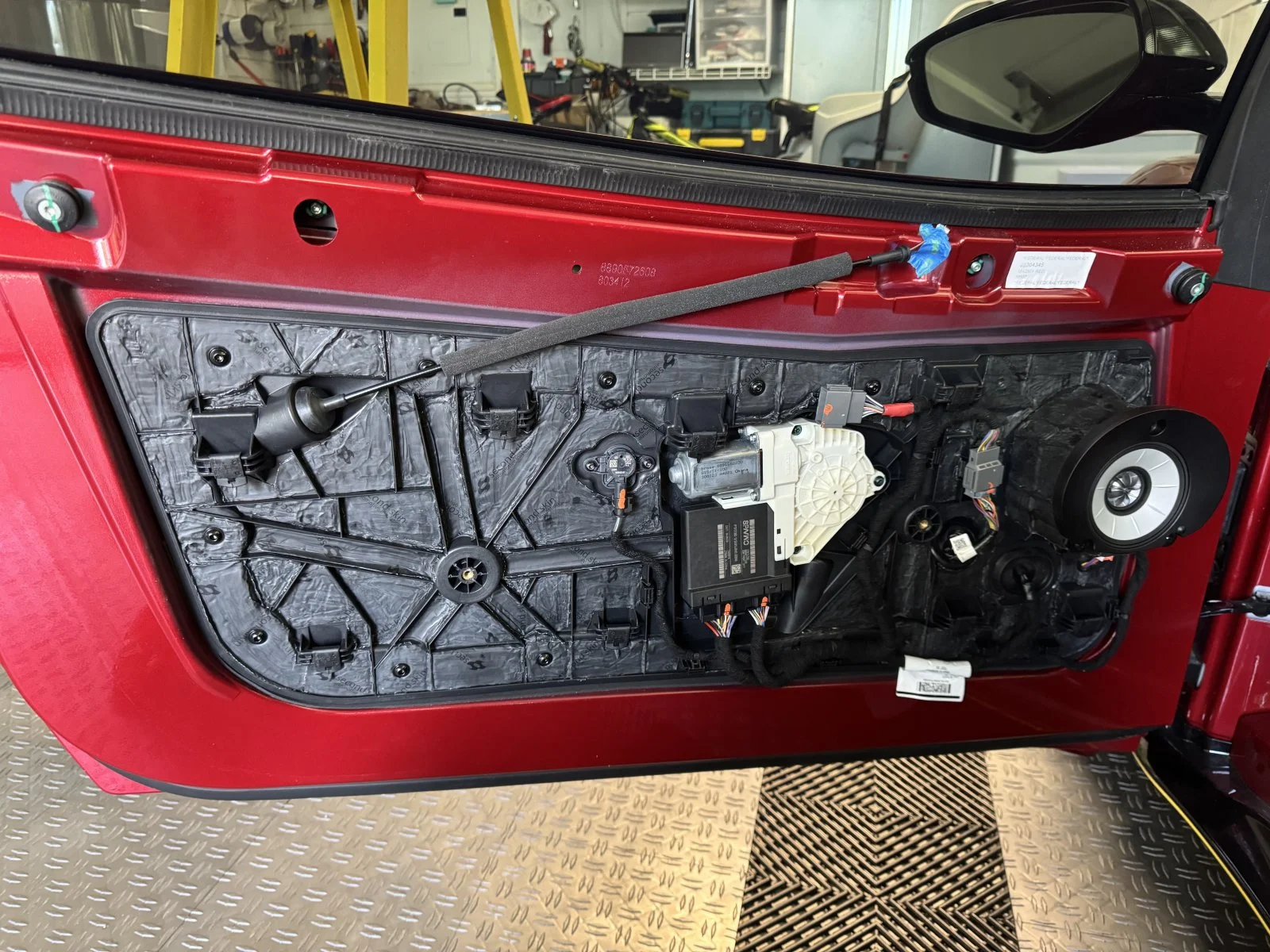

2. If all that looks OK, consider removing that first door panel. It's easily done: remove the 2 bolts mentioned in #1 above, then lift up to unlatch it from the door. You must also remove the door handle cable, which isn't hard. Below is a photo taken by someone else, showing that outer panel gone (and the inner panel with sound deadening material already installed, so yours will look differently): you see the 6+ "brackets" sticking out, which the first panel, hooks into to (you lift it off these). You also see the door handle cable, which is attached in the photo, by blue tape on its right side. The "blue taped end" is the one you need to disconnect. With that door panel removed, shake it or knock it in areas, to see if you can recreate the noise. If that panel sounds solid, you'll have eliminated it as the cause.
