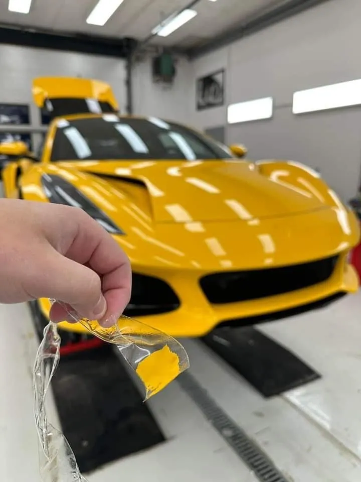

Starting this thread on behalf of @kitkat ... would love if someone else could tell me this picture is not paint pulling off the car, or provide a reason to not be concerned.

Could be anything. What is the source?
The source was a PPF installer on Facebook and repositioning the PPF film during installation caused paint to delaminate -- adhesion wasn't great.
My guess is that this was somewhere lower on the bodywork where paint would be thin and potentially have less adhesion, like the bottom edge of the front bumper. Not too much other detail.
Removal of clear or even color is _always_ a risk with PPF, really have to be careful removing it. There's also the risk of adhesive being left behind.
This is very true, but usually not a problem with a good factory paint job. Resprays tend to be more problematic.

This isn't the first time I've seen or heard about this with the Emira. Many detailers have criticized the factory paint and one even claimed it felt "tacky.. almost wet." Like it wasn't cured properly.
I swear, it's one thing after another with this car. Things I swore they couldn't get wrong... From seatbelts to windshield washers to brakes and now paint. 😕

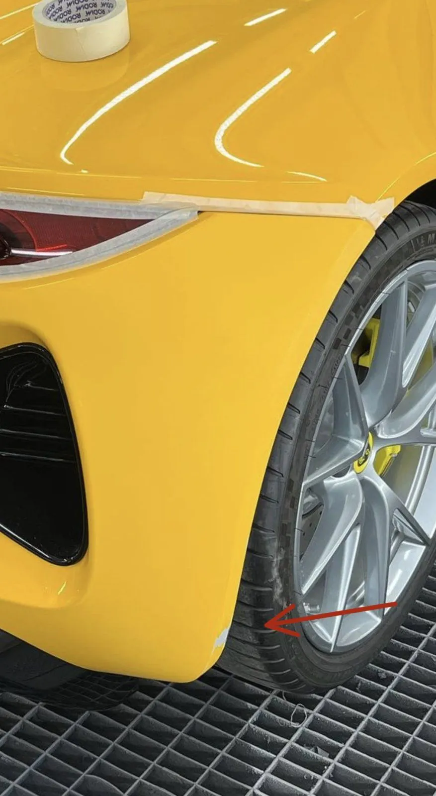

I think I found the car that had the issue, the chunk came off of the rear passenger side bumper during ppf install I suspect. They had to repaint that part of the bumper.

Don't jump to conclusions. There are cars being delivered right now in the UK and to some European countries that are coming right off the end of the assembly process and into the hands of buyers, and some of those people seem to be going for PPF immediately. That's way too fast for this type of paint. It can take 30+ days for some modern paints to fully cure, and some longer than that. I personally won't be doing PPF on mine until I know it's been at least 60 days since paint.

Okay, so the theory is that someone took this to PPF too soon after factory painting. I can accept that and that would make surface level sense from my extremely limited knowledge of modern automotive paints! I am okay with waiting a couple months to PPF in order to avoid something like this happening, if that really is the situation!
Wasn't there a whole thing about being able to receive PPF from factory/ from a partner before pickup, though? You'd think if this was a potential risk, PPF from factory wouldnt have been a consideration?
Where the paint was pulled off on that Hethel Yellow car, there is a small strip of factory installed PPF directly behind the rear wheels.
I suspect the PPF installer tried to remove it to PPF the entire rear bumper and that’s what caused the paint to peel off. They probably tired to pull it off like sticky tape in cold weather without heating it first. 😲
