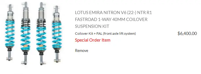

Sooooo, what kinda cost are we talking here? Would love to have the option to lower with a lift system.
From Gregs race parts
