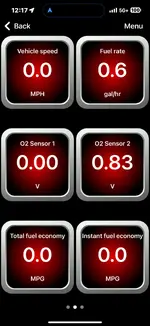

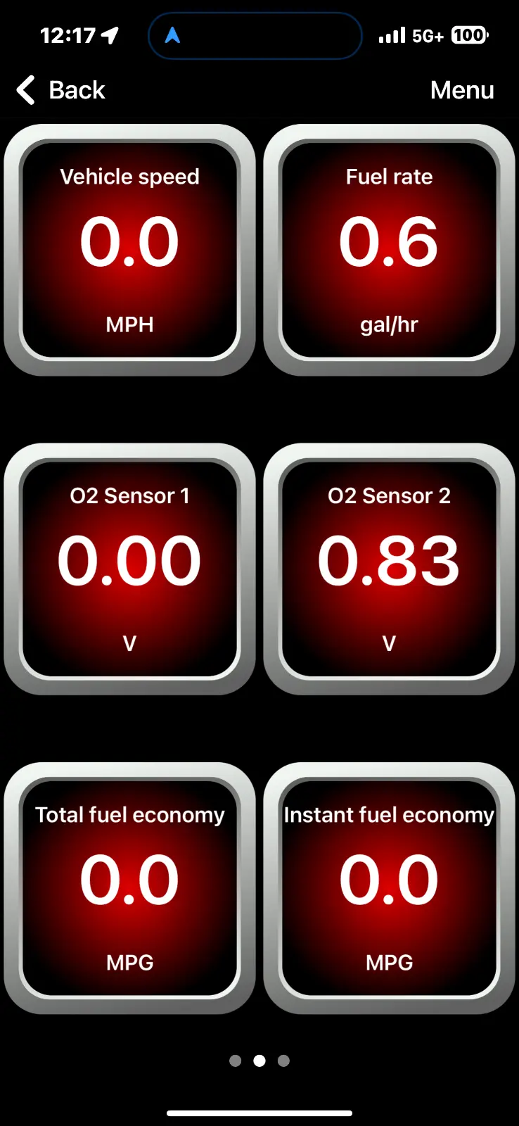

Just got an engine light related to the O2 sensor bank 2. Should I clear the error of getting these measures or the sensor needs to be replaced?
Thanks in advance for insight!

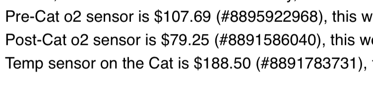

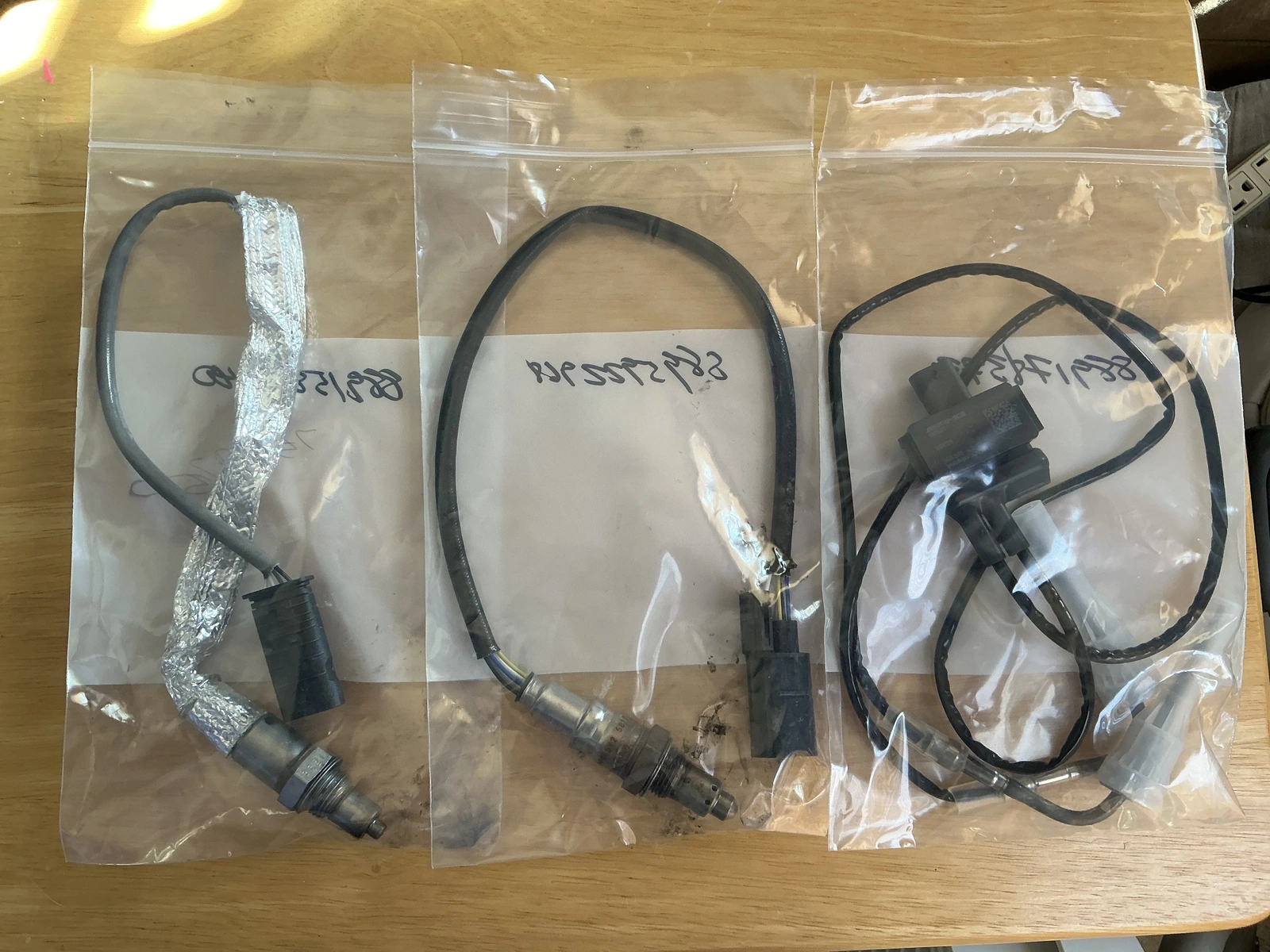

Not saying you have to replace it, but i just ordered spare O2 sensors and DP temp sensor. Was surprised how relatively inexpensive they were (compared to Alfa Romeo OEM parts)
I'm surprised they were readily available. Getting parts from Lotus seems to be a hit or miss situation at best.

Can you get a graph of the two O2 Sensor Voltages please, like 1 minute in idle. Don't touch the gas.
If your app doesn’t support it, use "CarScanner" from the appstore. Blue background, white engine symbol.
Here is how you debug whether you need new O2 sensors, or if your catalyst failed:
Your pre-cat O2 sensor being 0.0V is suspicious, but only if it's flat-lining at 0.0. Like @Kimmax said, log your pre-cat and post-cat O2 voltages over time, once the car is up to normal operating temperature.

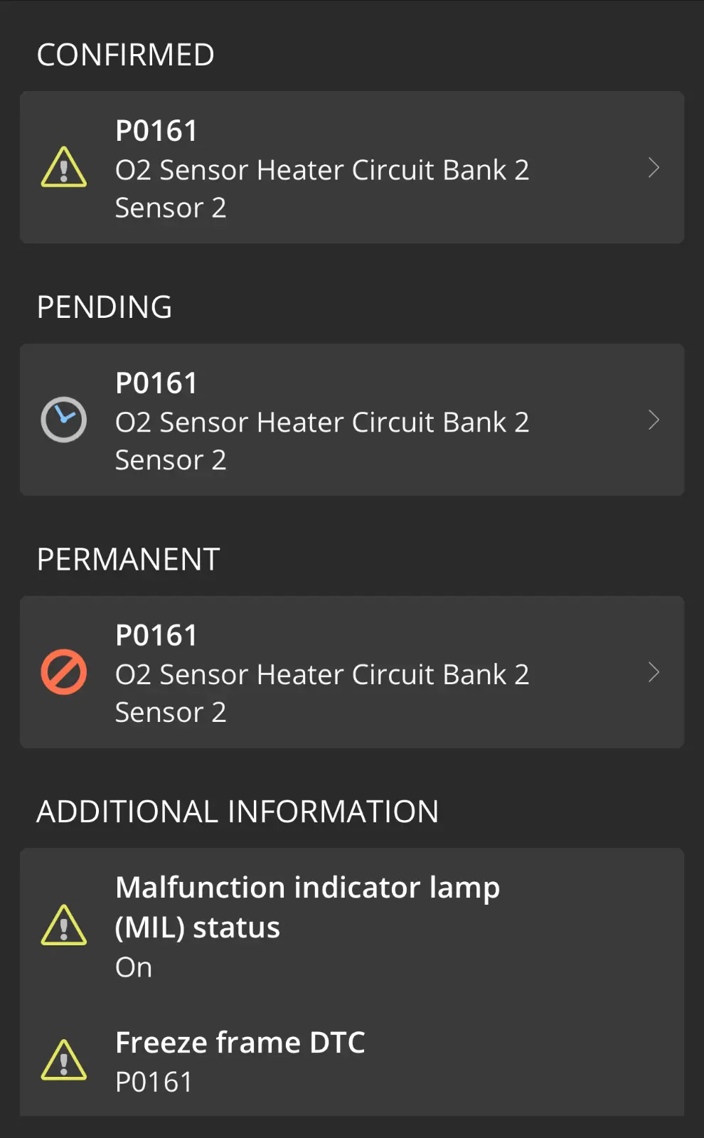

I had codes P0161, P0158 and P0116. I cleared them and had the o2 sensors replaced under warranty a couple months after I got these codes. If you are planning to go to the dealer soon, I would not clear the codes so they can easily see the codes.
