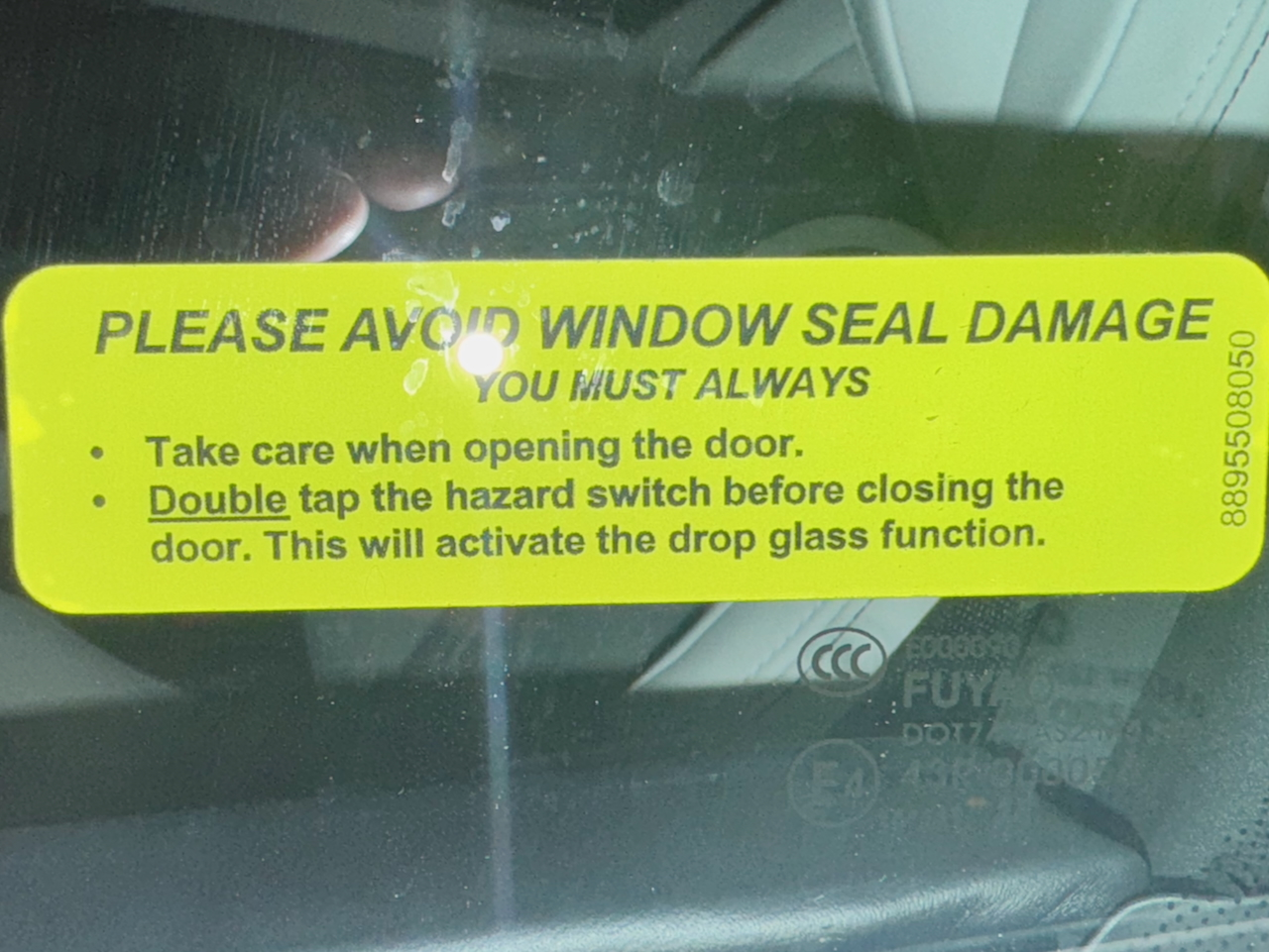

Just taken delivery of my car - along with attached sticker. I have scoured the manual looking for mention of the 'hazard switch'. Thoughts?

It’s meant to be removed by dealers during PDI. You can disregard it if your windows roll down a bit when you open a door. I think the auto drop glass function is not active in transport mode so they are warning dealers not to slam the door closed or glass may break.

That makes sense, as they probably disable a lot of the electronics - especially on cars that travel across the pond.
