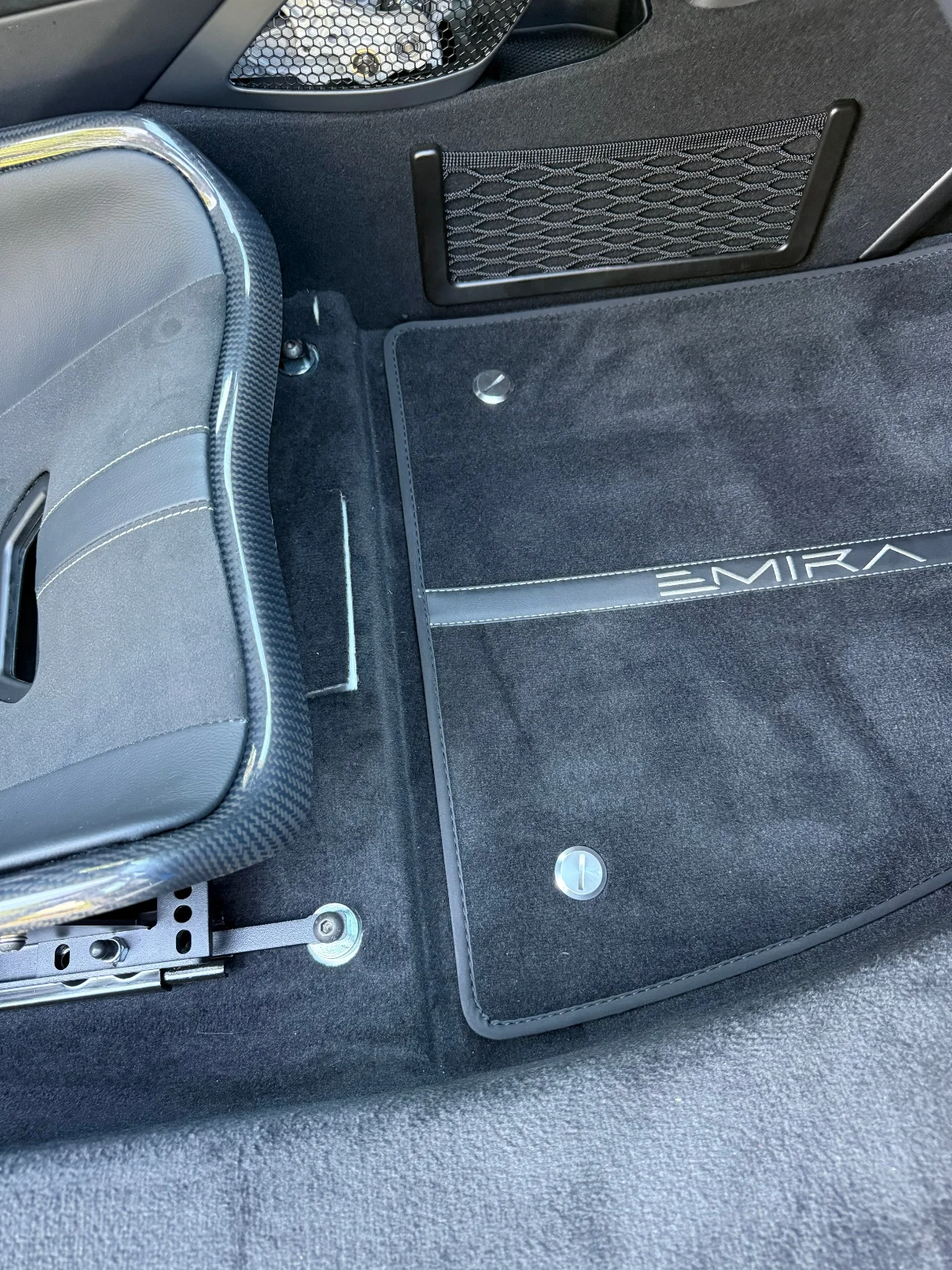

Sorry for the delay, it's been a hectic few weeks. All went to plan with the retrofit - solves the problem while looking great in the process.
When removing the plastic post, it is the perfect diameter to the original threaded system. Used a lathe to cut small pieces of aluminum down to the proper OD, added threading to the interior, then a small hole in the base to rivet into the chassis. Need to get around to cleaning up the carpeting trimmed around the receptacle, but since it's covered, it doesn't bug me too much... yet.
