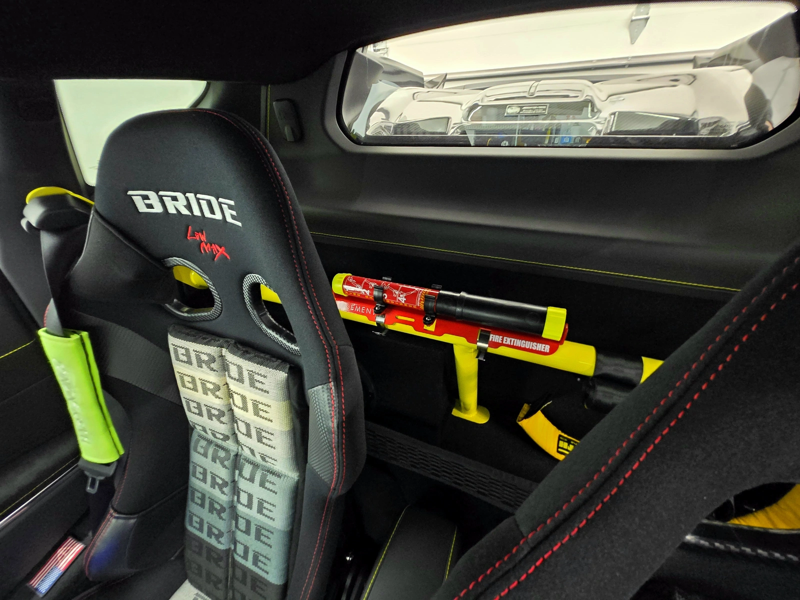

Santa brought me an e100 fire extinguisher.
Would love to see where you guys have mounted them.

I have an e50 that I was planning on mounting to the back of the drivers seat but haven’t gotten around to it. I also considered mounting it vertically just below the slot where the drivers side seat belt disappears into the panel, but I think the back of the seat will be less visible and easier to access. Either way you’d have to tilt the seat forward to get to it.

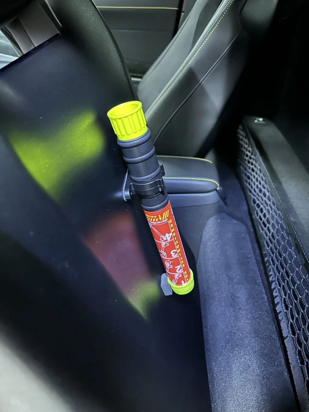

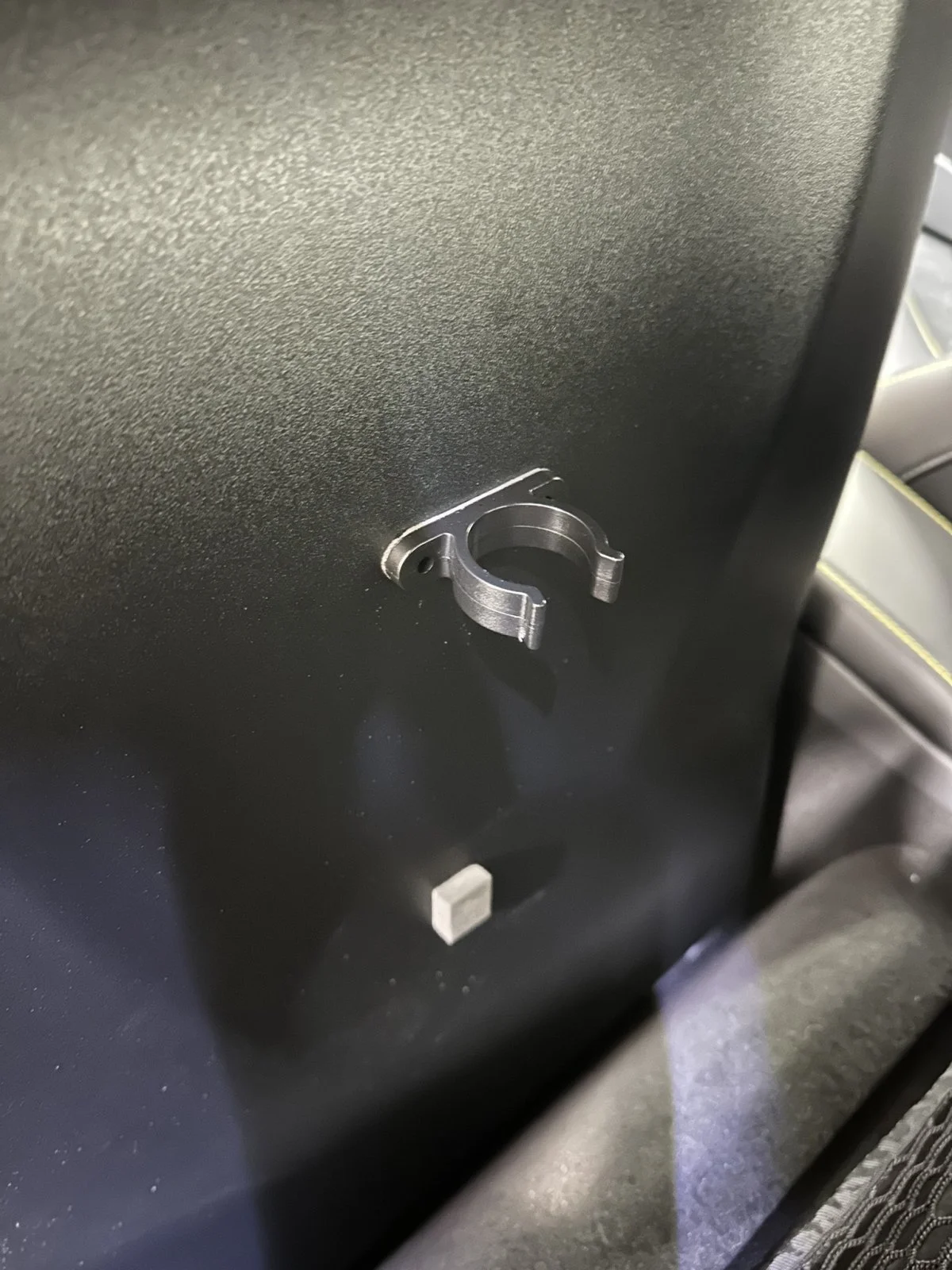

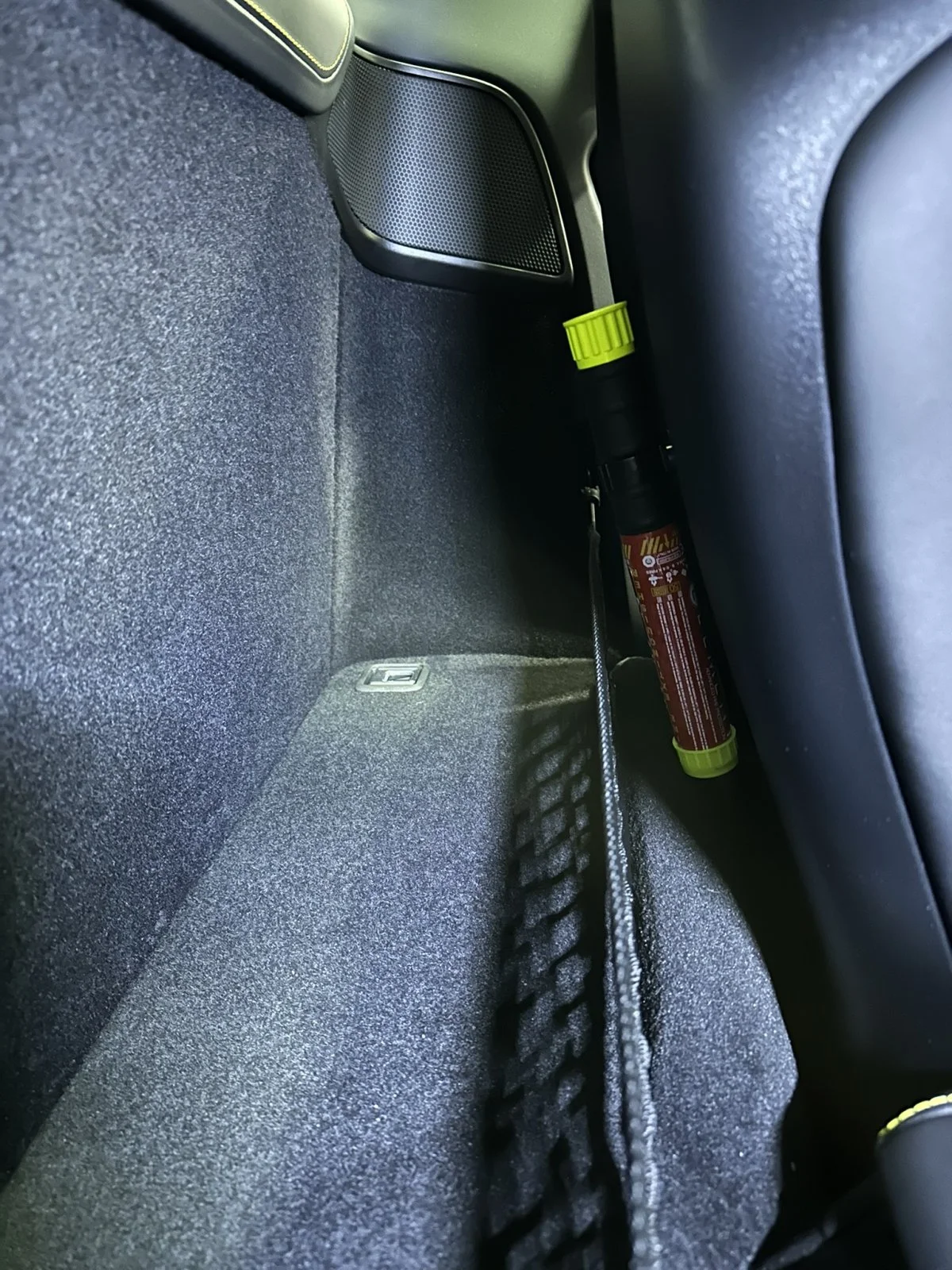

I finally got around to mounting this. I just used some VHB tape on the stock mount. I made sure to mount it high enough so that if you move the seat all the way back it clears the shelf and doesn't get crushed. I also added a small bit of foam at the bottom to keep it from vibrating against the back of the seat.
You really can't see it from any angle inside or outside the car unless you know it is there and are looking for it, which I like. And it's as easy to get to as it can be without being mounted completely out in the open in the cabin.
