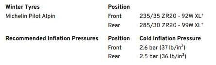

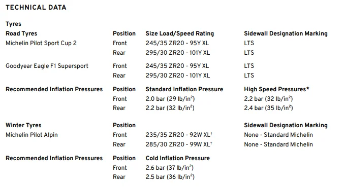

Michelin Pilot Alpin PA4 are “official” winter tyres, stamped with the “3 peaks” symbol – the 3PMSF marking that is often legally required for winter driving in Europe.
Cold tyre pressures on the Alpin PA4 were 37 psi front, 36 psi rear.
Edit: Tyres I fitted were Front 235/35 20 XL, Rear 295/30 20 XL. I got these from mytyres.co.uk - about the only place that had them in stock. They had a few negative reviews but a decent price. I had no problems with them, tyres delivered within a week and good communications from them about the order.
PSI higher at the front, than the rear ? Thats unual.

Just from the owner's manual - feels OK though. They were a lower when fitted - all around 33psi - for a few minutes until I could check them, but they feel better inflated to the correct pressures.
