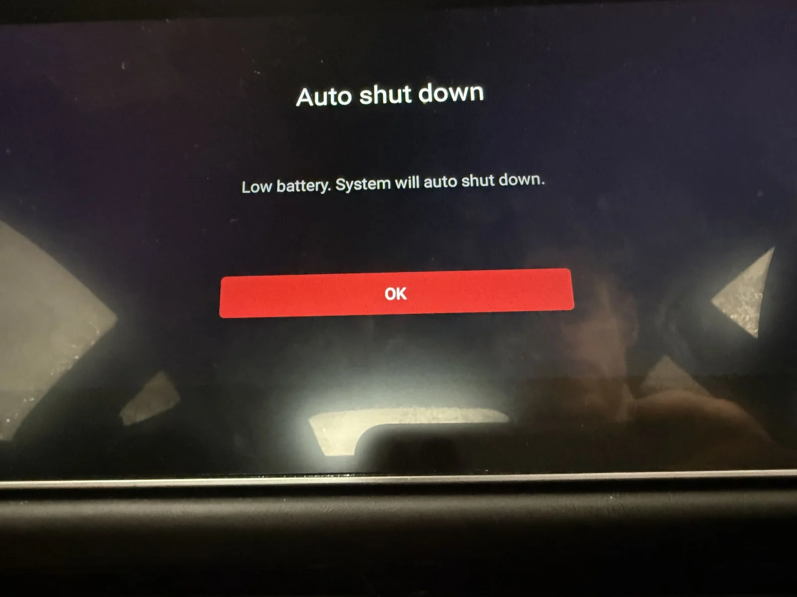

I was sat in stationary traffic on the motorway the other week with the engine off and the infotainment on for 30+ minutes without getting that message. However, I did have the car on the trickle charger for the previous week. Could it be that your battery capacity was sub-par at the time? I used to get a similar message in my M3 when it had been left in the garage for a a while.Unless the engine is running, it seems I can’t keep the infotainment / music playing in my car for more than a few minutes before it says
‘low battery. System will auto shut down’
Is anybody else familiar with this?

Does Convenience Mode do this? Not tried it myself just reading the manual.is there a way to keep the audio / infotainment running with the engine off?
I encountered this when breaking in my speakers. Didn't look much into it and just drove a total of 50 hours listening to white noiseI can find no way at all of listening to audio / using infotainment with the engine off - surely it must be possible? Plays for about 2 minutes then the Low Battery - auto shut down message.

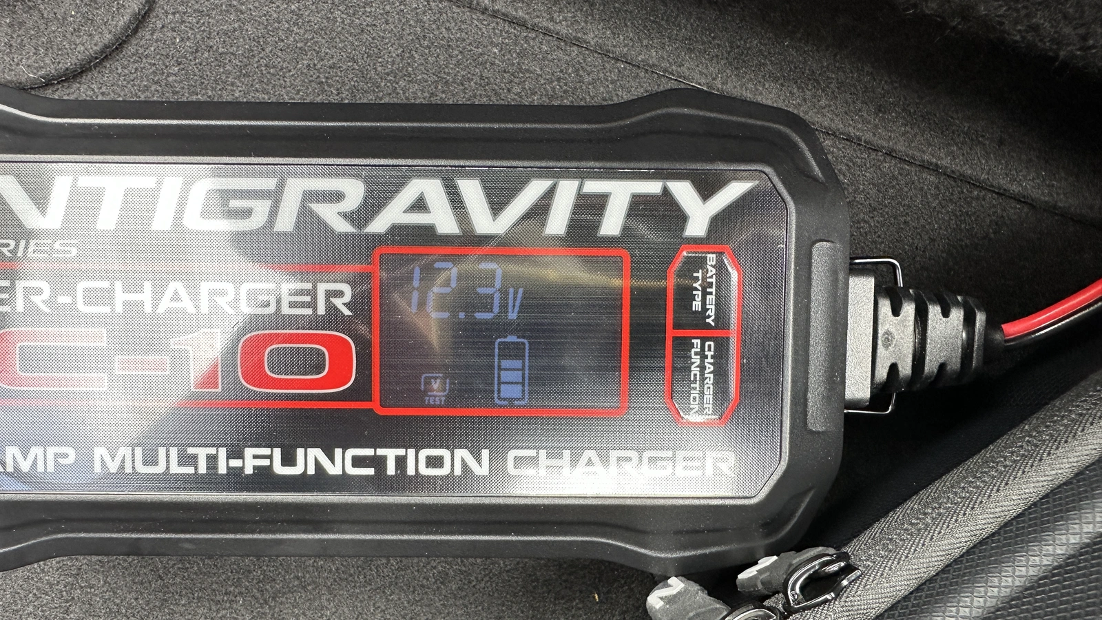

Even tried plugging the trickle charger in, but it still happens…..anyone?

I think you need to try a real battery charger, and if that doesn't work replace the battery.I can find no way at all of listening to audio / using infotainment with the engine off - surely it must be possible? Plays for about 2 minutes then the Low Battery - auto shut down message.
I'd try a good charge before assuming it needs replacing, though if even after a good charge and maintaining and/or regular driving you still get messages like this, and your dealer isn't farther than the cost of just buying a new battery, then yes you could try and get a warranty replacement out of them. You'll probably want to document your charging and how fast it gives you those messages after because they might not just take your word for it.As well as the Auto shutdown message I also get this one too now despite the car being in regular use and also often on charge overnight.
Battery needs replacing? Covered under the 3 yr warranty?
