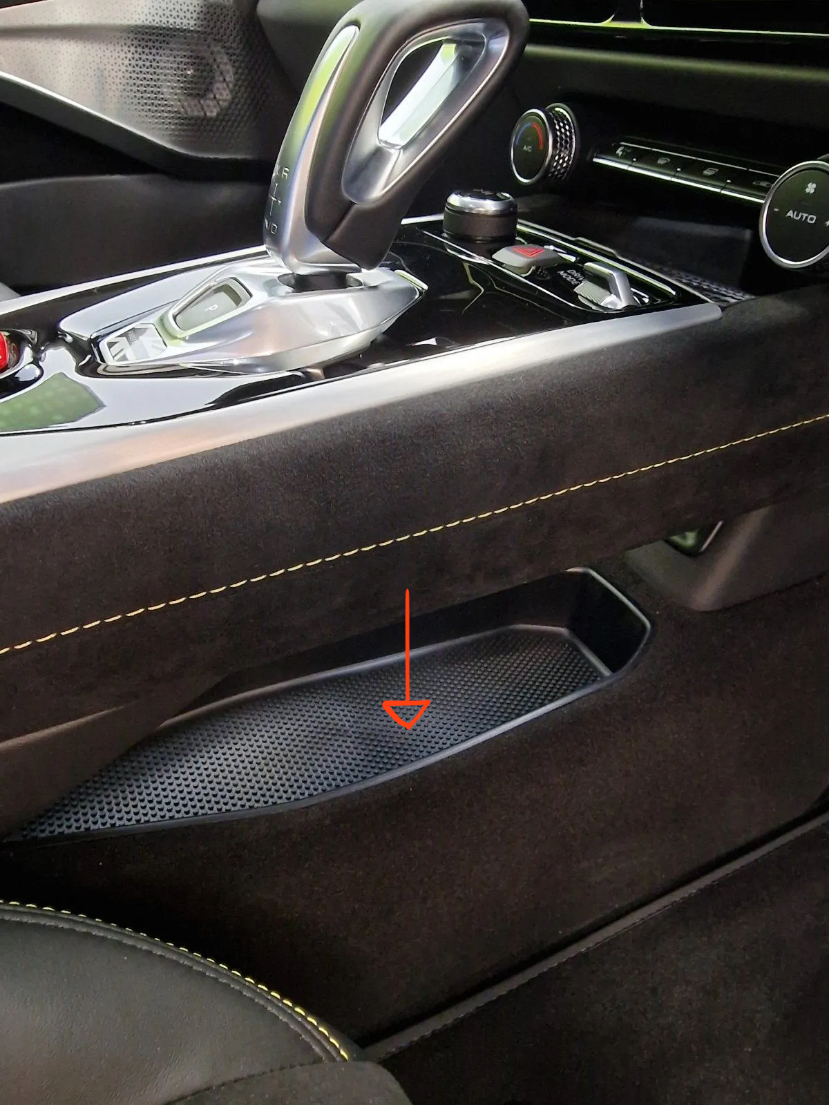

Has anyone taken the time to remove any of the tunnel parts on the i4? Specifically, the shifter undertray? Anyone have guidance, or better yet shop manual reference pages for the removal? Attaching a picture for reference..

Lift the rubber liner. There will be 2 bolts at the front and one at the back. Then you can just pull the tray out.
