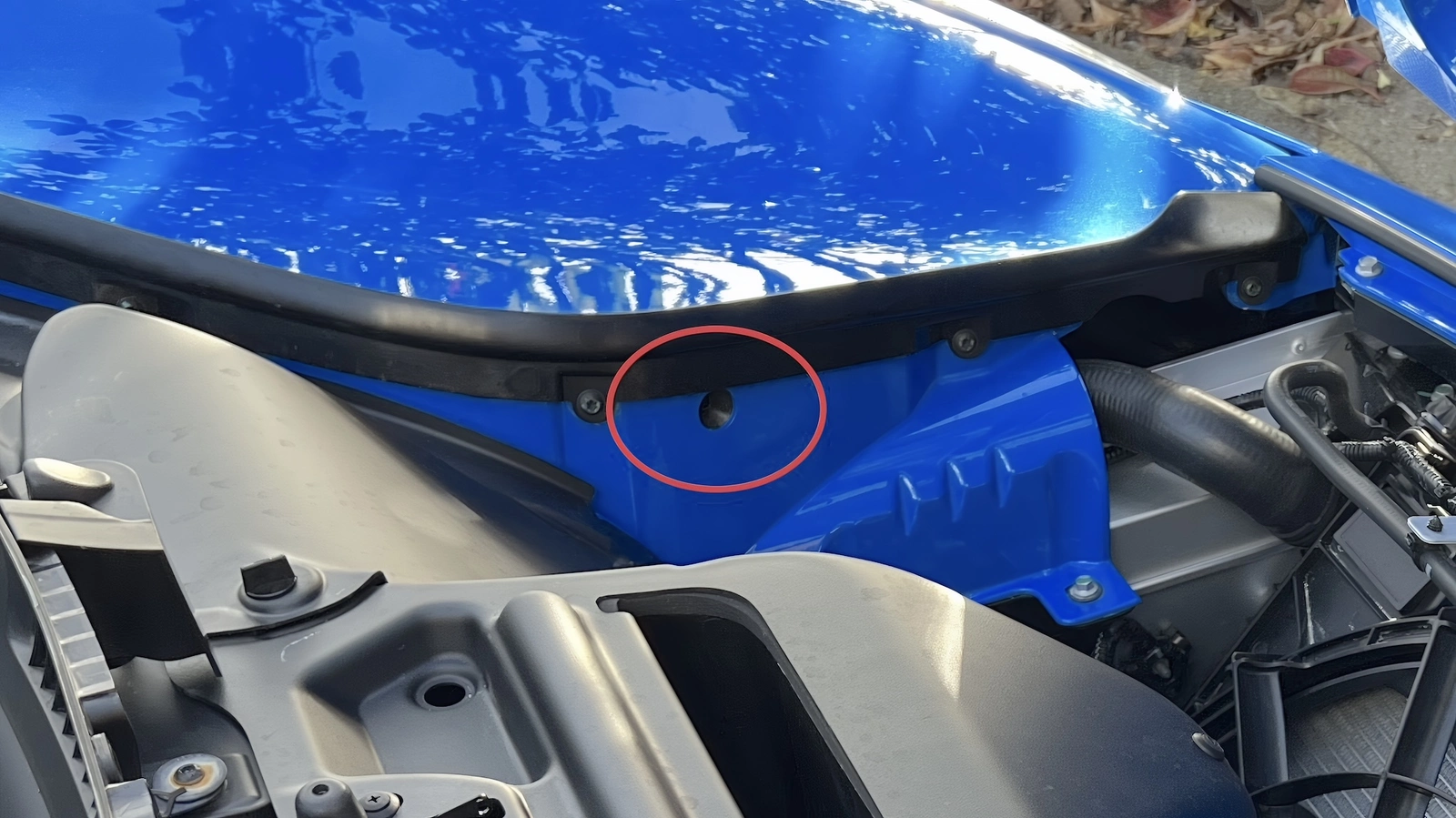

There's an adjustment access hole on the inner fenders inside the front. You have to lift up the front hood. There's one on each side of the car.
I did it when I first got my car, because the left headlamp was lower than the right. You adjust it with a hex wrench. I can't remember exactly what it was, but it may have been either an 8 or 10mm. To raise the headlights, turn the screw towards the interior of the car. On the left side of the car, that will be counter-clockwise, on the right side it will be clockwise.
If you have a level driveway, use the garage door to see the light pattern so you can match them. Otherwise, find someplace where you can project the beams on a wall to see the light pattern. You want to be about 10-15 feet back from the wall. Measure the distance from the ground to the center of the headlamp on the car, and then match that height on the wall where the beam is projected.
For example, on my car the distance from the ground to the center of the headlamp is 27 inches. Put a piece of painter's tape at that same height (27 inches) on the wall, then adjust the beam pattern so the top of the pattern is no higher than that. To be safe, adjust it just a bit below the line because over a distance the beam height becomes greater and greater the farther away.
