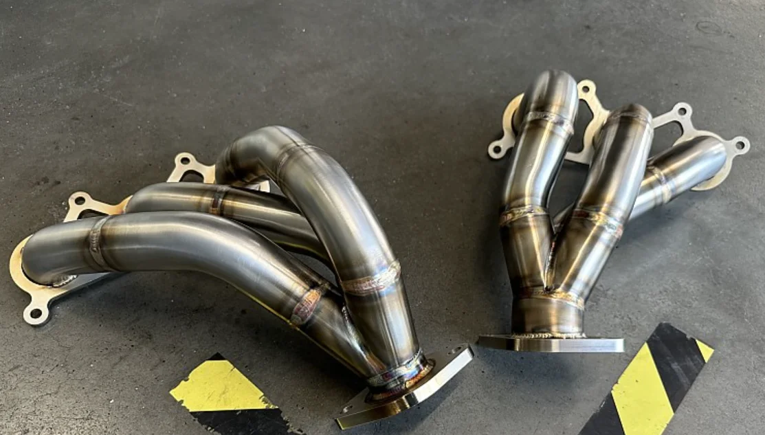

Phoenyx Catless or 200 cell headers:
$1499 catless, $2499 200 cell

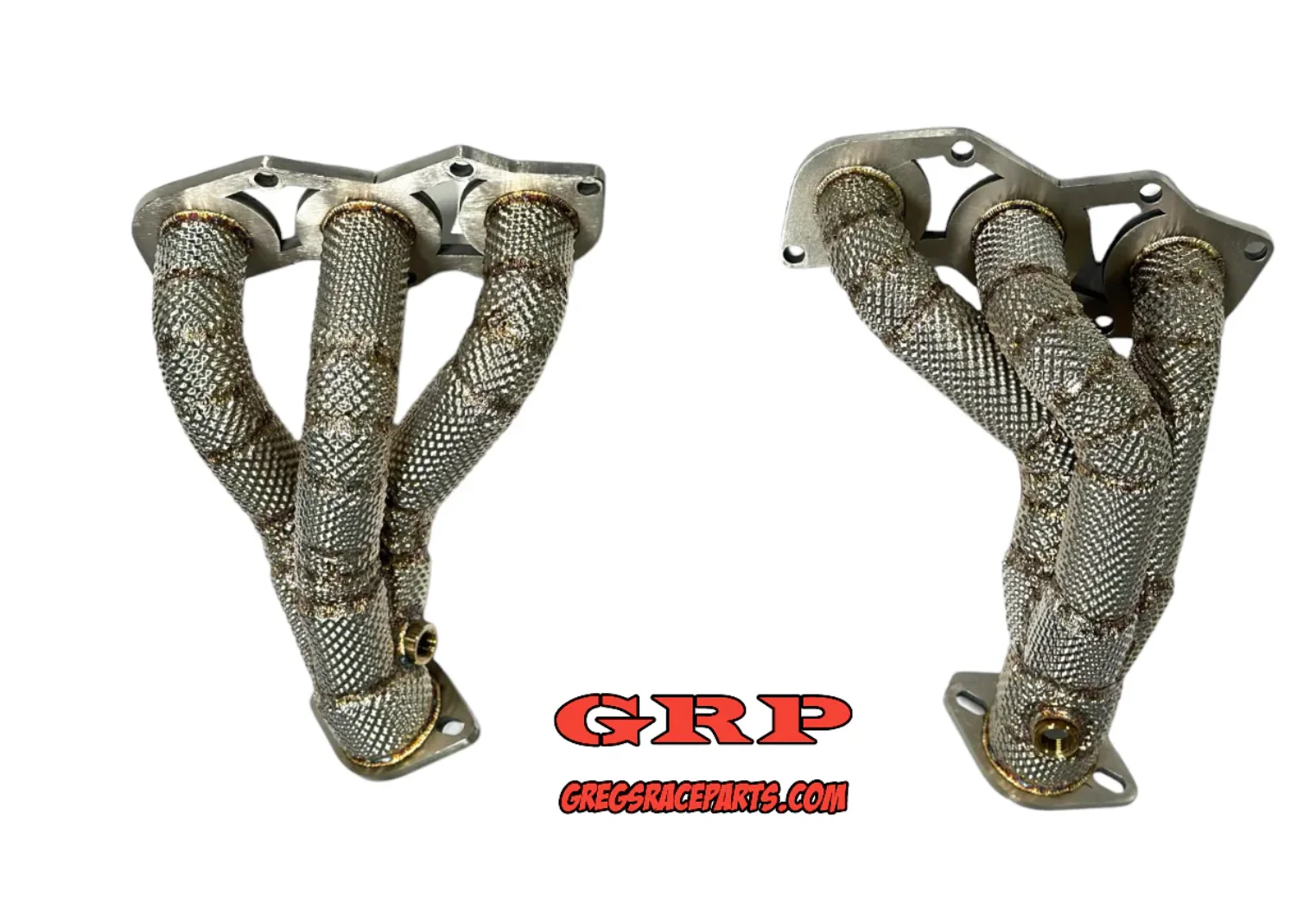

GRP Catless headers:
$1299
https://www.gregsraceparts.com/products/grp-stainless-shorty-race-headers-for-evora-emira
O2 sensor at collection

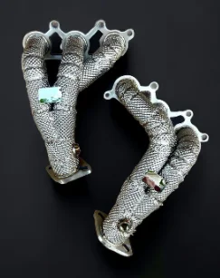

Jubu catless headers:
$2800
O2 sensor position tbd

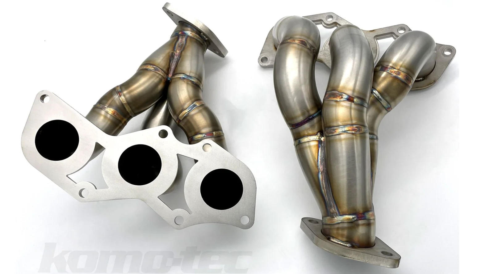

Komotec catless headers:
$2100

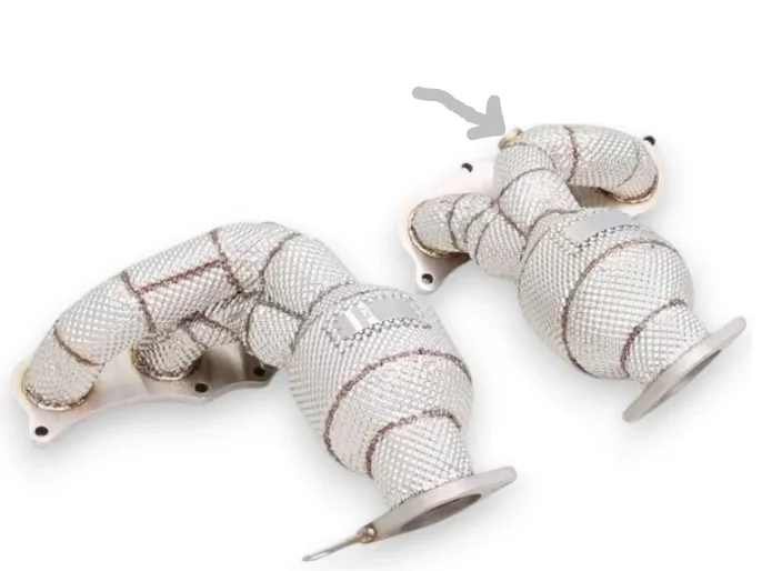

$1100
Updated O2 sensor position at collection

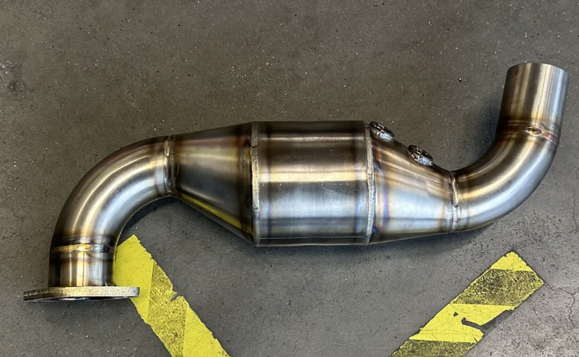

Third Cat: Jubu HJS HD sport Catalytic converter
991.86 Euro
Based on the design, I'd say the @GRP or @Aerie would be the best, but those would require you still keep the factory 3rd cat and that setup would likely be LOUD. With only one cat, there wouldn't be enough emissions control to pass any standards either. The headers with cats on them are so short, why bother? The whole point of headers is to open up the flow path out of the exhaust chambers of the cylinder head, to improve scavenging the exhaust out of them. A good design is a combination of length and bend of the pipes, and how they come together in the collector. Air doesn't like to turn corners, it loses velocity quickly so the smoother the bends and angles, the better. GRP and Aerie are the best looking in that regard.
If you're going to get the headers, get the y-pipes too. Both GRP and Aerie's are decent looking as far as design and build, but then you have the issue of only one cat. For a track build... yeah. For the street? It's going to be loud, and you won't pass emissions... where do you live? Different states are going to be more or less sensitive about this sort of thing. There's also the possible issue of the ECU not liking the change. You might need a tune like the JB4.
