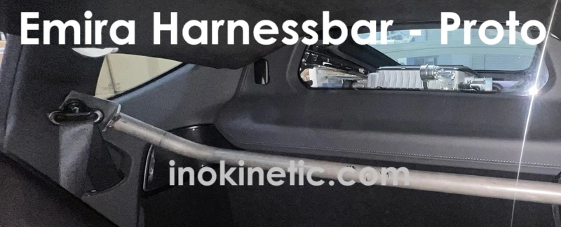

Seems like with the two bolt points (the seatbelts) there is a possibility under some kind of load (hardnesses yanking forward) that the bar would rotate, possibly up or down. I appreciate that the bar is tucked behind the seats far enough not to interfere, and also without any interference with the parcel shelf. Any thoughts about that limitation, or possible safety concern regarding only a 2-bolt pivot?
Unless I am missing something and there is actually a sort of 'locating' hole/tab or some other mechanism which inhibits the bar rotating.
...Unless I am missing something and there is actually a sort of 'locating' hole/tab or some other mechanism which inhibits the bar rotating.
Anti-rotation has been engineered in. We actually have two redundant mechanisms that will prevent rotation. You just can't see it in this picture. We should have a 'final' design into the car next week.

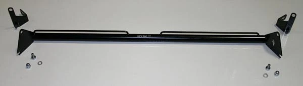

Yes, we learned about anti-rotation back in 2005 on the Elise. Our first bar lacked it and Joe Marko, Schroth USA, pointed out the potential problem. We immediately redesigned the bar and created the 4tress Harness Bar - see below. Those additional brackets kept the main bar from rotating.

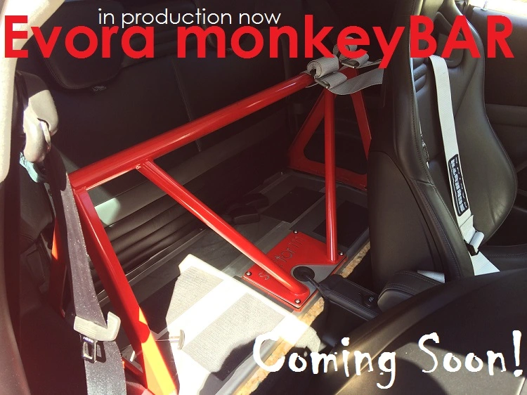

Here is another bar we created for the S1 Evoras.
This is pretty sexy. You’d have to think this adds some torsional rigidity as well. Less great for luggage capacity!
Loss of luggage room was an issue with this Evora bar though most solutions that came afterwards were not too much better...I am excited about the Emira solution as it takes none of the shelf space yet maintains anti-rotation.

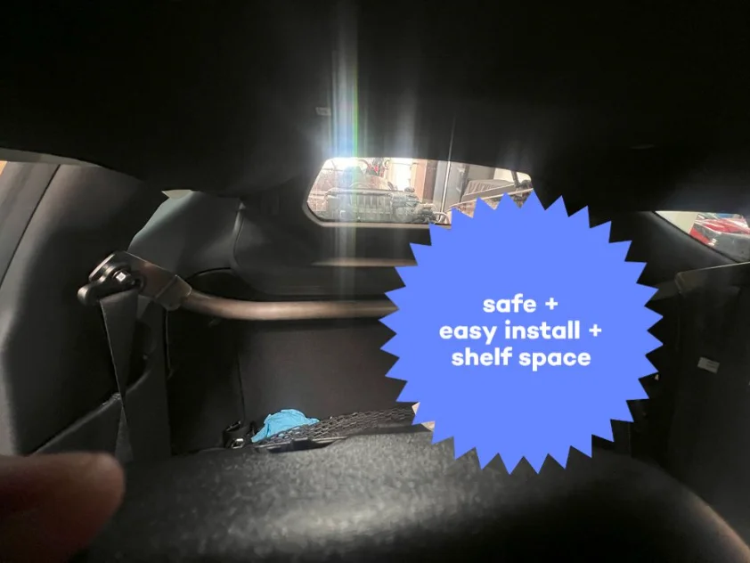

Our second QUADloc harnessbar prototype has been fitted. We confirmed the ease of install and full seat travel. Plus more...
I had a crazy cool brainstorm last week in Japan that will make one of the anti-rotation mechanisms even more effective. We fit this latest version this week and discovered a couple more tweaks so will further improve it next week.
We are not quite ready to reveal our innovations on this bar, but I think many of you will be tickled by them. As a mechanical engineer, I geek out over ideas like this. That sleepless, jet-lagged night, last week, certainly got my creative juices flowing....:)
