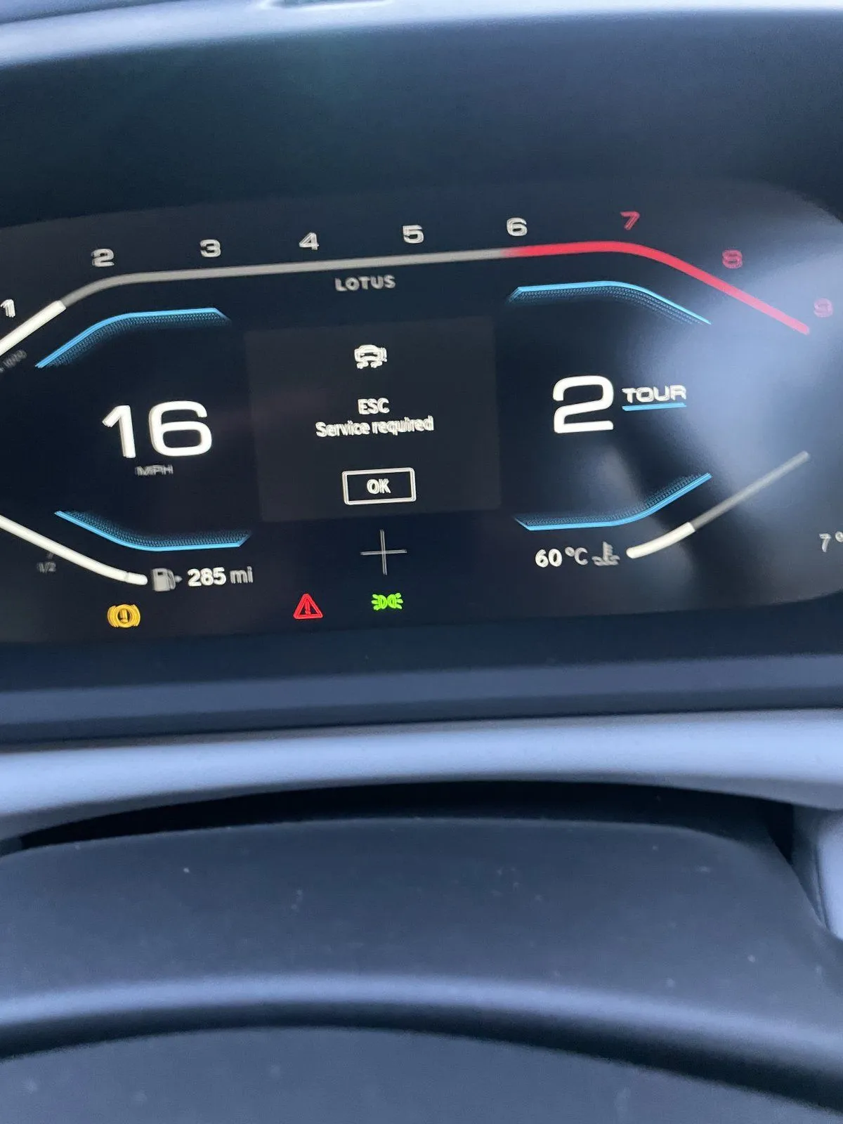

Went for a drive tonight , and the ECC and Brake Failure warning light come on !
Stopped , turned off the engine , then Car would not start
Any suggestions 😳

Almost certainly a software issue which my car also had. The not starting was the immobiliser which reset itself after 10 minutes or so and the car would then start. A software update seems to have resolved it.

Yes ,
I locked the car , left it 10mins , Unlocked it then it started it again , the Car was registered on 1st March , so is there a new software update which it now needs ?

I got my car back at the end of February after the update so perhaps yours wasn't updated. Your service agent is your best bet for getting it checked and done if necessary.

Good point , I will call Lotus Lewes tomorrow , how long does the update take to install ?

Jon. at Lotus Sussex is great , and is finding out about the software today .

My local dealer did a software update whilst I was there on Thursday . My car was registered 2nd March FYI .

Unless you have a specific fault on the car or it's a safety-related recall, you will only get updates when your car is next at the dealer for other work or routine servicing.
You'll be able to check what Service Bulletins and Recalls apply to your car on VSIC: https://vsic.lotuscars.com/
