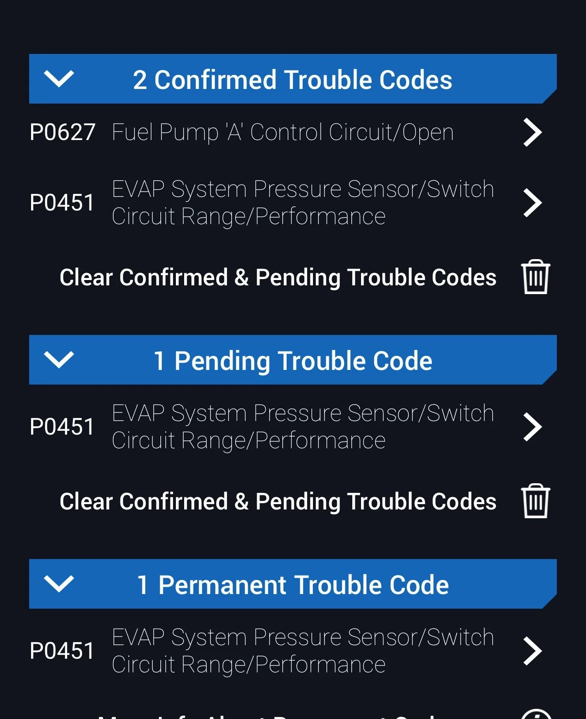

My check engine light came on. Used my scan tool to read these codes. My question is am I safe to drive the car with these codes indicated? Emira codes.webp
I had a P0451 on another car and a new gas cap fixed it. Sometimes can just be from a gas cap not being tight enough.
There really is no "gas cap" on the Emira, There is nothing to tighten, Fuel filler is spring loaded
My check engine light came on. Used my scan tool to read these codes. My question is am I safe to drive the car with these codes indicated?View attachment 72681
If you have the V6, there was a TSB/Recall for EVAP hose. If you've never had that done, that could be related.
