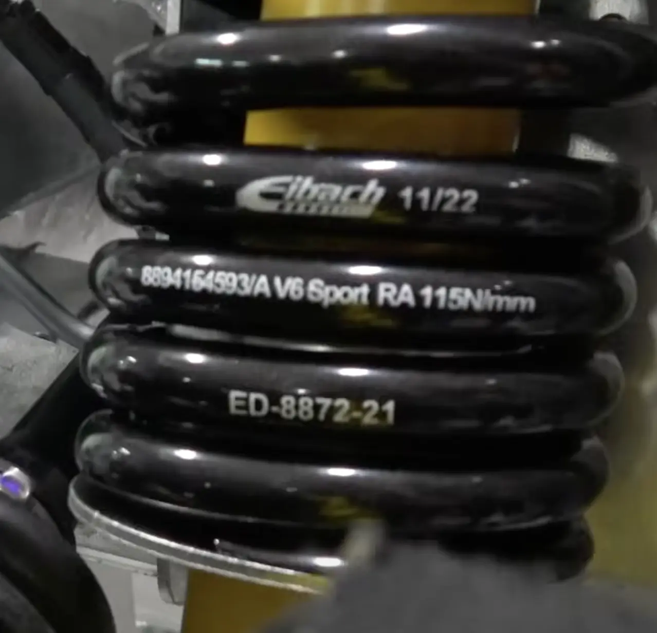

I'm looking at buying an Emira (used) and wondered how you could tell if the car came with sport or touring suspension. Can't find that info on the window sticker. Thanks.

Both springs and dampers are labelled sports or touring if you need to check.
