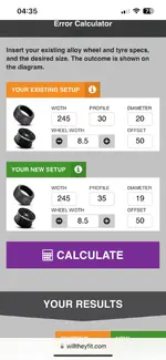

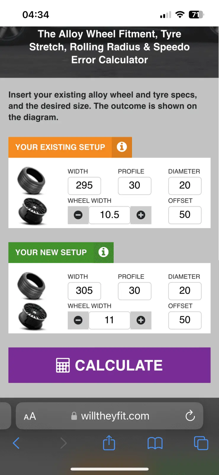

I know this and been discussed within various wheel topic but I thought it would be better to have a dedicated thread.

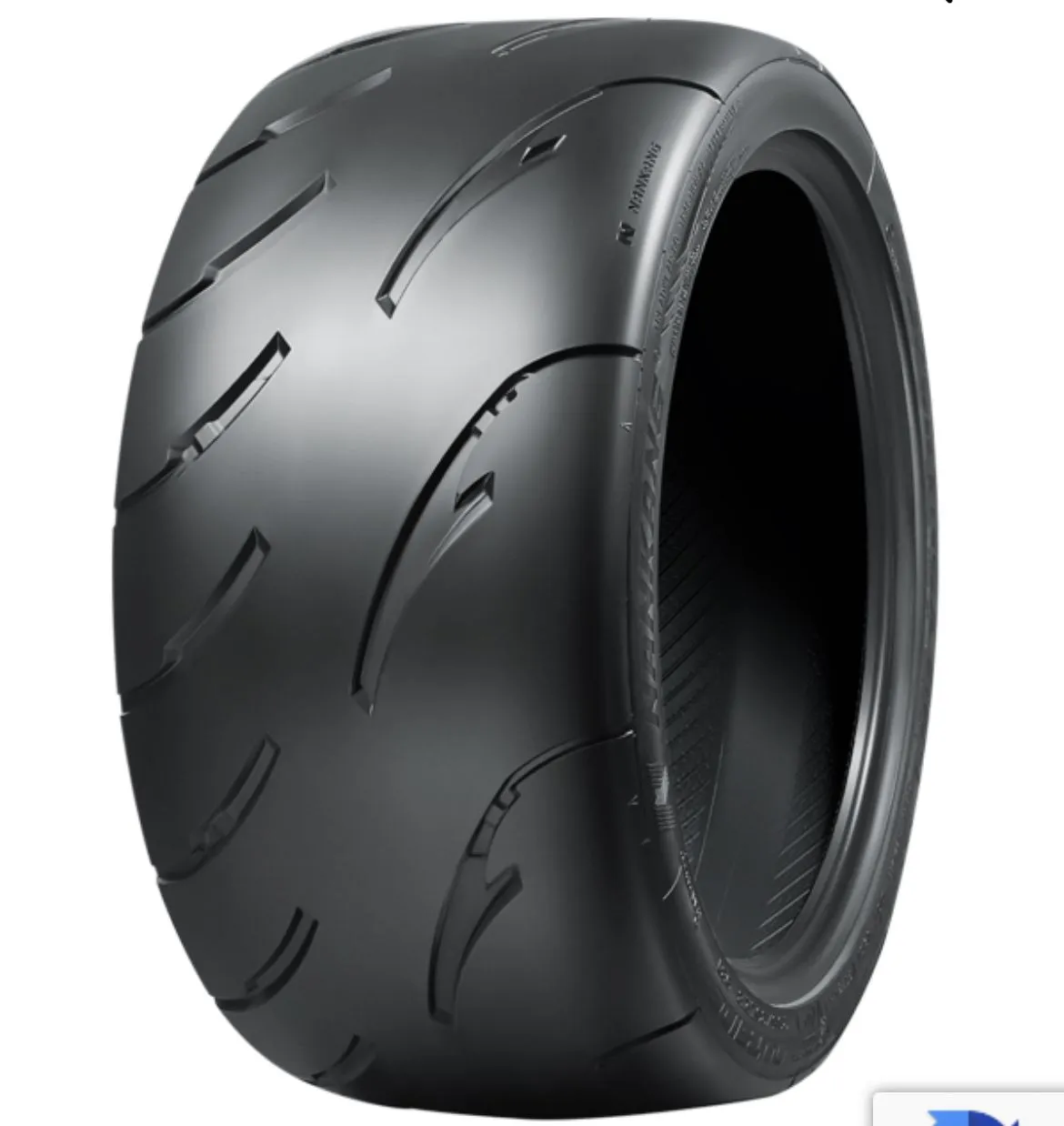

I have been doing some research on tyres to see if there is a road legal semi slick that performs as good or better than the Michelin Cup 2. The only one I can find that does any sizes close to fitting is the Nakang Nr 1 which is a proven track racing tyre that is just about legal for the road.
I remember someone looking for a set up with a 19 inch front and a 20 inch rear. Due to availability of tyres this looks like the only way to go and the closet match I have found is:

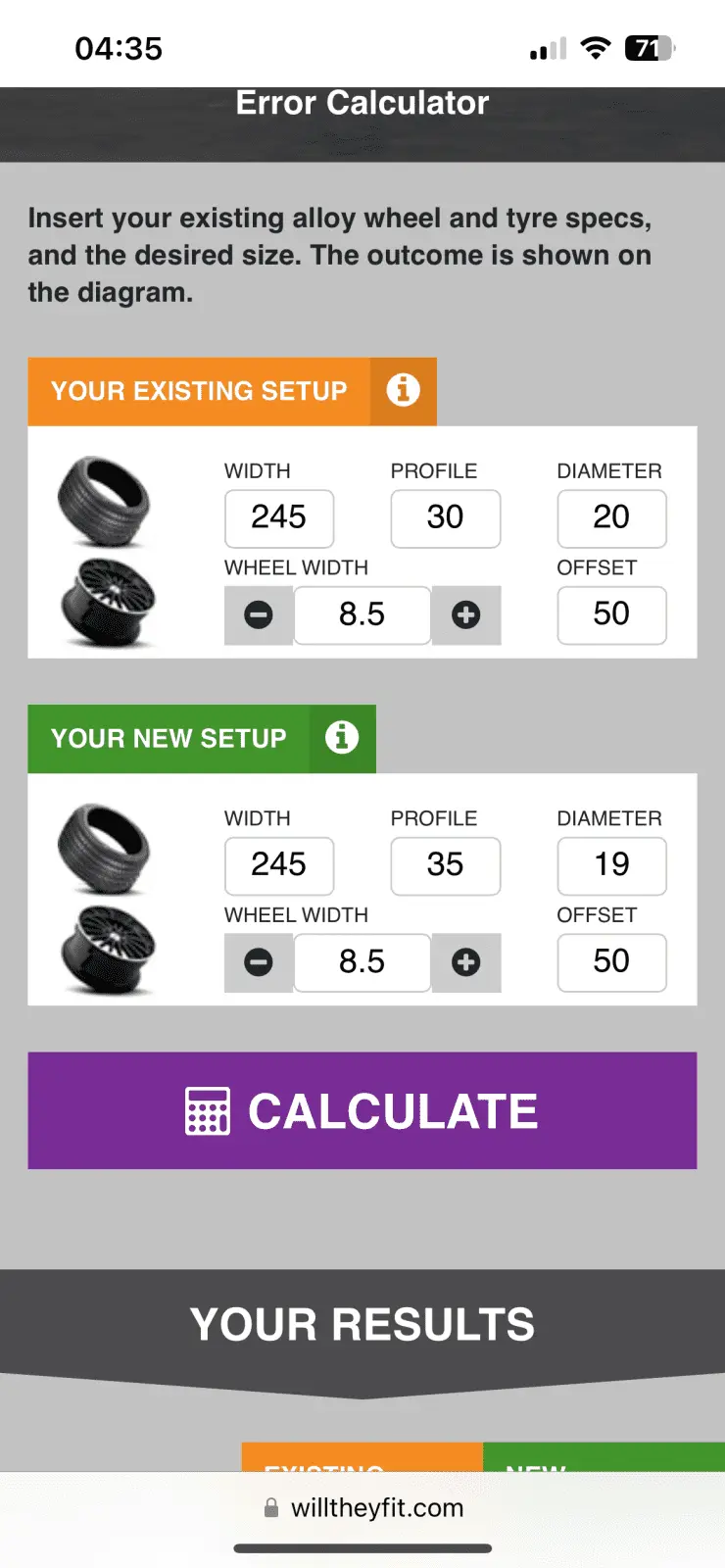

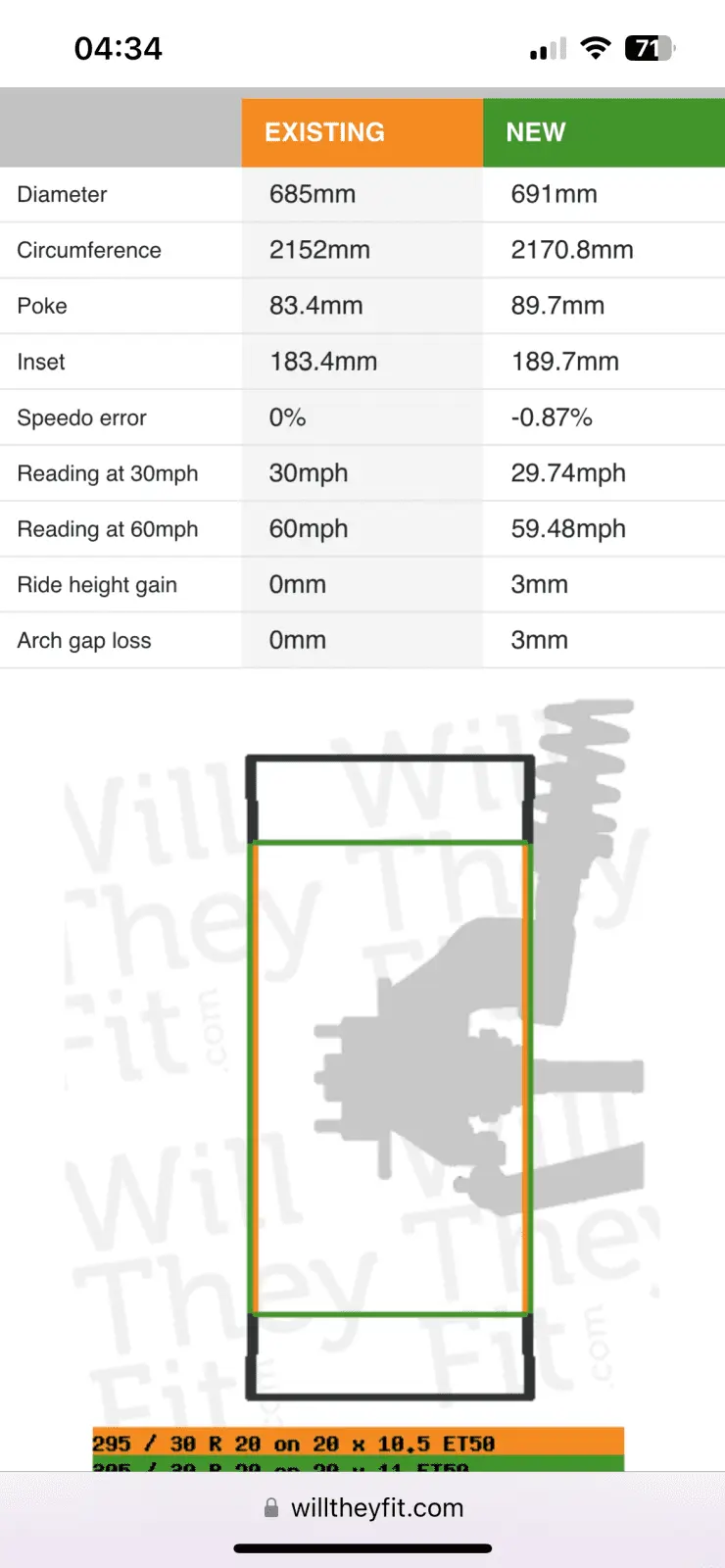

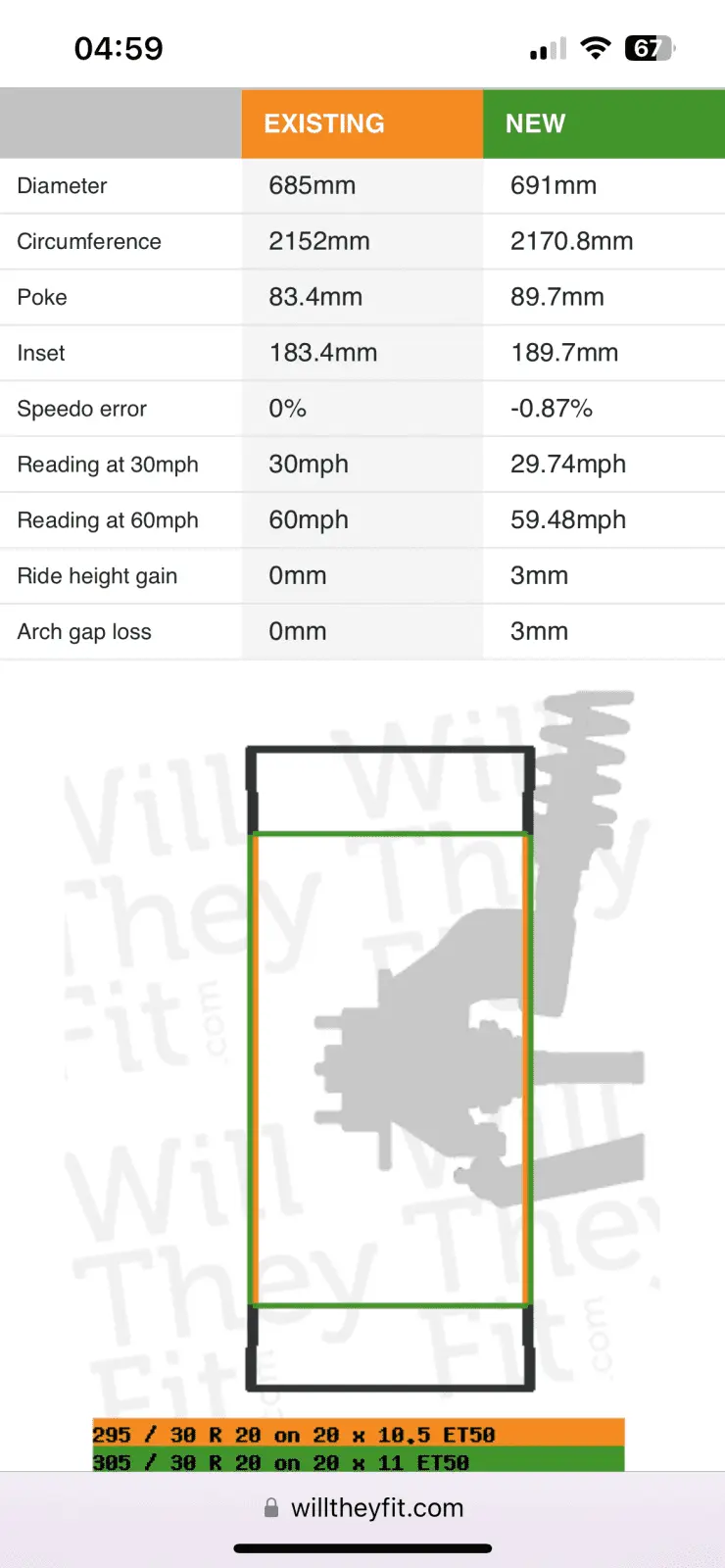

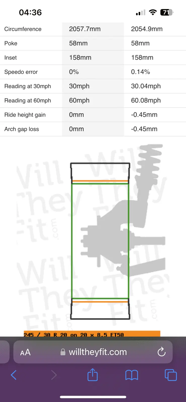

Front- 245/35/19
Rear - 305/30/20
Below are the calculations from ‘Will Tgey Fit’ to have a look at and comment for good or bad. I put the offset at 50 for all combinations to start with just for a comparison on the same size and understanding this will be changed depending on the wheels chosen.
