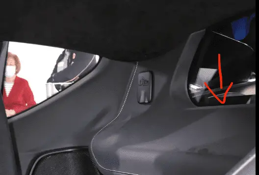

While driving have your passenger wedge their fingertips into somewhere along the back glass and the trim and then firmly pull forward. It seems to have "come loose" somewhere and vibration constantly produced noise I had trouble pinpointing. Doing this fixed it. You can do it stationary but driving helped me immediately hearing the change.
Not sure if this covers anyone here, but maybe give it a shot.

That sounded like a loose clip. Good tip for those experiencing rattles!
