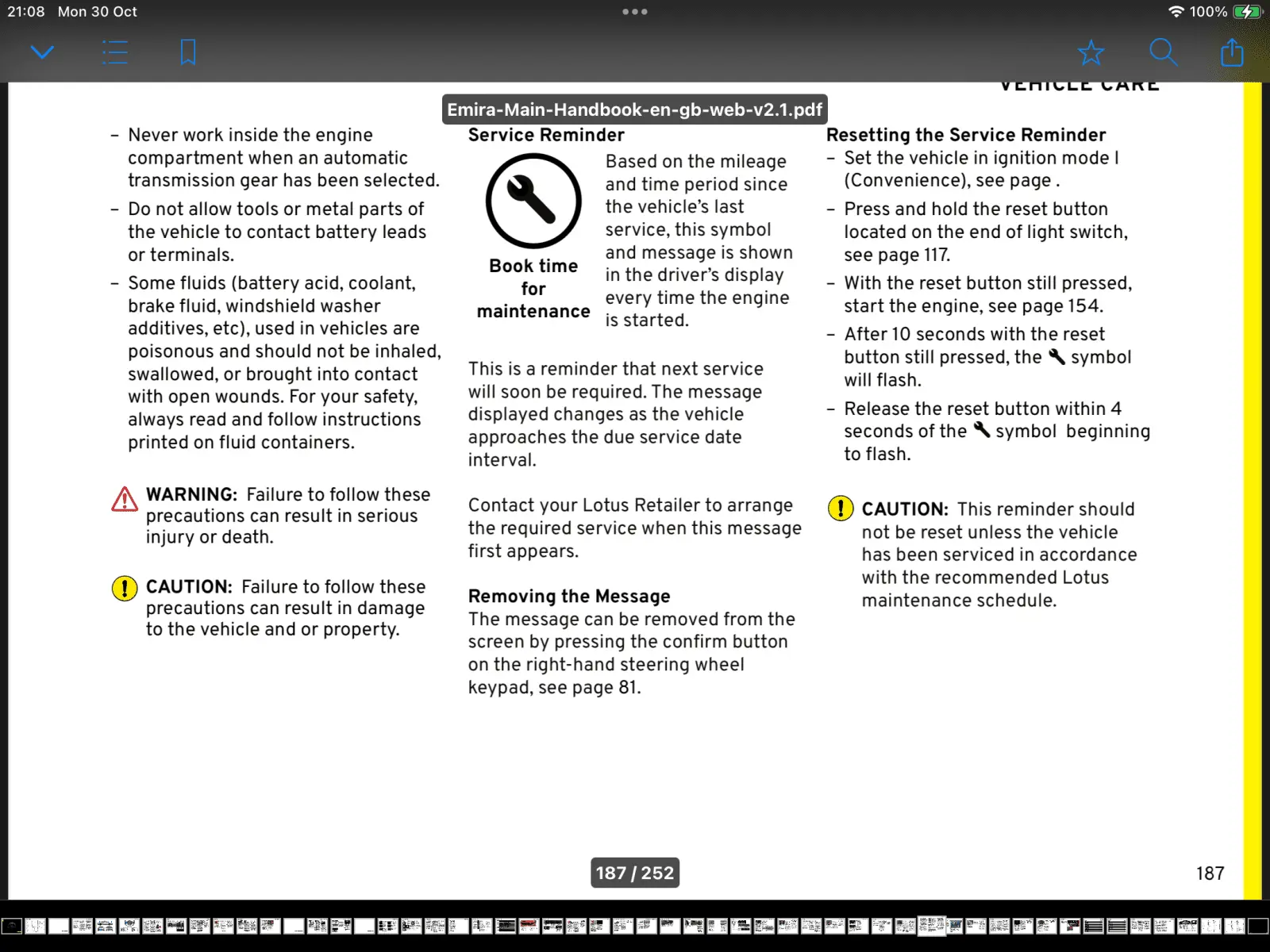

Just picked up my Emira from Lotus Silverstone last week.
I noticed on Sunday that the Service Counter on the days has not been updated.
Surely it should read e.g service due in 10k miles/365 days
However it has remained the same as when I handed my car in.
Anybody else with this issue??
I suspect that they’ve just forgotten, but according to the manual you can do it yourself and save a trip back :
Thanks for this! Much appreciated! I am going to leave it for now and let them sort when my car has to go back in....

Same here, thanks fro the procedure! I'll try it today, from the dealer they said it is software bug, I'll try your suggestion
It worked! I hope it stays away until next service is due 😅
