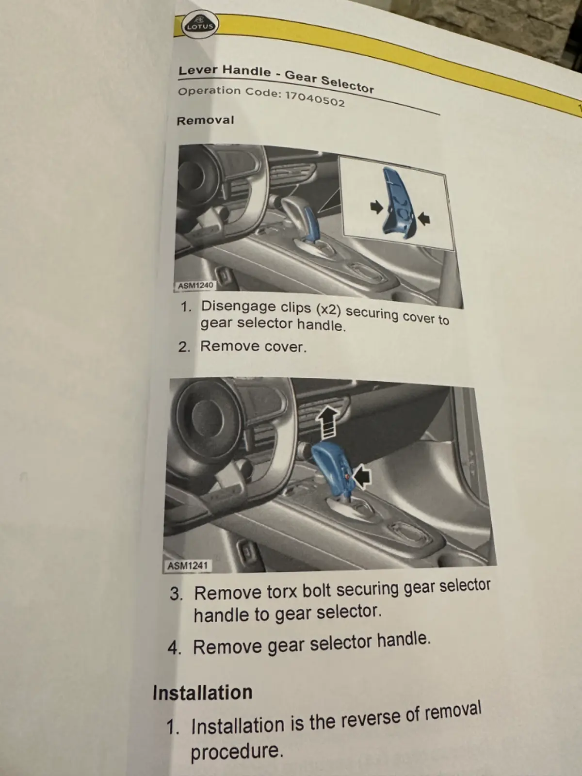

It took me awhile to locate, but page 17-11 of my Emira “service manual” mentions removal of the “lever handle - gear selector”. See attached photo of that page. That’s all I found for you.

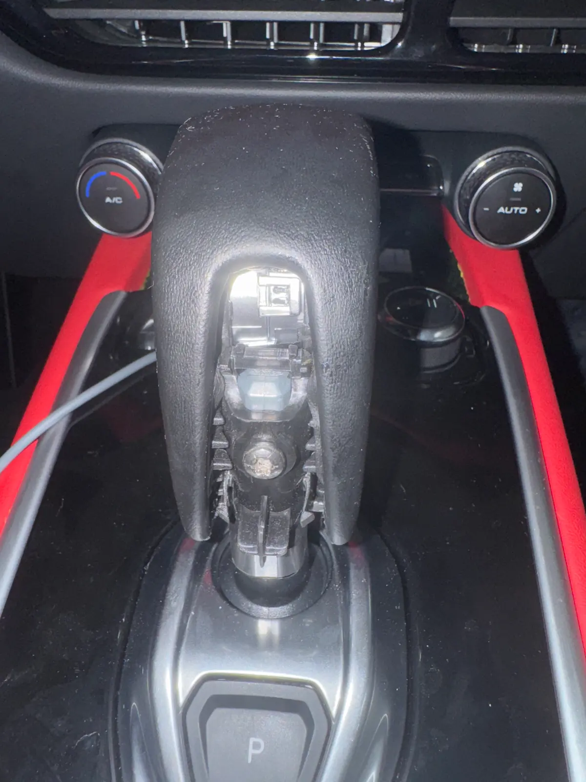

I don’t know how to gain access to the 2 side screws. They are cover by a plastic piece…
The plastic cover should just pop off. Under there is a set screw that allows removal of the knob.
