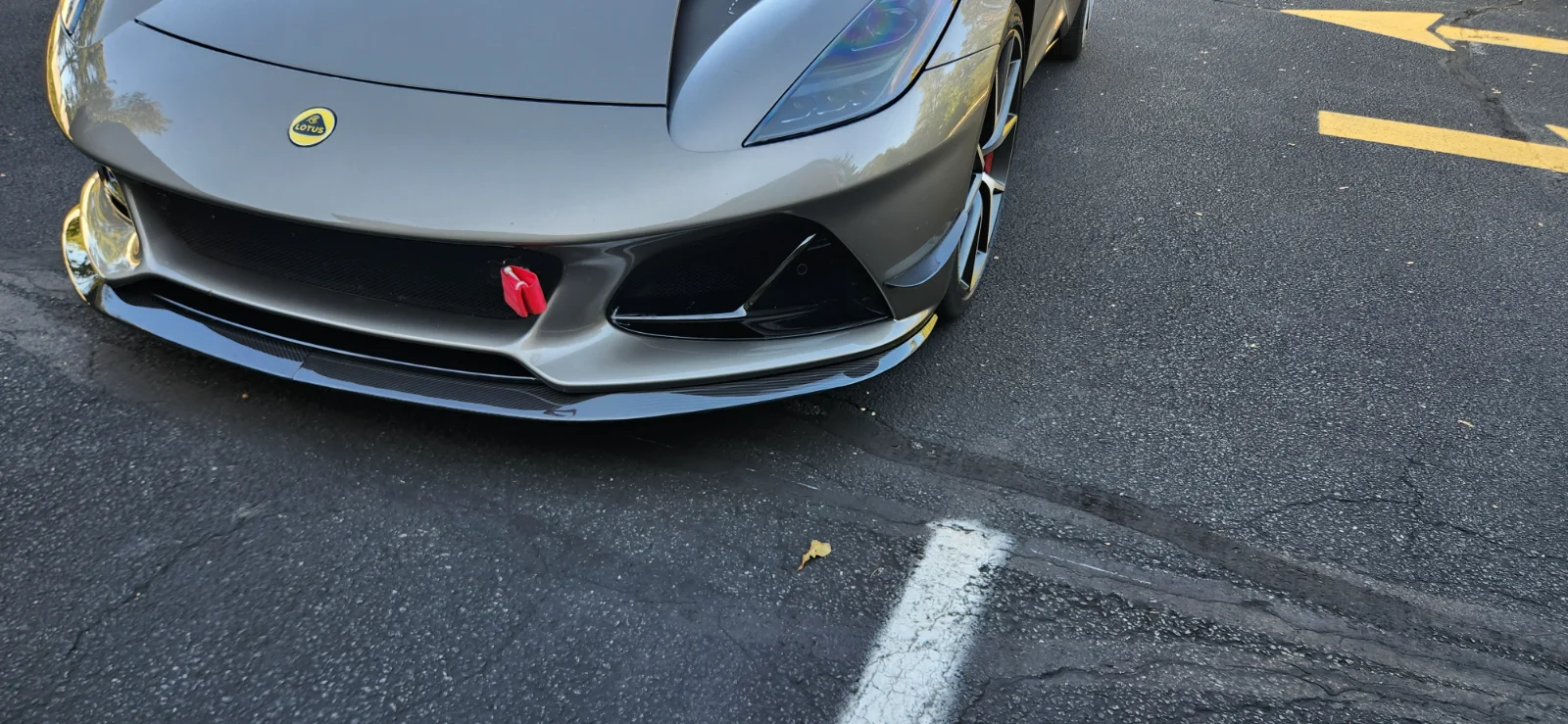

Hello everyone,
Big problem with leaves, acorns and other debris getting in the front between the front splitter and the mesh on the front bumper. It is not covered with a mesh. It accumulates on the 45 degree radiator at the base of the firewall.
1st. Is there a solution to block the debris with a mesh?
2nd. Can I access the area to remove the debris? Hopefully from the top, because I have a front splitter installed from JUBU. It would be difficult to remove that every time I needed to clean it.
Any ideas?
Thanks in advance!!
Steve (non-mechanic)

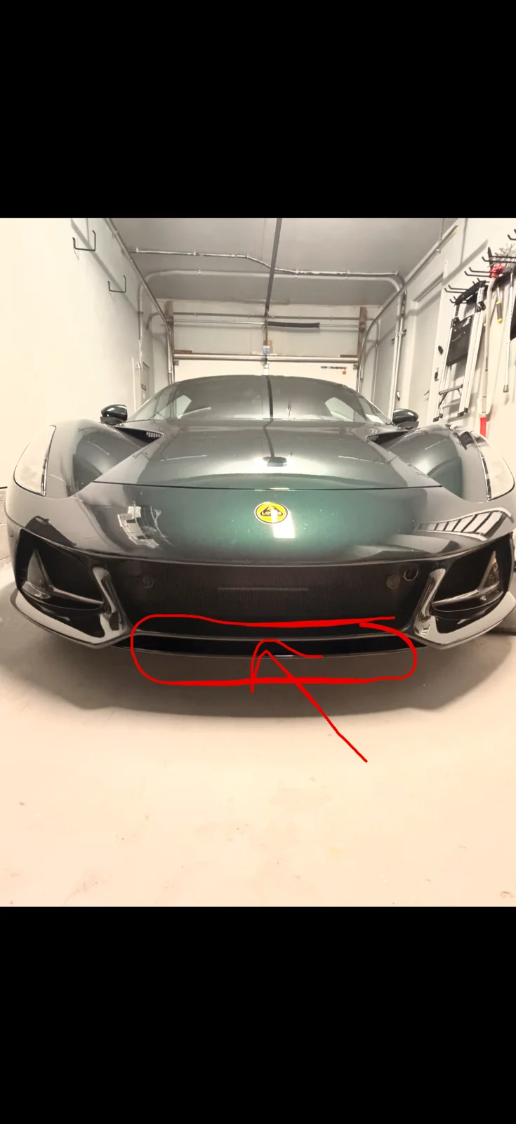

I use a grabber tool for the the debris.. I go through the front opening on the stock tiny splitter.. whatever you want to call it. It looks like you still have that opening even with the Juba splitter. Attached Amazon link and pic with red circle of where I go through to get into there. Hope it helps.
NoCry Premium Pick Up Tool Set —... https://www.amazon.com/dp/B07D23M5R7?ref=ppx_pop_mob_ap_share

That is it!! I will try your suggestion. Thanks!!
