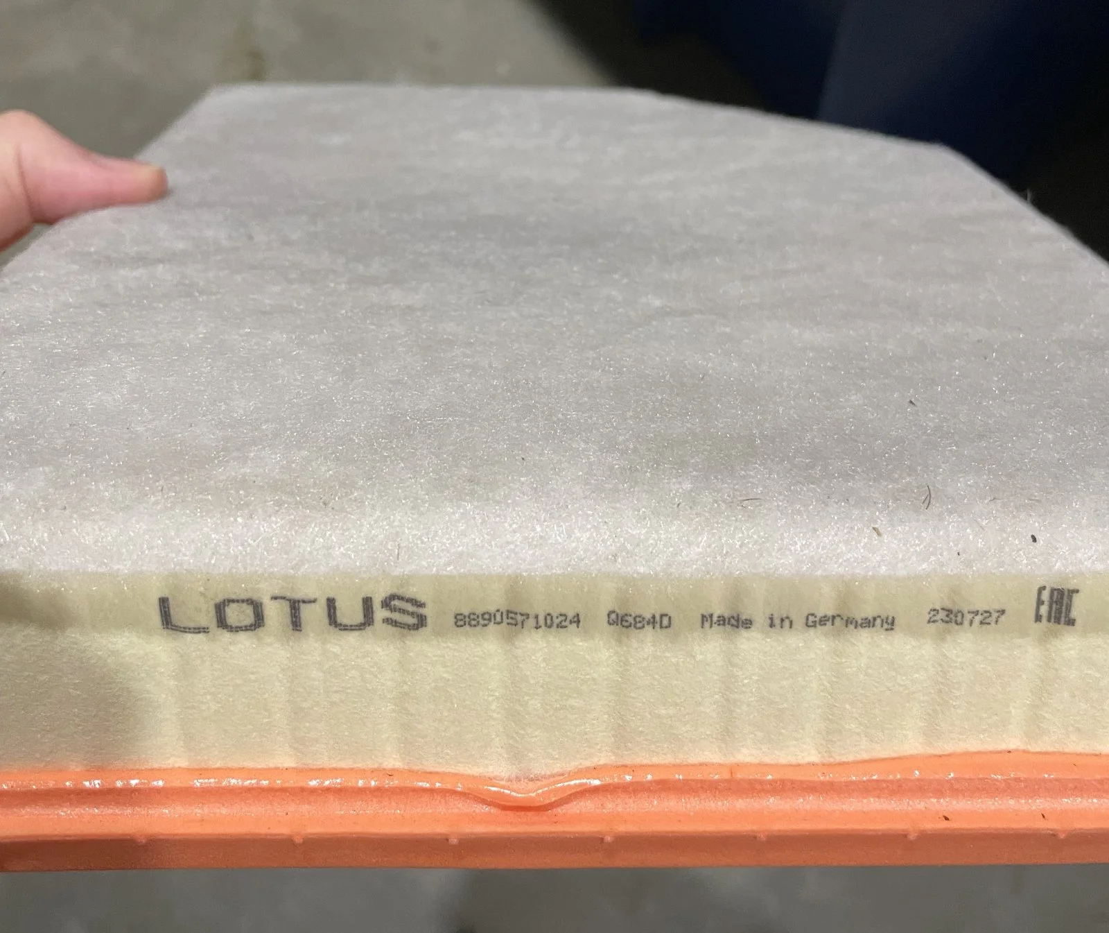

The stock air filter has a thick gauze pad on the back which to my mind has to be fairly restrictive to airflow. Obviously it needs to filter out anything coming in through the side of the car, which is its main purpose, but after installing the Eventuri, I immediately noticed the improvement. The engine starts, idles and accelerates much more smoothly now.

It doesn't look like a charcoal filter. It might be to stop bigger things like leaves, bugs, dirty water or things kicked up by the front tires, etc. but it has to have an effect on airflow.

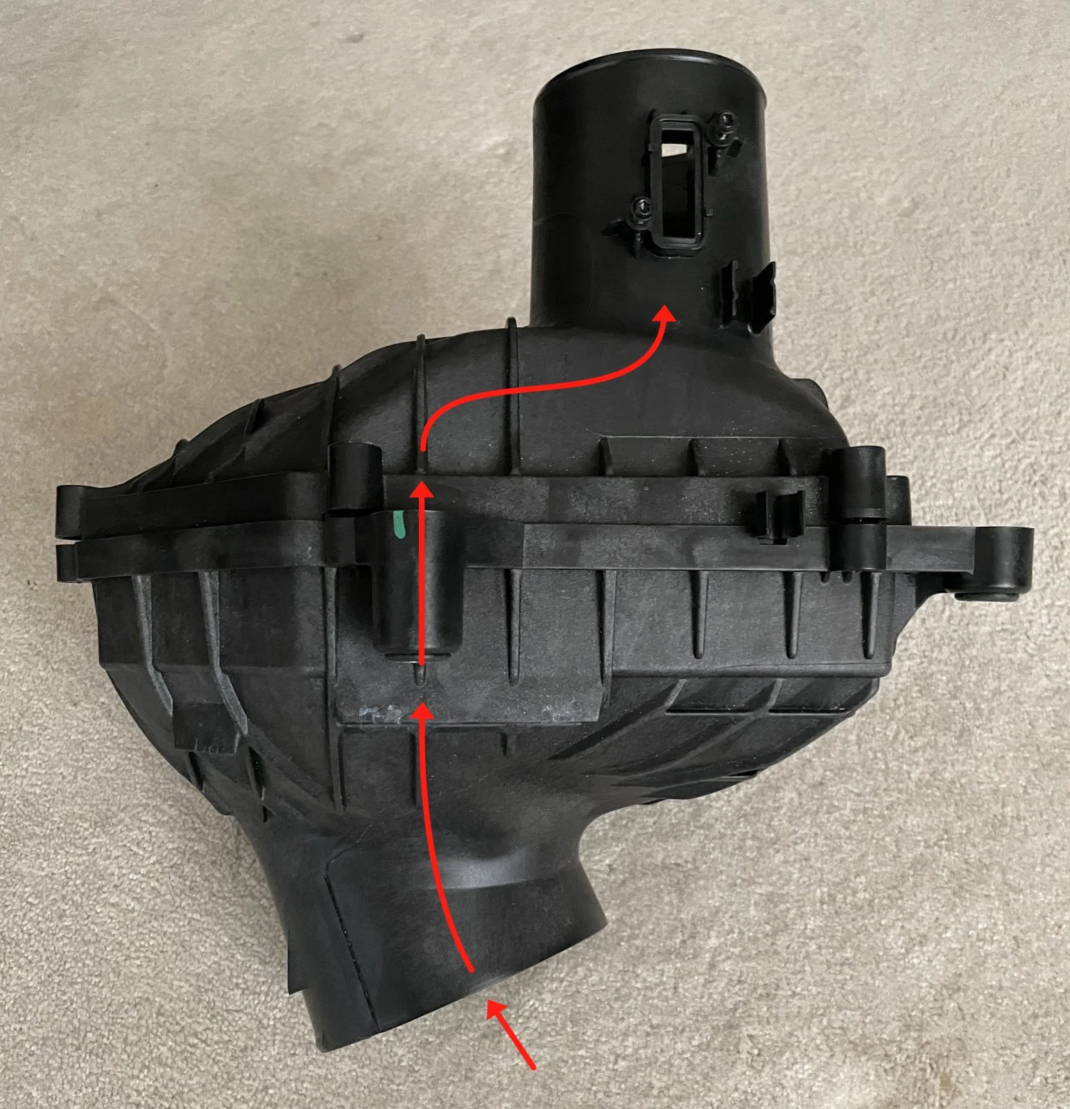

The Eventuri is a straight flow-through design. No hard turns or sharp corners. The inside of their silicone connecting tube is also smooth inside. The factory airbox, even with a less restrictive air filter element, does not provide a straight path for airflow. Here it is from the top. The arrow at the bottom is where the air comes in from the side of the car. The thick section in the middle with the short arrow is where the air filter sits, and the gauze side is facing the intake hole. After the air leaves the filter, it has to make a hard right to left turn to go past the MAF which is in that rectangular slot at the top. (You remove it and put it in the Eventuri when installing the Eventuri).

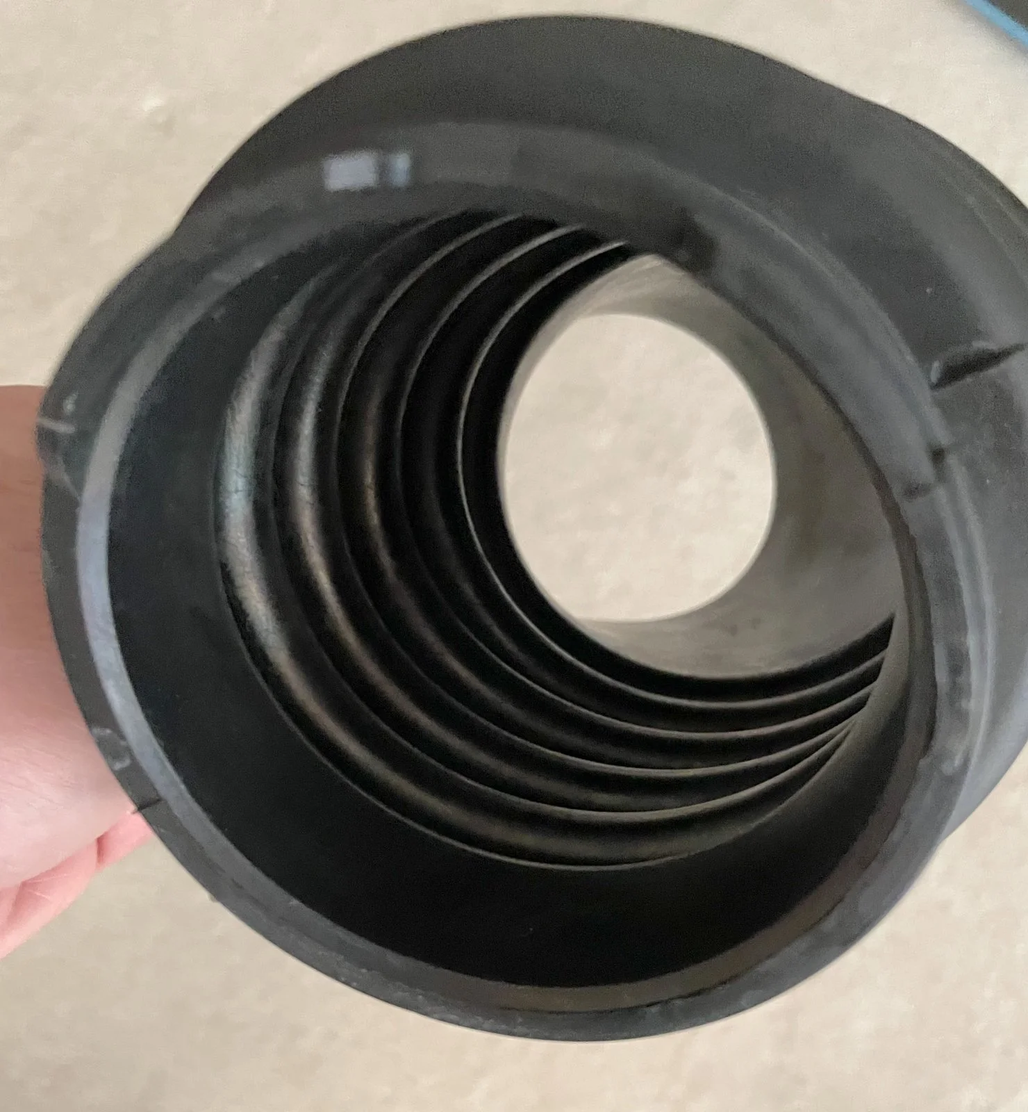

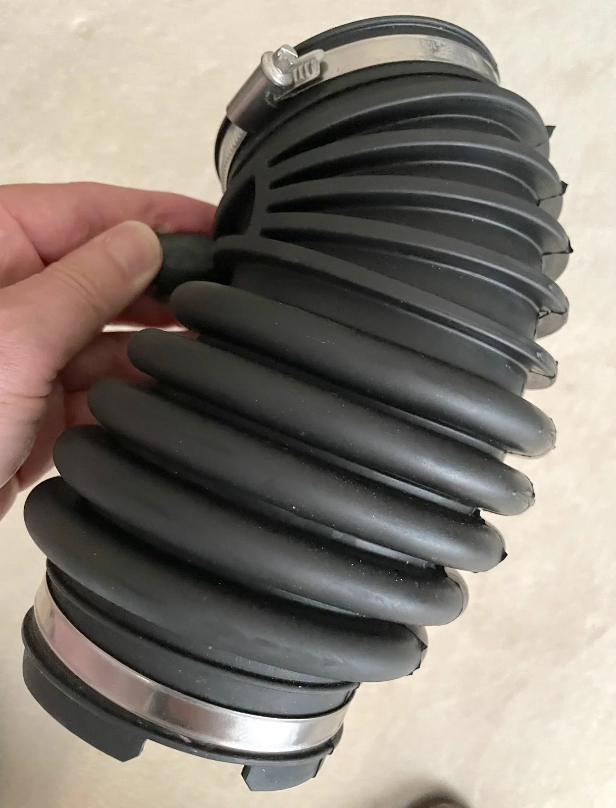

After the air exits the filter box, it goes into the silicone tube that connects the box to the supercharger. The inside of this tube is a series of grooved ridges which the air chops and bumps over as it makes another left turn through the tube into the supercharger.

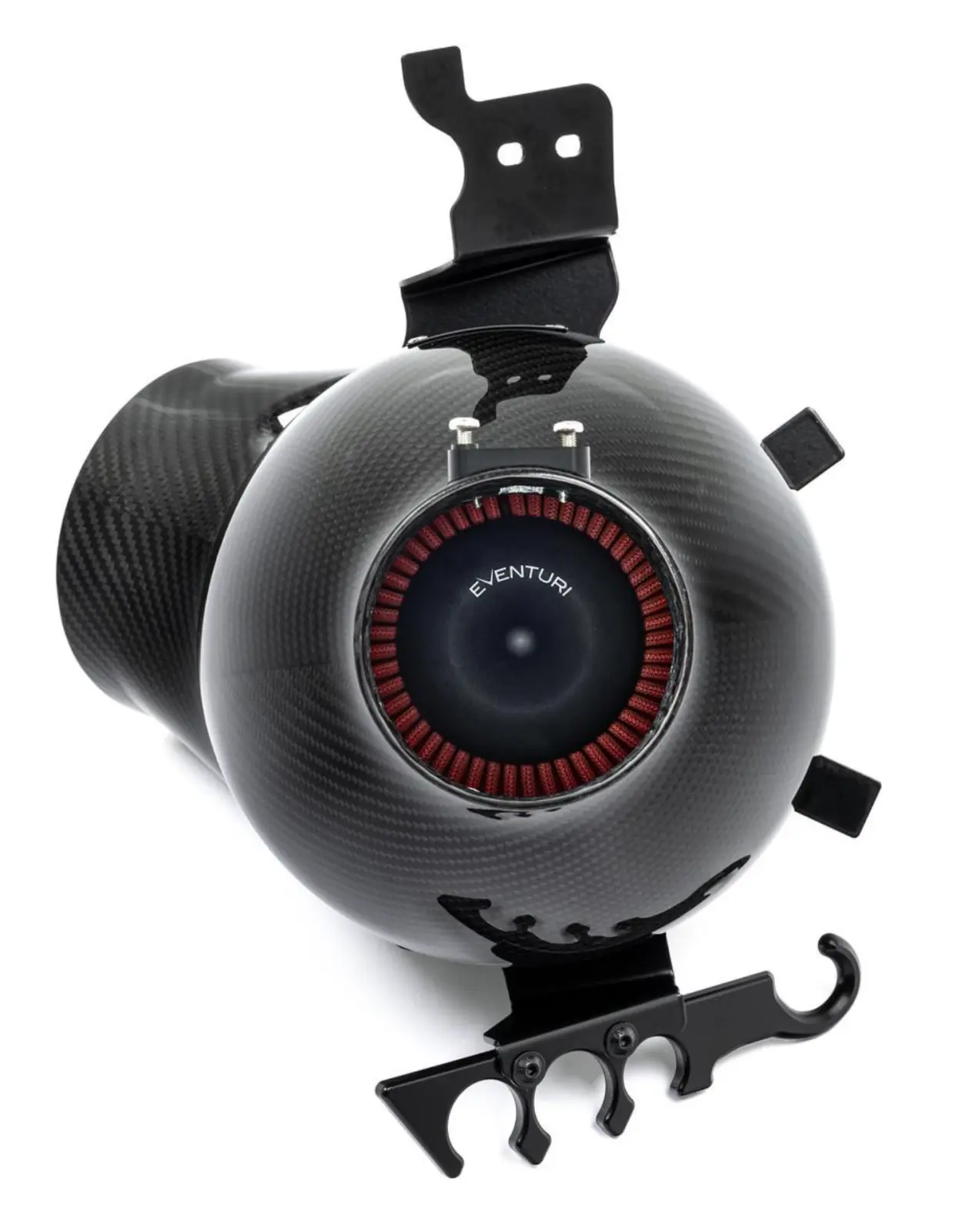

The Eventuri is a straight, smooth flow-through design; no ridges or bumps inside. Here you can see it from the end where the silicone tube connects it to the supercharger. The air comes straight out of the filter and into the tube without having to make any turns. The 2 silver bolts at the top is where you put the MAF sensor, which sticks down into the airflow.

So it does more than just improve airflow through the filter element, it channels and directs airflow all the way through it from entry to exit into the supercharger.

How do you remove the gauze? It appears to be part of the air filter. Do you need to just replace the entire filter? Does Lotus require the use of only their bespoke air filters for this reason?

I tried without the "gauze". It made no difference to sound or power than I could notice, it's pretty much just loosely glued onto the OEM filter.

Read in the other posts that the gauze could potentially help keep moisture out of the intake/MAP. That seems reasonable.
