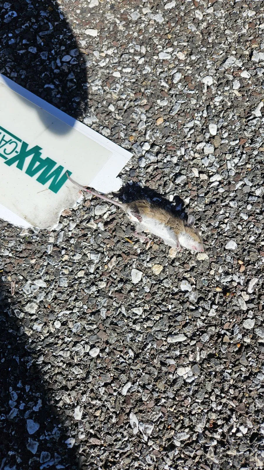

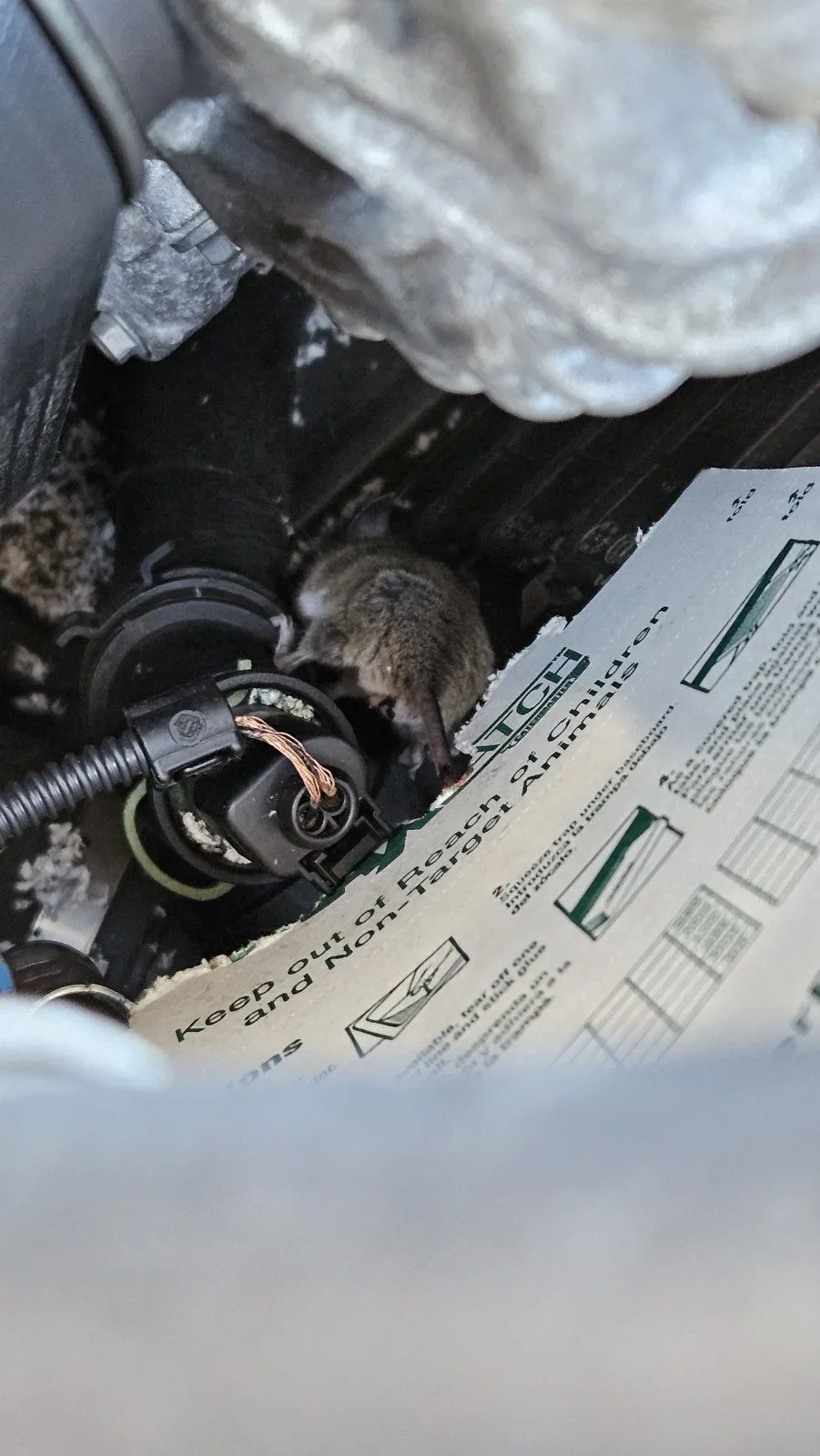

Anyway, I just came home from a hiking trip in the White Mountains of New Hampshire and found evidence of a mouse living in my GTI's engine bay. Thankfully it didn't make it's way in through the cabin filter, but it did destroy my battery cover and left some nuts in my intake heat shield. I guess this sort of thing happens when you park outside and it starts getting cold out. I wish I had a 2 car garage, but sadly the GTI got kicked out when I got the Evora GT.
Welp, solved the mouse problem in my GTI (for now). I had various traps laid out, including a glue trap on top of the engine cover. Sure enough, yesterday morning I pop the hood to check and the trap is gone! I found it down near my radiator stuck to one of the hoses with this little guy hanging dead from it. Looks like he got fried trying to chew free and bit into the rad temp sensor. 🙄 I'm just happy I was able to shrink wrap and repair the sensor wiring (and it didn't happen to the Lotus!).
