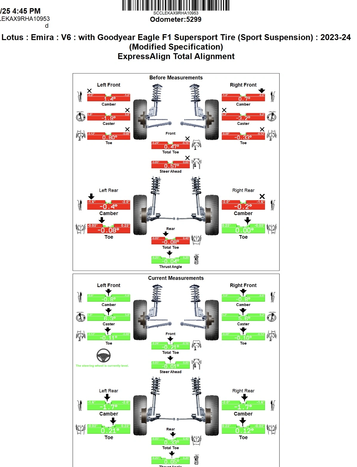

Ever since I had the car it would have steering wheel vibration at high speeds. I thought it was from the hydraulic steering and feeling everything on the road. No it was because my alignment was terrible from the factory. I had it for a year. It was night and day after the alignment was corrected. Rides a lot smoother and I feel more confident at higher speeds.

Wow, that looks pretty bad. Positive camber in the front??
Even more concerning is the tow pulling to one side and the caster. Was this on an I4 or a V6? My guess is V6.
Edit: whoops just saw it was a V6. Was it dog tracking too?
What in the world happened to your alignment prior? WTF.
Legitimately the worst alignment i've ever seen on a car that wasn't crashed. You drove 5300 miles like this? I would be making sure all the suspension bolts and tie rods were good and torqued to spec too at that point.
Wow! It was so far off the previous alignment measurements were off the scale and just showed an X 😂
That must have been almost undrivable!
I wonder if they just forgot to do any type of alignment at the factory. Just bolted on the suspension and sent it out the door.

Came like that from the factory. It always felt off. Decided to just get it checked.

Yes, all Lotus are very sensitive to alignment. Yours was way off. I always tell people to get their cars checked - whether new or used. Glad you got it corrected.
