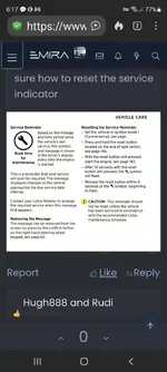

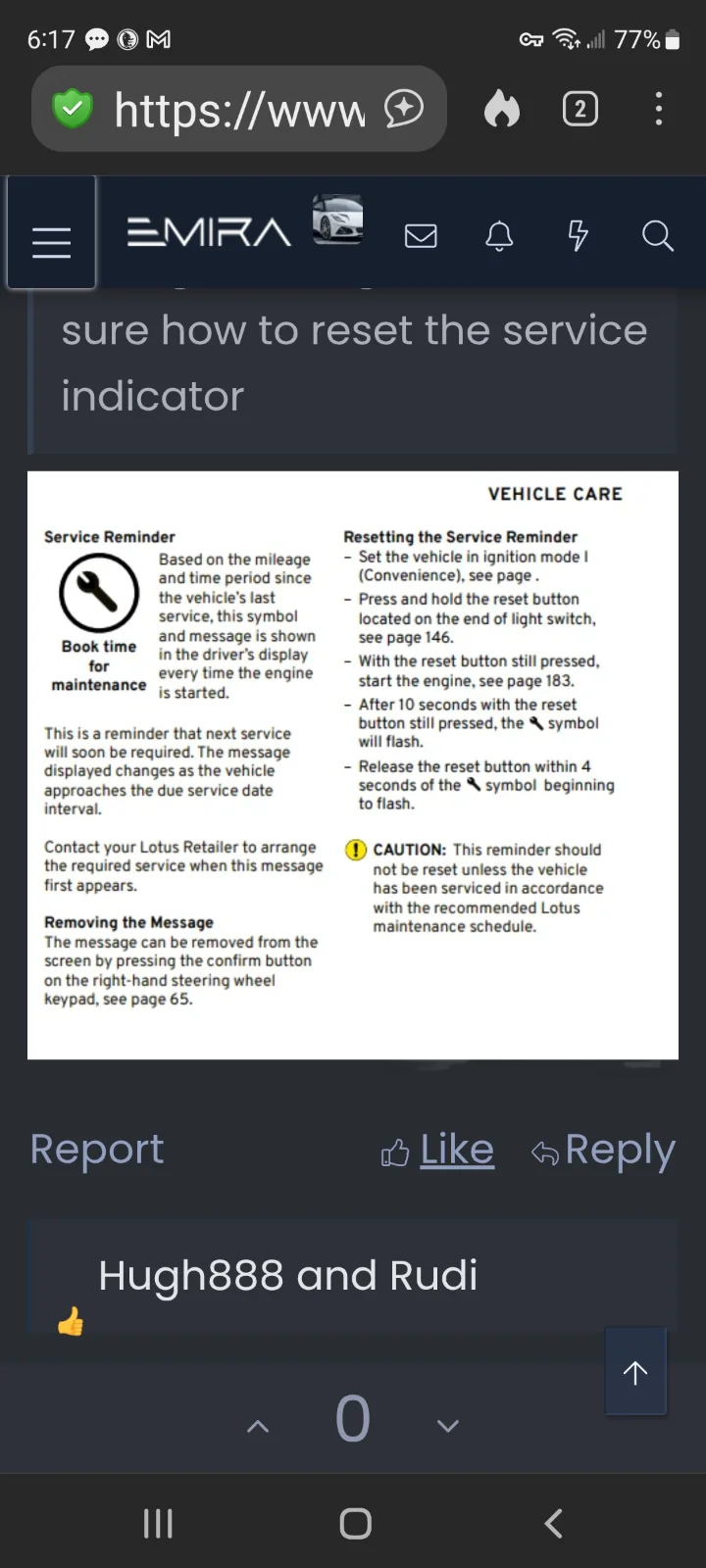

My Emira has about 2,800 mi and the maintenance overdue message just popped up. Since I did the 1,000 mile oil service on my own, I figure I can just clear this message. Does anyone know how to do it, or do I have to take it to a Lotus dealer?
From the manual...
Mine is also maintenance overdue but only 600 miles on it. I suppose it started counting down the days on the day it was built. I’m just gonna leave it on until I finish breaking it in and get it’s first oil change
In above screenshot, when symbol starts flashing, release reset button. Don’t wait 4 seconds.
