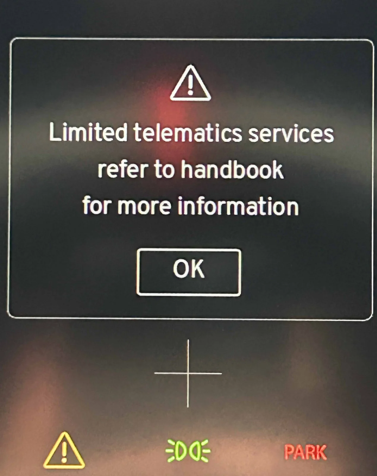

I got the Limited Telematics service advisory light today. The car had been sitting for about 10 days due to really bad weather. I spoke with my dealer service rep and he explained that the telematics system has a battery in addition to the car's battery. I'm told the battery responsible for telematics connectivity can not be charged through the trickle charger and only gets re-charged as the car is driven. He explained, "Drive the car and the advisory goes away." After about an hour I stopped for gas, and on start up the telematics advisory did go away. However this is REALLY annoying.
Two part question for the group...
1. Can the Telematics battery be replaced and if so has anyone done this? Where is the battery located and what type of battery is it?
2. Can the Telematics system be completely disabled by removing a fuse or coding the ECU?

Back to square one...The II Active on charging method doesn't work. Started the car this morning and the telematics advisory is back. Car is going to the dealer on Monday for warranty repair.

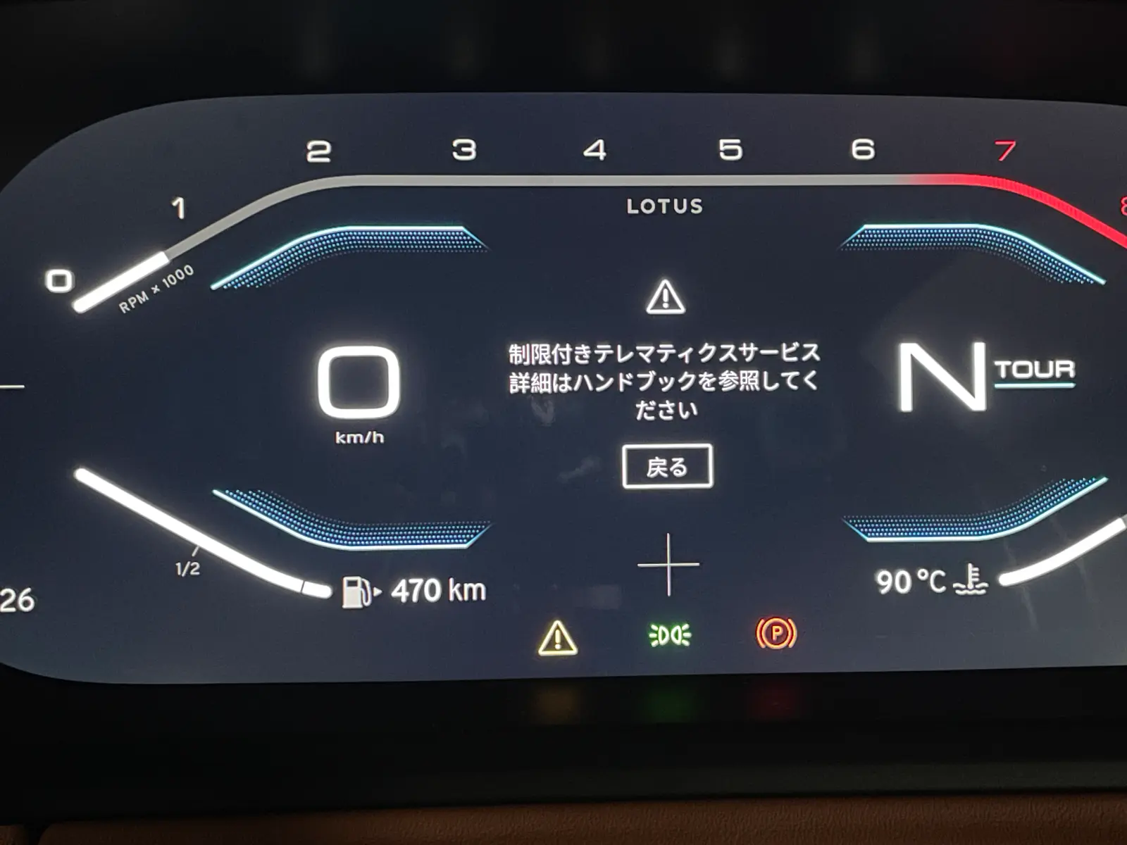

Same error has occarrd on mt Emira.
