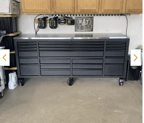

Should be here in about 10 days. Largest toolbox I could find. I have a 90 inch work space I needed to cover, and this is 84 inch and should be good enough!
Excited to purchase this and have it setup in my garage. I do all my own vehicle work/maintenance and having everything organized will be great. Currently working out of 2 toolboxes! Garage is about 1,000 Sq feet with a 300 sqft back area for storage.

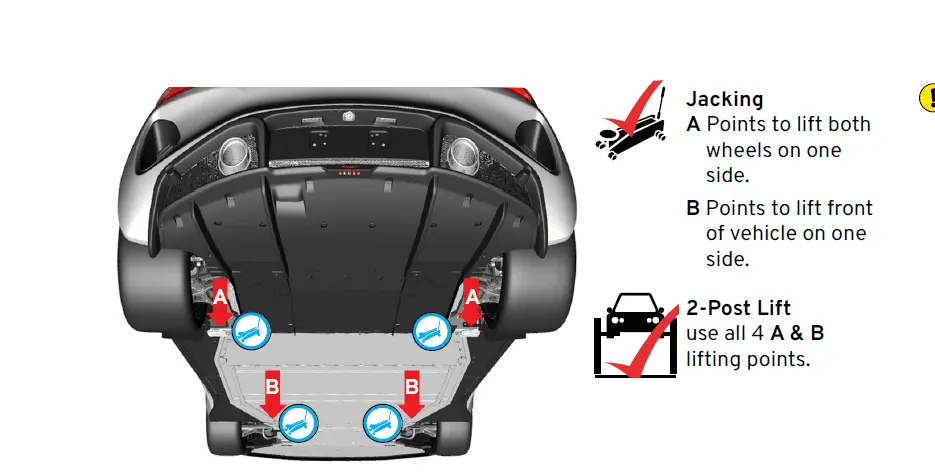

I have fears about a 2 post lift with the Emira because the doors are extremely thick compared to most 2 door sports cars. The sculpted shape to accomodate the aero along with an easy ingress/egress for the driver results in a pretty thick door.
I noticed the Emiras rear lift points are not inline (from front ones) so something similar may be required.
Anyone with an Emira care to measure the distance from B to B(front) lift points.
I was just looking at this last week and would love this information. Based on the Evora, it was pretty long and required the longest base Quickjacks (also the most expensive). And running them perpendicular to the car and not parallel also had issues with making contact with the wheels.
We really need a diagram of the jack point locations, distance between them, and distances inboard from tire center line and tire inner edge. Without that info it will be pretty difficult to figure out whether any scissor-style lift would work on this car.
Technically the car can be lifted by more than just those 4 points, but it's exceedingly useful to know whether they can be used safely on a particular lift.

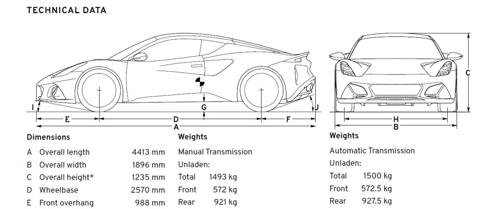

I am concerned about my lift reaching the front lift points while maintaining the balance so I computed where the CG is (not Lotus official ;)). Once find out the B-B front width can see if my lift will reach those points. This diagram should be helpful for others too. Its in the manual..minus the cg symbol.
Basically the CG is where the door handle is. Pretty typical for a mid engine car. Some cars have an arrow on bottom where it is.

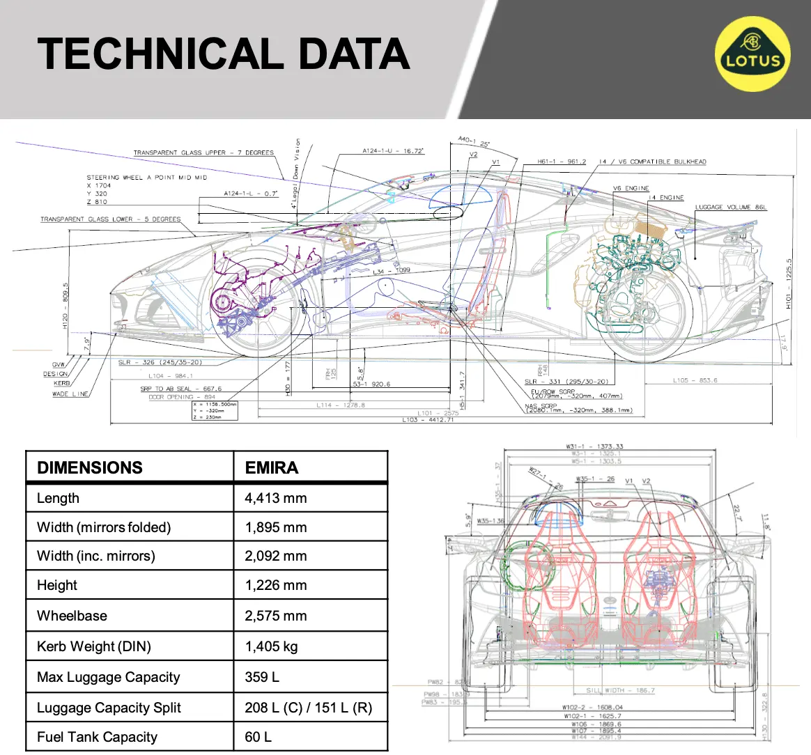

This diagram floated around last year as well. Lotus clearly has a ton of technical diagram data in-house, we just need to request the relevant info from them. I'm going to reach out to LCC and see if I can get them to provide guidance on the jack points, preferably with a diagram.
