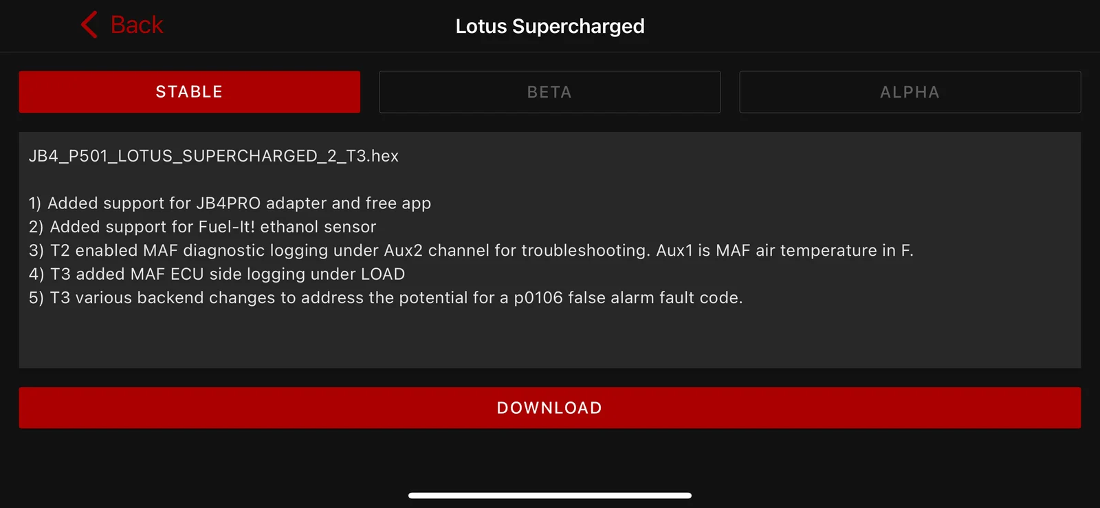

Hey guys. Installed a JB4 in my car (manual V6) last week. Car is running great but I'm randomly getting a P0106 code which the car into limp mode. I've checked the connection to the map sensor multiple times and it seems secure. Anyone else run into this?
Have you went sent your data logs to them to have them check how the car is running? And, if you clear the code does it return?
