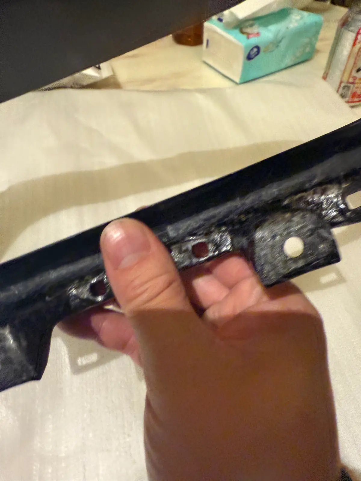

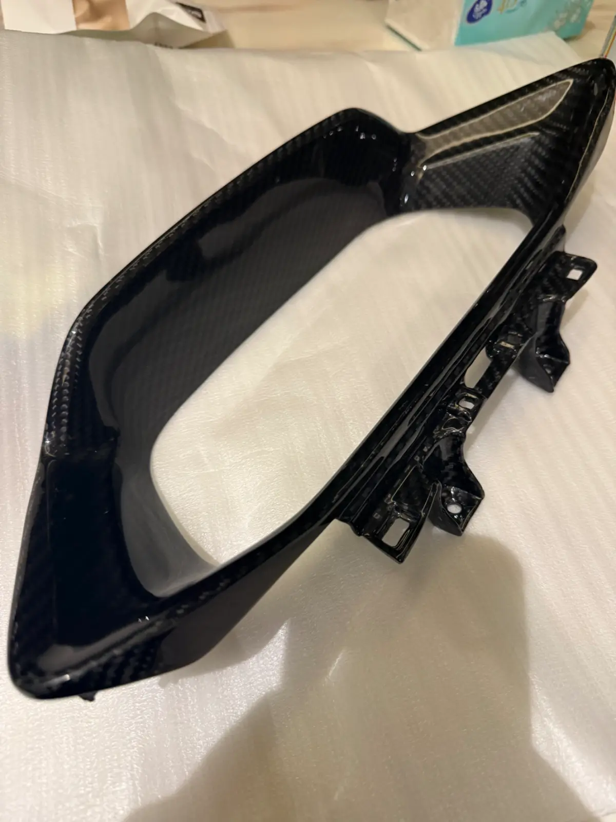

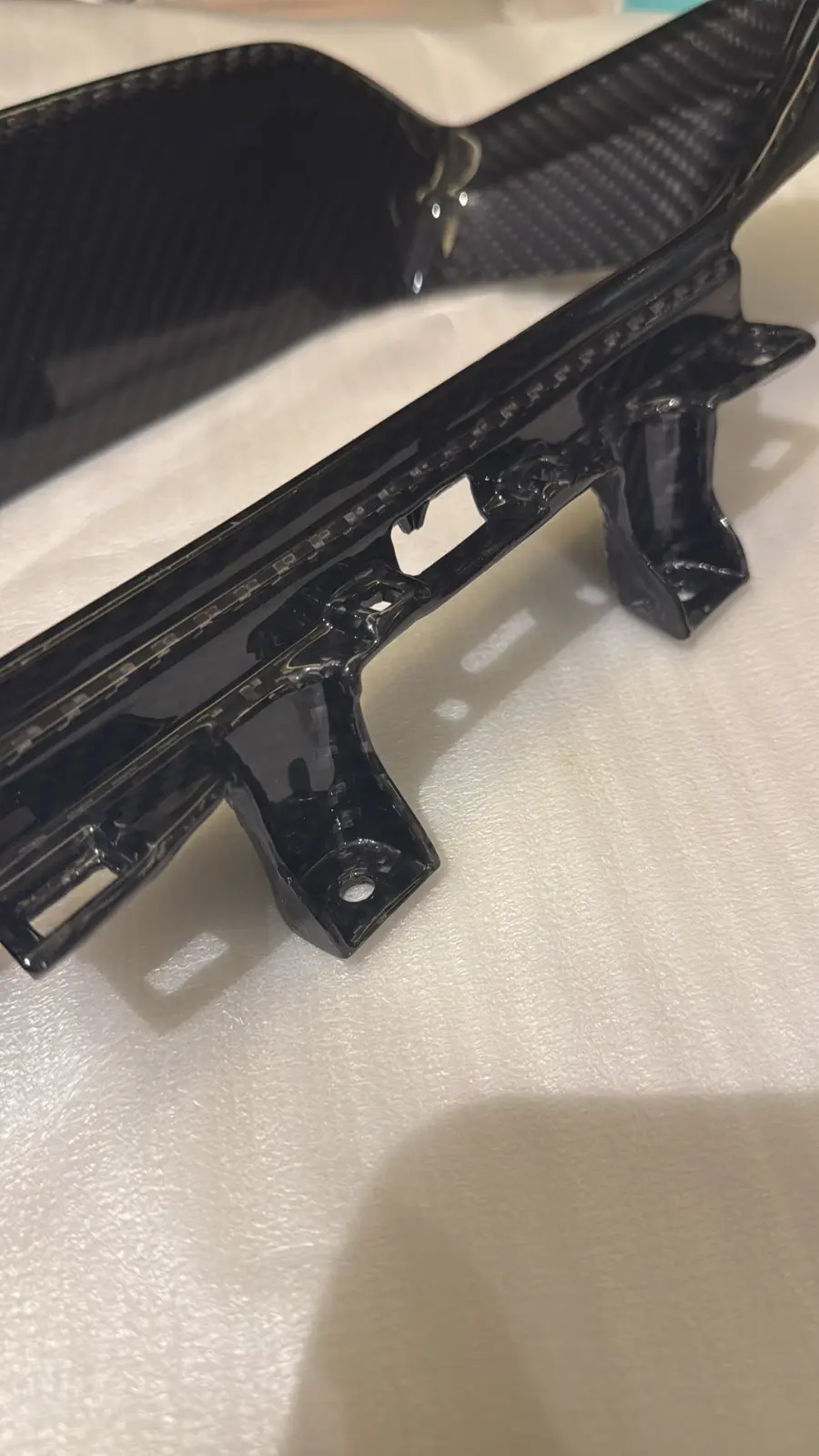

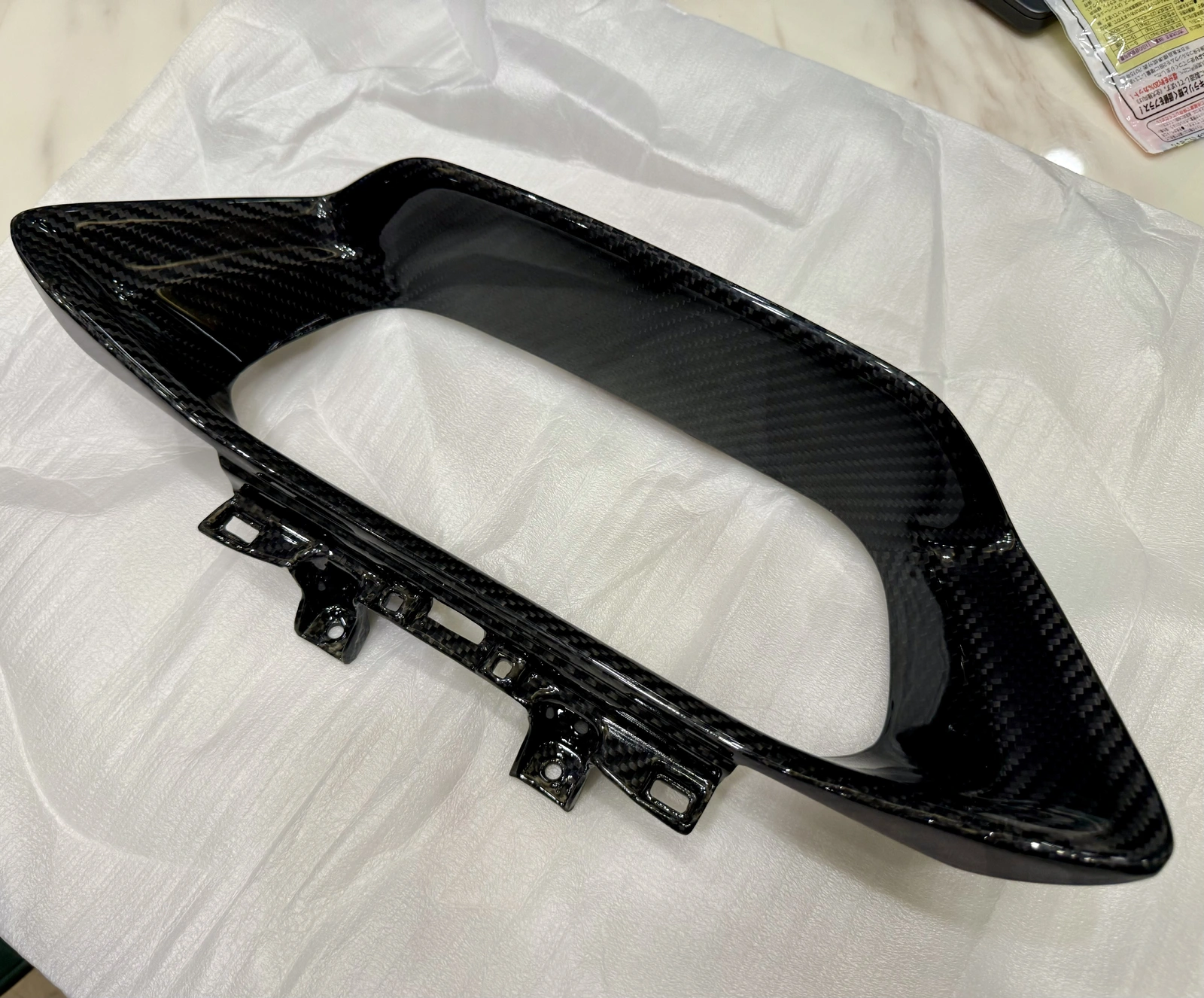

We have a replacement parts with full brackets install just arrival with DRY carbon made .
