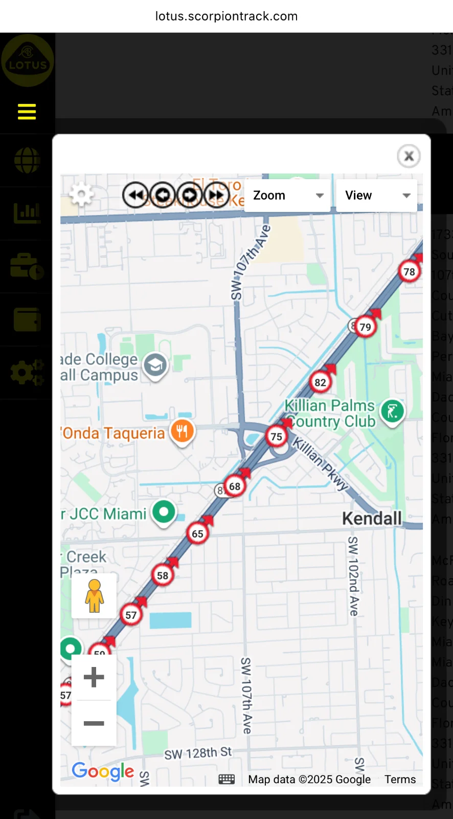

Not sure if this will help you BUT -
My car came with the tracking thing from scorpion and for me the first year was free (actually just paid for 3 more years). It is very detailed and records all of the driving logs. I can see how fast I was going during every drive I’ve ever been on. I’m almost certain you can do advanced searches and see more detailed info.
I only enable the speed logging when the car goes into the garage or not being driven by me.
It doesn't record engine revs though.
