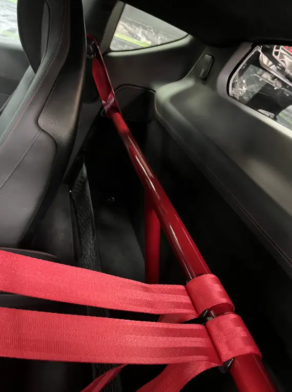

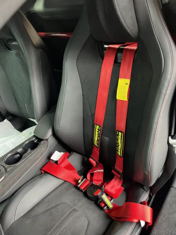

Painted Magma red to match the car and installed by www.gabrielsportscar.com
Looks great! Going to buy one of these for my car soon too.
Install was pretty straight forward?
Reactions: GRP
Is the seat pass through wide enough where they arent rubbing into your neck?

The car has a built in roll bar already, its hidden under the B pillar trims and the roof liner. If it was a metal unibody car like a Porsche it would make sense to add one but in the case of the Evora and Emira it would be redundant and not really needed unless its a full blown track or race car.
Will carry-on luggage still fit under the horizontal bar?
Can't tell how substantial it is. Any more details? Or better pics? Glad to learn it has one tho.

Maybe someone else can chime in with more pictures possibly.

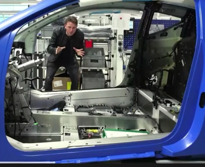

Its pretty substantial and is tied right into the aluminum chassis at the b-pillars and then has supports that run through the firewall into the engine similar in principal to a roll cage.
I dont think Lotus could pass a crash test without it, being that the car is all fiberglass and plastic above the aluminum chassis. They have been using this similar design since the S1 Elise came out.
This is excellent data and I'm very glad as that was my main reluctance in running a harness. I suspected that Lotus would've integrated a roll bar as this car was designed for track use, but didn't have any data to back that up. Thank you for confirming, Greg.

I have a better photo of the Emira hoop structure somewhere, let me find it.
