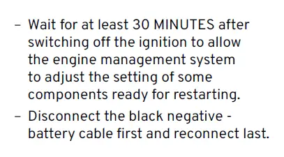

whats the correct procedure to disconnect the battery? do i just need to unplug the negative?
As well as the above the manual also says:
Switch off all electrical loads and remove the keyfob from the vehicle cabin.
That’s right, you need to let the systems settle for about 30 mins after you turn off the ignition before you disconnect the battery.
But if it’s already dead and nothing happens when you try to turn it on, you can probably skip this as the car is already unpowered.
