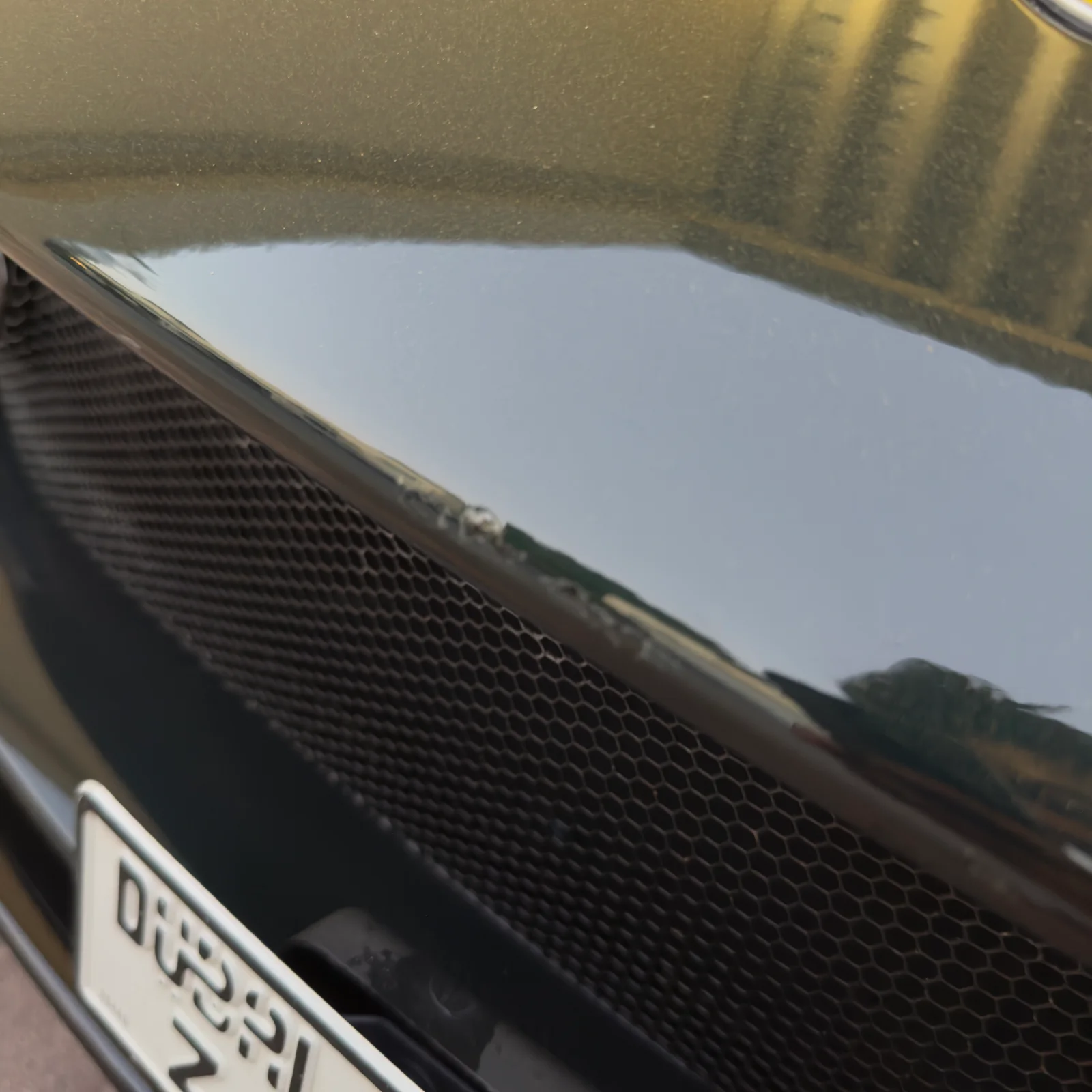

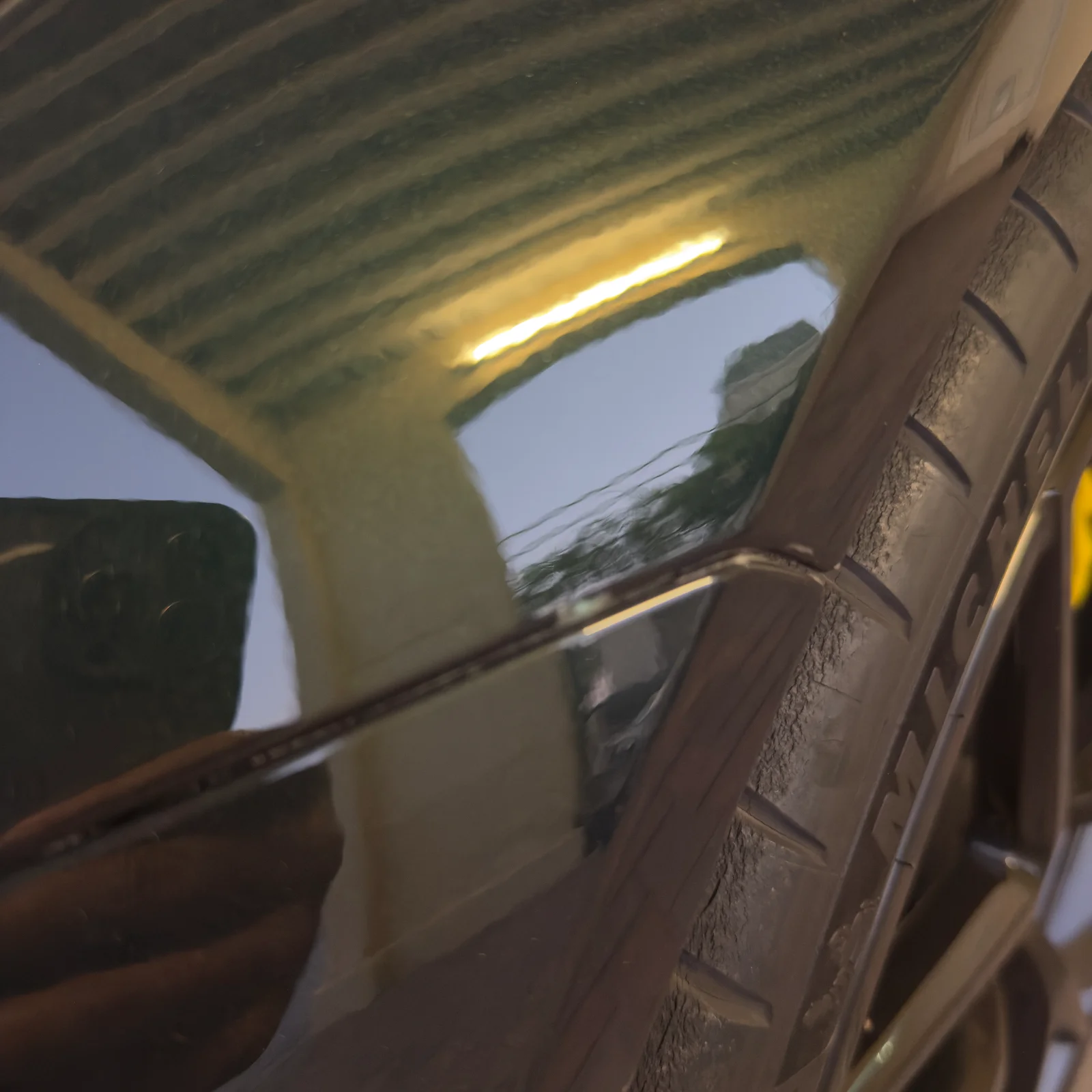

How did the damage present itself on your panels? Did just the clear pull or did it take paint as well? Which panels were effected?
I have front ppf only so the majority of the part is on the front bumper and hoof.. small areas of clear coat came off. See photos
