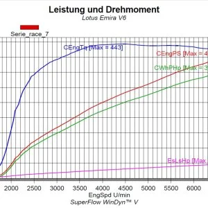

It is but it really starts pulling from 3000-3500, almost feels like turbo lag 😂
Would be interesting to see the torque 'curve' - as it should (with a supercharger) be linear - certainly by comparison to a turbo.
Hmm.
I have an Audi S5 (mapped/pulley mod/milltek'd to 500hp) - same pull pretty much all the way until it redlines - but by then you're crapping yourself so it doesn't matter! :ROFLMAO:

Looks like every twin screw type torque curve I’ve ever seen. Immediate ramp up to a flat torque curve.

Yep - wonder why people are reporting the surge then? It's not what that shows... 🤷‍♂️
Feels like VVT rather than supercharger related but doesn’t show on the graph…

The low end hole seems like it would be throttle mapping, didn’t notice it much during test drive.
The top end running harder is just speed, noise and vibration in combination with the lowered redline due to emissions making it obvious the engine can run longer. When you look at that dyno, the power curve is just chopped off, no leveling off whatsoever.
VVTI isn’t supposed to be noticeable either, it’s not like early VTEC in Hondas with an abrupt torque curve change.
